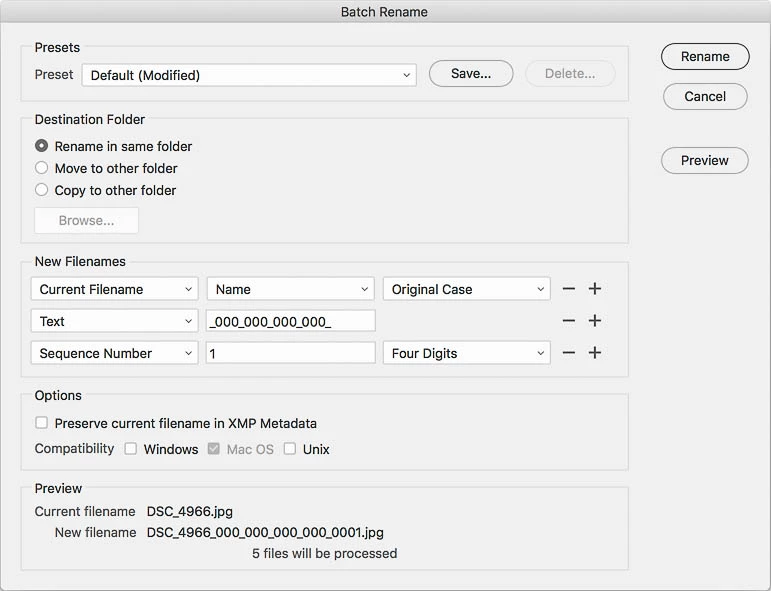

    In Bridge, you can do it like this:

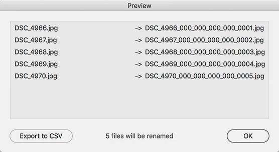

    Then, if you click Preview, you can see what you'll get:

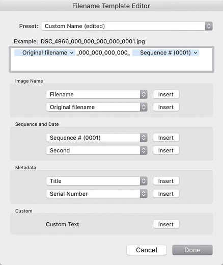

    In Lightroom, it's the same idea, but slightly different setup inserting the blue rename tokens plus custom text:

    Conrad_CCommunity ExpertCorrect answer
    December 31, 2018

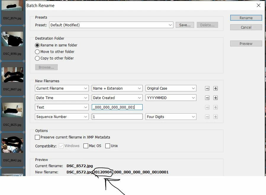

    I can't get either to do what you're showing here.
    In Bridge, you see the current filename as 8572.jpg. Yet the New filename under that, it automatically put in what I guess is the sequence number that I don't want, and I can't figure out how to get rid of it.
    In Lightroom, I saw instructions on how to pull up the Filename Template Editor which says it's "to the right of Import", but on my Win10 computer, "Export" is to the right of Import. Within Export you can rename files but it's a very basic thing, no options to do what you're saying to do.

    You need to change the first row from Name + Extension to Name (otherwise you would need to employ a more complex setup using a string substitution to remove the extension). Then all you need is a static string of text added as below:

    I'm still having problems of adding anything beyond the original number, and prior to the jpg. Even if I wipe out the original jpg and add it in as a change, I can't see how to do this.
    Take an original photo, say DSC_4966.jpg, and add this in after the number (not after the jpg)........
    _000_000_000_000_001
    to turn the whole thing into
    But each of the 600 photos has to keep their original photo number.
    I can't figure out how to do that. Oddly enough, Bridge adds in 20120904_001 to the original number (after the jpg) without me typing anything. It just automatically shows that in the preview. I get DSC_4966.jpg20120904_001. How and why is it doing this?
