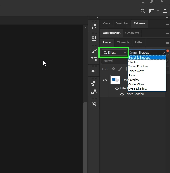

Hi
You can filter the layers by effects
MrDesignAuthor
December 20, 2019
Thank you for your answer. Unfortunately, it's not what I want. I mean to use script to judge whether a layer has a style
Leslie Moak Murray
December 20, 2019
Do you mean when a layer style has been applied but is now rasterized so it can't be separated into its own layer, and there's no way (other than eyeballing it and guessing) to tell what it was (i.e. inner shadow, inner glow, etc as in the dropdown shown in Ged's reply)?
