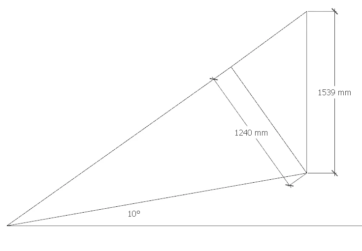

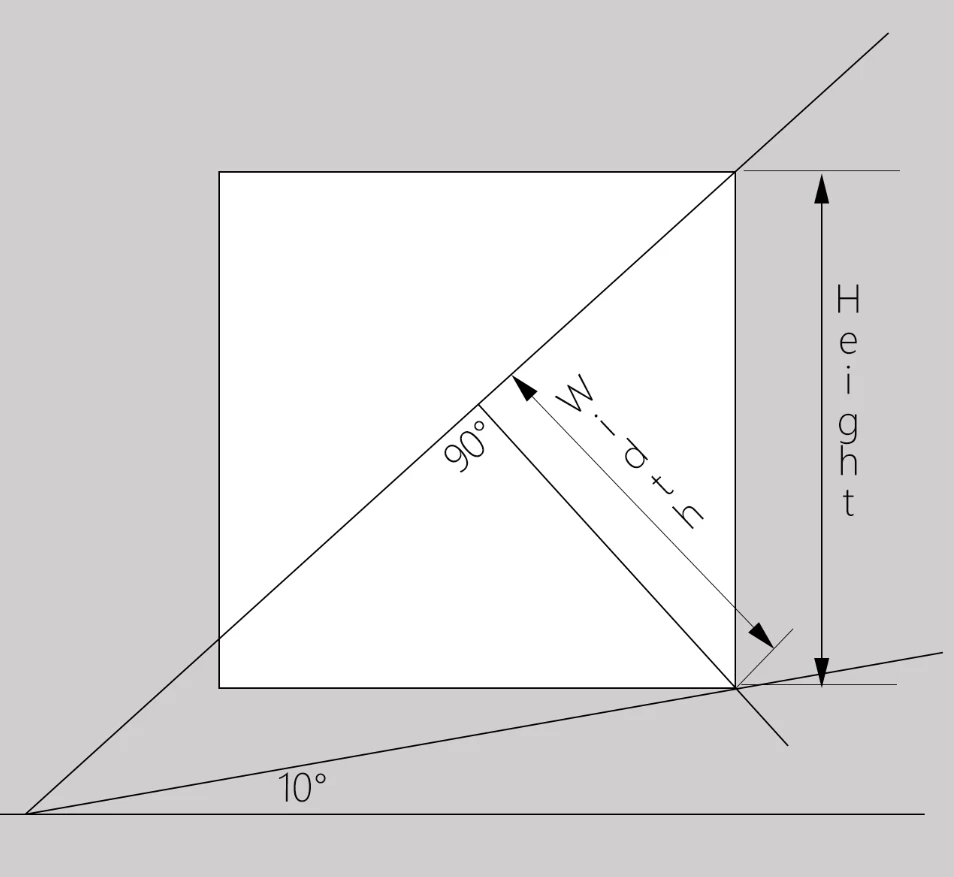

Trevor.Dennis
Apr 28, 2025 12:34 AM UTC
Do you need a method that will give you the exact change in perspective at a given angle?
Is that angle important, or does it just need to be close?
You could work it out using Photoshop as a very rough and redy CAD application, but it would be much easier and more accurate with a prober CAD app like Autocad or Sketchup.   I have probably got the diagram below wrong as the 10° should be the center line, and not the bottom of the projected shape.
If you only need a rough estimate, then Free Transform > Perspective will do it.

Trevor.Dennis
Apr 29, 2025 10:21 AM UTC
quote
"You could work it out using Photoshop as a very rough and redy CAD application"
How?
By @andw5555
If you look at my diagram above, the 10° line is accurate done using Free Transform.
If this was a projection onto a screen, then the dimension I have marked as Width would be the width of the projected image on our imaginary screen.
However the height would be extended because of the angle it hits the screen.  We started with a square box because it suits the calculation.  So the aspect ratio between width and height can be applied to your situation.   Is there enough information there to do the Trig?  I don't think we have, because we don't know the angle.  That 10° doesn't help you because the angles of the right angle triangle depend on the height (hypotenuse).
It is also not clear exactly what you are trying to work out.  You'd need to provide diagrams/screen shots and a more detailed description.
If you were able to draw your diagram with a CAD app, then you could accurately measure and workout the relationship between width and height, but other than that 10°, the rest is arbitrary.  It wouldn't be linear either. That aspect ratio would be different for a wider angled projection.  It's like I said before...  You'd need to split the angles between the top and bottom line and use the lens axis of this imaginary projector.  The aspect ratio would then remain linear regardless.
I'm old and out of my depth, so you need to provide more information, and someone like our Dave, who is cleverer than most of us, might offer a solution.
