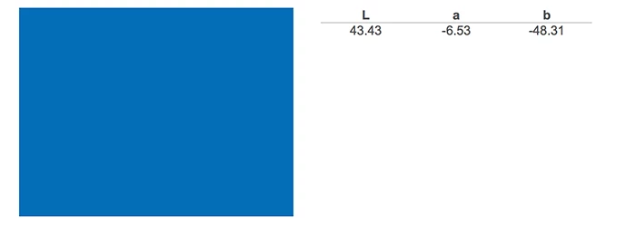

Correct answer Norman Sanders
I know of no more accurate no more universal graphic arts color designation than Lab  value,  which is device independent. The Pantone value 300U is Lab:  L 43.43   a -6.53    b -48.31 (indicating a greenish/blue). Also consider that any printed version of this value will vary depending upon the paper & inks used and the illuminant under which the color is viewed.
Lab, RGB, CYMK and HLC Values for 300 U from the Pantone U colour range
Note that the Pantone Color Picker value are different by about a point and provides rounded numbers. .

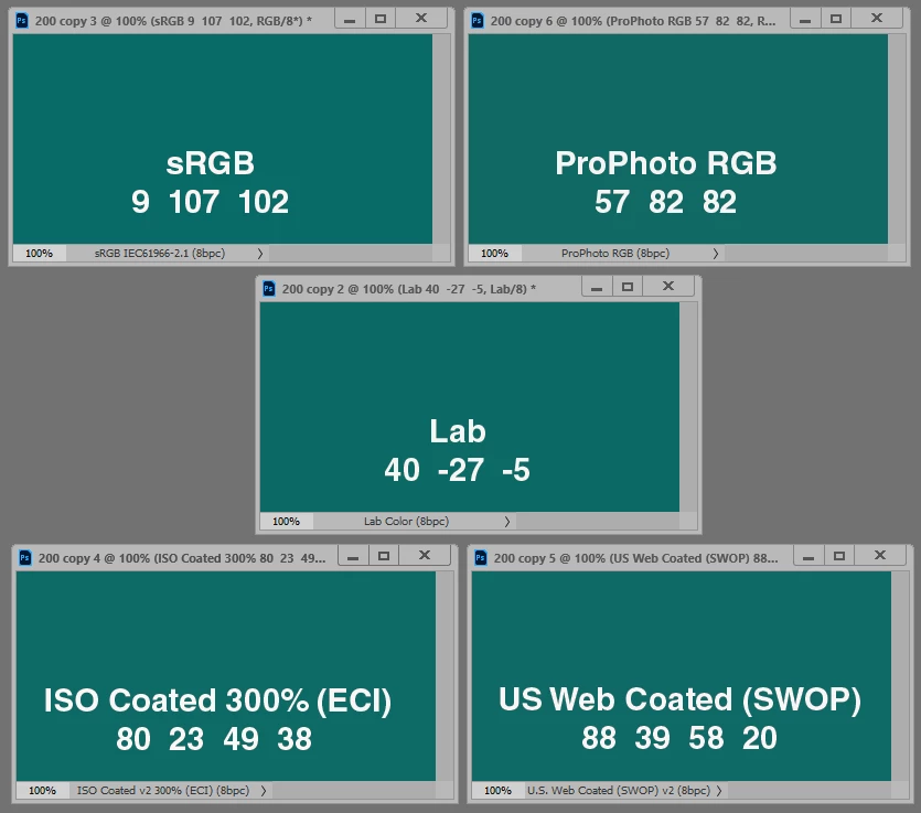

D Fosse
August 28, 2021
Photoshop doesn't "interpret" anything. There is a fixed reference throughout all of this, and that's Lab.
All color management is based on Lab. That's why it's used as Profile Connection Space (PCS) in profile conversions. Photoshop conforms to standard color management specification and procedure.
NCS codes should also refer to Lab. So again, you have a bedrock, a center of the color universe, and all other numbers are satellites to that. There is no particular magic to any of this. You just need to know the color space, and then the color is absolutely defined and identified.
Open this image in Photoshop (make sure the sRGB profile is embedded), and try the color picker. They will all read as Lab 40  -27  -5.
There is only one precaution that you need to take, and that is to stay within the gamut of the color space. A given color can't be reproduced in a color space if it's outside the gamut boundary (the clipping point for any color channel). But that's a universal concern unrelated to Photoshop.

Norman SandersCorrect answer
August 9, 2019

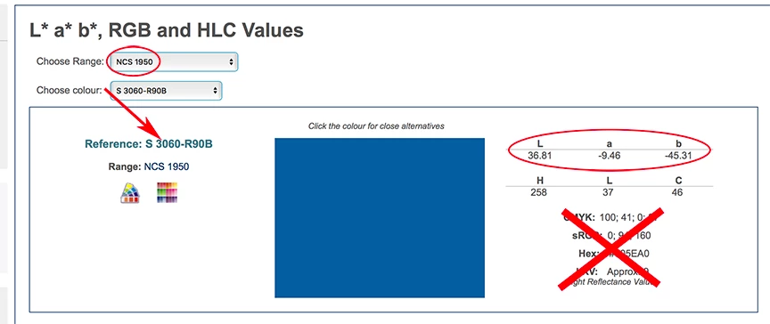

Norman Sanders
August 9, 2019
Using the same reference I cited above, the NCS value specified fits easily within the Lab parameters with the device independent Lab values shown above. Once the Lab value is converted to your chosen Color Space (Adobe RGB, sRGB or other Profile) in Photoshop, its correct values in the chosen Profile will be displayed in the Color Picker. The color values may vary as you change Profiles but the Lab Value for the color and, by extension, the NCS color will be unchanged as long as the color fits within the color gamut of the particular Color Space..
EDIT: Short version. In this instance, Lab is the gateway from NCS to Photoshop's Color Spaces. Since the Color Picker Lab fields accept only whole numbers a compromise is necessary.
