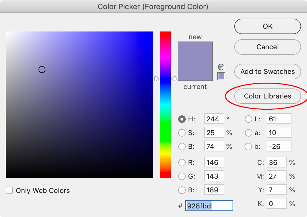

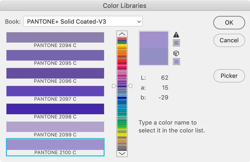

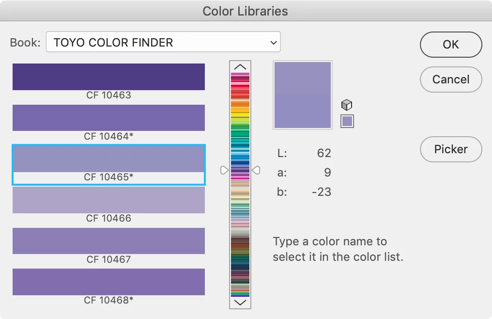

Also, if you have an NCS Lab value you can find the closest color in other solid ink systems via the Color Picker’s Libraries. For example if the solid color is Lab 61|10|-26 I can get Pantone’s closest coated solid color (2100C) or Toyo’s closest coated solid color (CF10465):

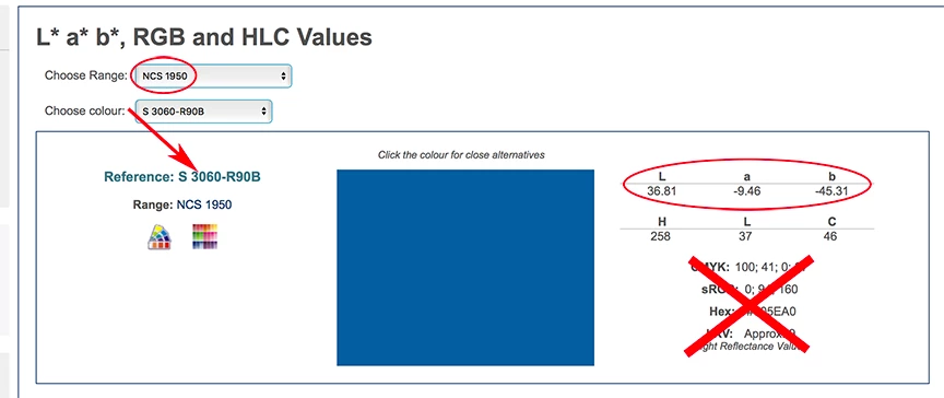

Using the same reference I cited above, the NCS value specified fits easily within the Lab parameters with the device independent Lab values shown above. Once the Lab value is converted to your chosen Color Space (Adobe RGB, sRGB or other Profile) in Photoshop, its correct values in the chosen Profile will be displayed in the Color Picker. The color values may vary as you change Profiles but the Lab Value for the color and, by extension, the NCS color will be unchanged as long as the color fits within the color gamut of the particular Color Space..
EDIT: Short version. In this instance, Lab is the gateway from NCS to Photoshop's Color Spaces. Since the Color Picker Lab fields accept only whole numbers a compromise is necessary.
