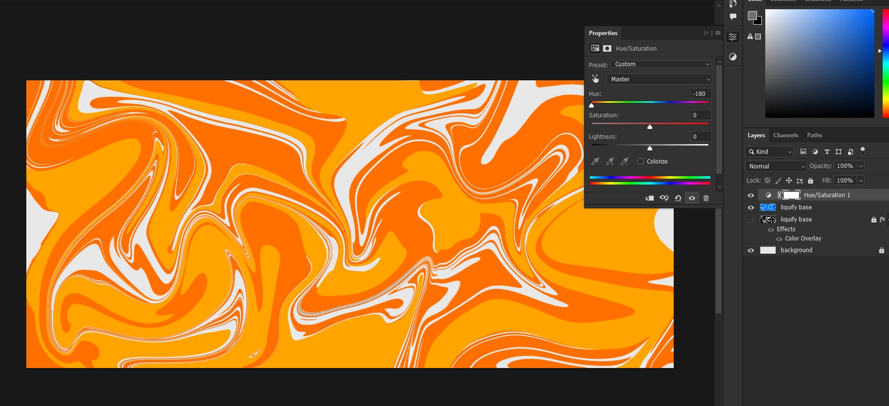

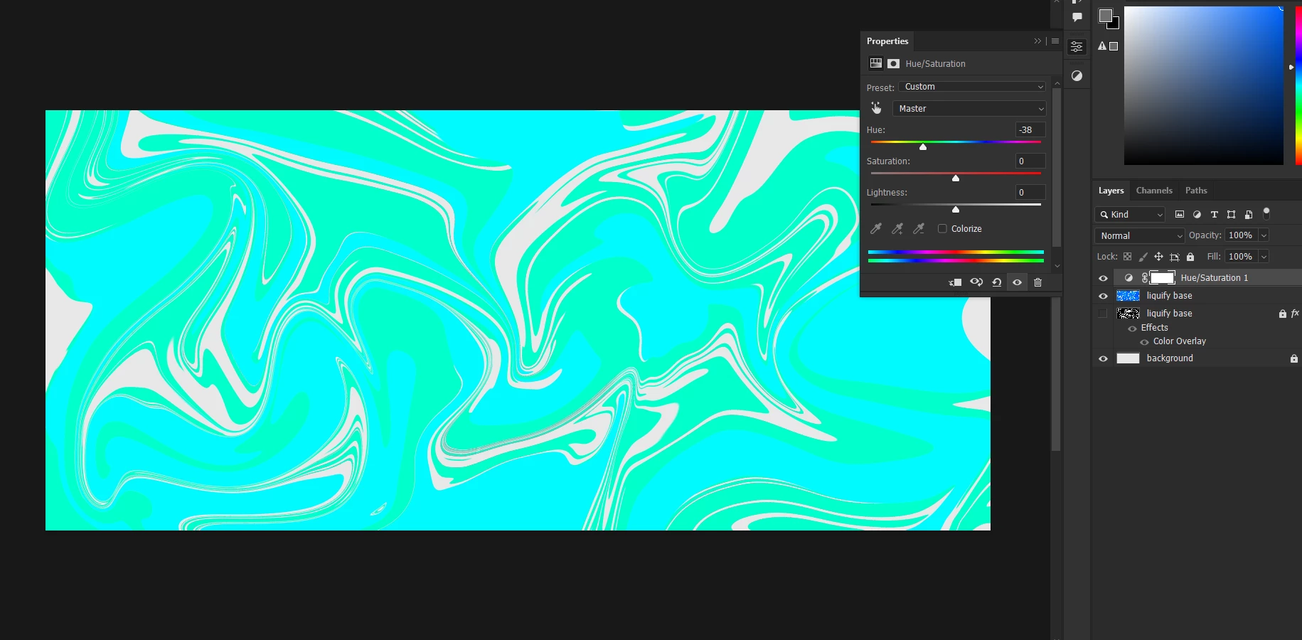

I am trying to change the two shades of blue in this design to shades of red, green, pink, ect. The issues is changing the hue with an adjustment layer gives terrible results for anything but the exact opposite of the blue.
Here is the exact opposite, it looks pretty good.
Here is green...
How do I go about getting different colors? Is there a better way to do this?

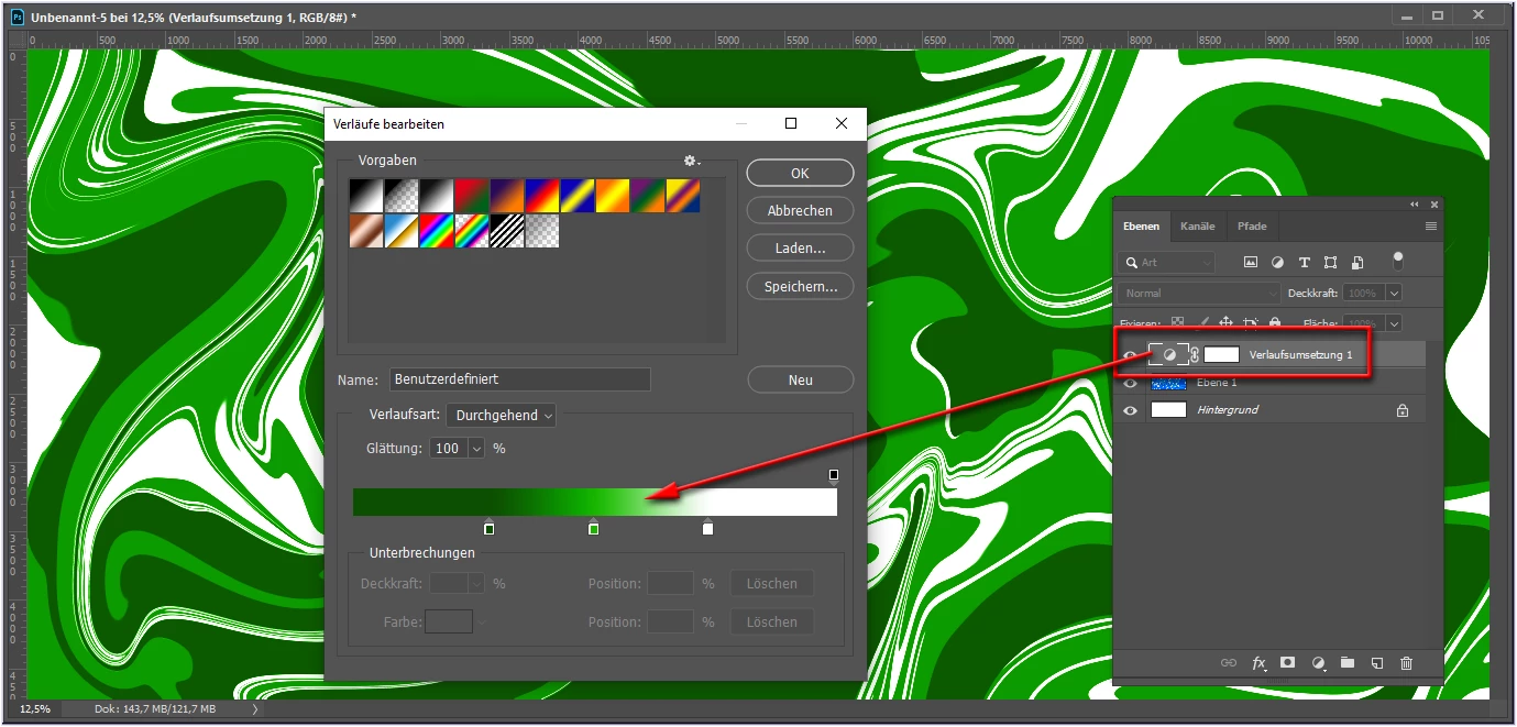

Hi @Servs
… For such graphic images, the best way to achieve the desired colour changes is to use a gradient map adjustment layer.
Here is a screenshot with a possible result (sorry for my German UI):
By @pixxxelschubser

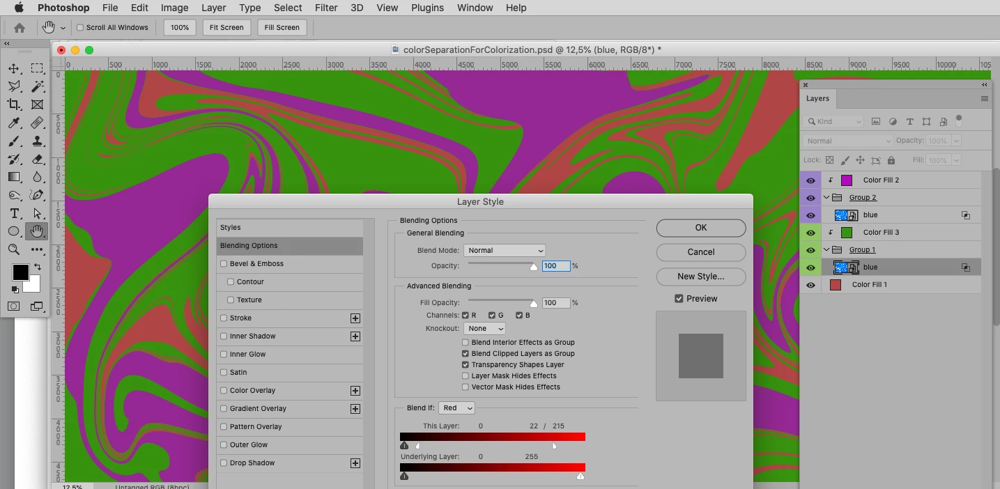

Yet another option would be creating Layer Masks or using Blend if-settings and Clipping Masks for Solid Color Layers.
By @c.pfaffenbichler

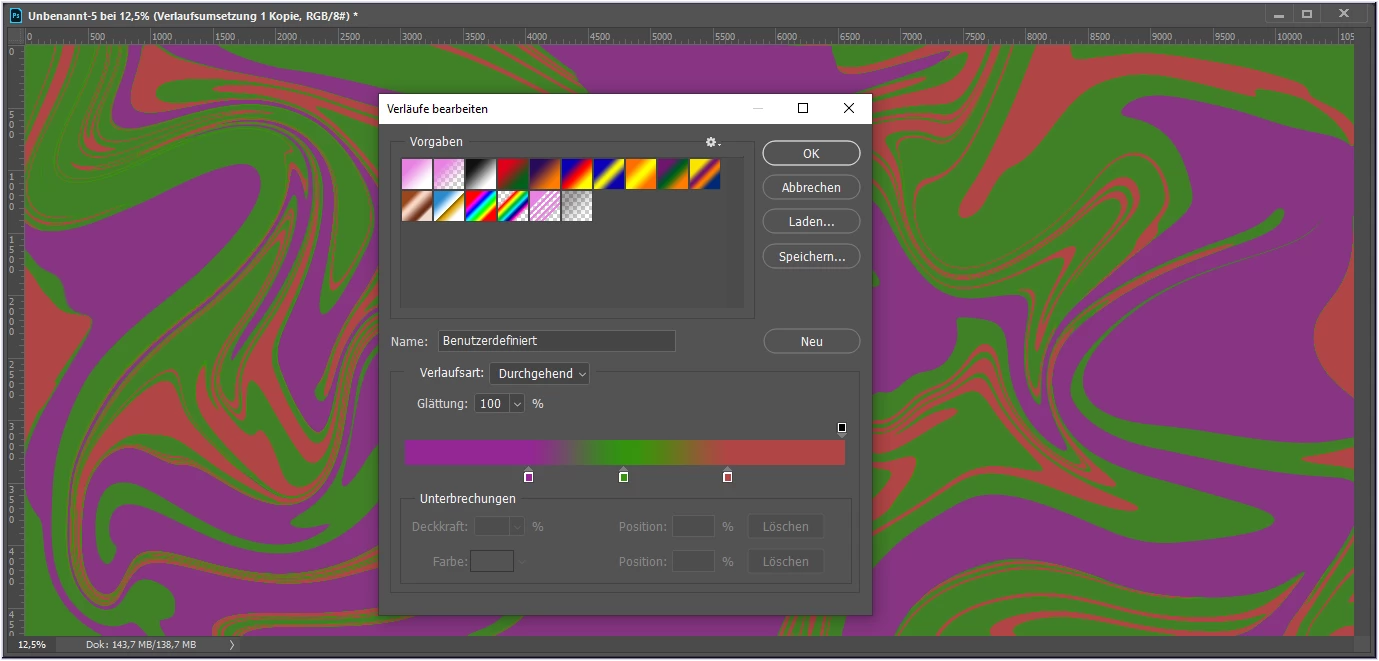

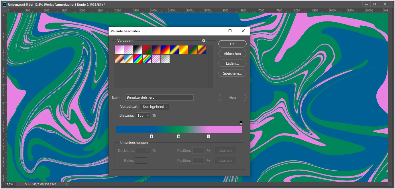

@Servs
You have already become acquainted with some of the variants. Among them are settings suitable for beginners - but also advanced techniques for experienced Photoshop users. Some variants allow more influence than others. Basically, you can achieve your goal with all variants. It only depends on your level of knowledge and what you want to change and how.
Here are the variants of @didiermazier and @c.pfaffenbichler, reconstructed with gradient map adjustment layer and the colours they used.
Have fun
@Servs
Have fun

Hi @Servs
@Mylenium has already shown you the best way.
Mylenium
January 15, 2023
Use a gradient map adjustment layer and tweak the gradient.
