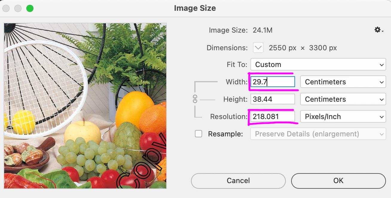

Brad @ Roaring Mouse
December 8, 2022
There are a few ways to determine the PPI. One of the simpler ones, since you're in Photoshop already, is to look at Image > Image Size. On your cropped image, type in the dimensions you want and the PPI will reflect it's new essential resolution: e.g. in my example I'm using the width of a vertical A3 (29.7) to see what my original 300ppi image would be at that width = 218-ish.
 In your case, type in 42 cm for width (landscape)

Mylenium

TheDigitalDog
December 8, 2022
In Photoshop, several ways to check what's currently set. Try Image Size for one, or you can set up this info to show in your Info Palette if you select the option.
Does it matter; not really, no. This is simply a metadata tag. The number of pixels is key! 1000x1000 pixels at 300 dpi, 1000 dpi or 72 dpi is the same. It's 1000x1000 pixels.
