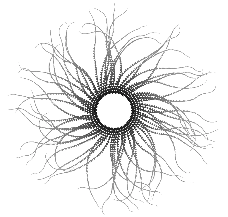

I have an image, (its looks challenging, isn't it?), I just tried to remove the background color (white) with background eraser tool but the problem is as the image contains black to gray so sometimes some arms also get erased. So is there any another process to do this? I have 15 images like this to process.https://lh3.googleusercontent.com/-vy8-Au1lplM/TmMISEP7OTI/AAAAAAAAAB8/kAlyBL8z5uM/I/ciliasun14.png

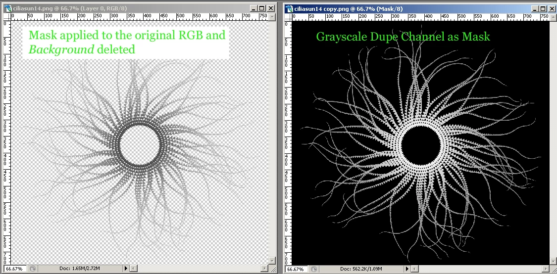

    Another way to delete the white would be to use Image Mode>Grayscale, and then just Duplicate the Channel, and Save it as Mask.
    Open your original again, and drag that Mask Channel to the Image, then Delete.
    This is what you get:
    To remove the background from the Background Layer, do not forget to Dbl-click on it, to convert to a "regular" Layer.

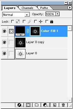

    Hey! let me explain what is happening. Then give me the idea to proceed.
    1. I duplicated the layer and inversed that. (This made the white background black and other blacks also changed into white).
    2. I selected the whole layer (obviously the duplicated one.) and then I went to Layer > New Fill Layer > Solid Color...
    Named that layer something and proceeded with OK. then I choose black color and proceeded with OK.
    3.  By pressing Alt I click on the Layer mask thumbnail, (now the color  will is change to white). Now the same thing as duplicated layer is  pasted here.
    4. Deselected. Click on the duplicated layer.
    5. Again make a fill layer below the first fill layer with white color.
    Finally it happens that the photo changes to as like the first image I used.

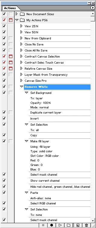

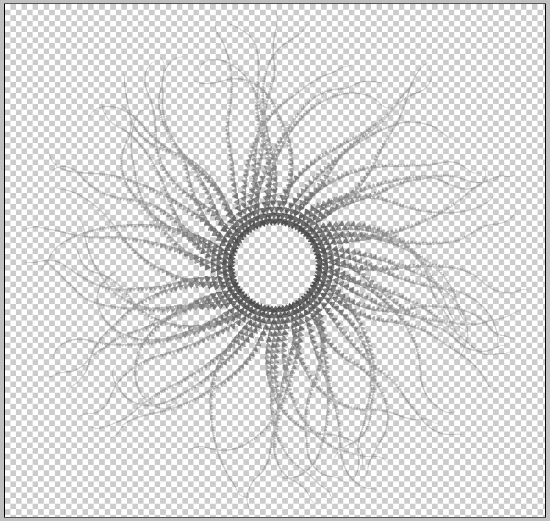

    First the manual way:
    1. duplicate the background layer
    2. invert the duplicated layer (Ctrl+I)
    3. Select>All (ctrl+a)
    4. Edit>Copy (ctrl+c)
    5. add a new fill layer color black
    6. Alt click on the color fill's layer mask in the layers panel
    7. Edit>Paste (ctrl+v)
    8. Select>Deselect (ctrl+d)
    9. click on the layer below in the layers panel to make the rgb channels active.
    You can check the extraction by putting a color fill layer white below the black color fill layer.
    If your satisfied with how it looks you can merge the black color fill layer with a new blank layer below.
    You could make this into an action as below or download this free plugin for one click remove white.
    http://www.cybia.co.uk/theworks.html
    after extraction
    with white fill layer below
