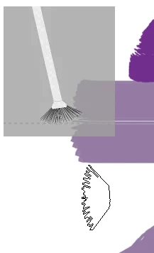

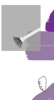

    Ok - I think it's working the way it works for me... let's see if I understand what you are saying.
    Moving my brush off the tablet shows me the brush cursor in different angles and directions - like this:
    When I put my pen to the tablet, the brush is working correctly, but the cursor becomes fixed and doesn't change. The cursor remained the same for this entire stroke:
    Yes? That is how it's works - feature request for the engineers to make it work the way you want it to...
