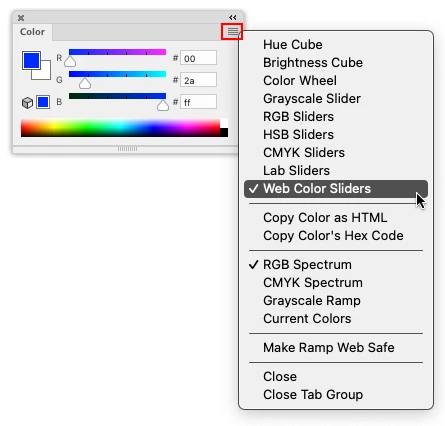

I don‘t think this will address everything, but it might help a little, at least…
Yes, it’s annoying that the only place Photoshop will show, and allow pasting of, the RGB hex color values as a single number is in the Color Picker dialog box. And I don’t think there’s a way to highlight a color in the Swatches panel that matches the currently sampled color. (I like that idea, though.) The problem might be that the Swatches panel is in the category of “presets” panels (swatches are basically “color presets”), so similar to other panels that contain presets (Gradients, Shapes…), presets panels are only about applying, not reporting on the current selection.
That said, there are other ways to get at the hex value, see the demo below. This is what happens in the demo:
1. Color panel: (Jeff already mentioned this) Set to Web Color Sliders. Sure, that gives you a hex display, but the three values are still separate, unfortunately, so they can’t be copied as one value.
2. Info panel: Set a color readout to Web Color. This is just another way to get a color value readout in different formats, but unfortunately it can’t be copied. And, it’s still three separate values. But you still might find it useful.
3. Sample a color, then click the Color panel menu and choose Copy Color’s Hex Code. Now you have the RGB color values all together, and can paste them anywhere that accepts plain text. I showed pasting it on the document in a text layer.
4. Alternate to #3: When sampling a color, right-click to open the context menu, and choose Copy Color’s Hex Code. I pasted this value on a text layer too, so now two different RGB hex values are visible as text.
December 7, 2024
Thank you so very much! It's not ideal, but #3 & #4 will work.  I really appreaciate the screen recording. That was extremely helpful!!!
Jeff Arola
December 5, 2024
You can set the color panel to Web Color Sliders
December 7, 2024
Thank you for responding. I tried this previously, but I still don't see the Hex code all in one box (ie so I can copy and paste it when needed). How do I get it to show the Hex code all in one box?
