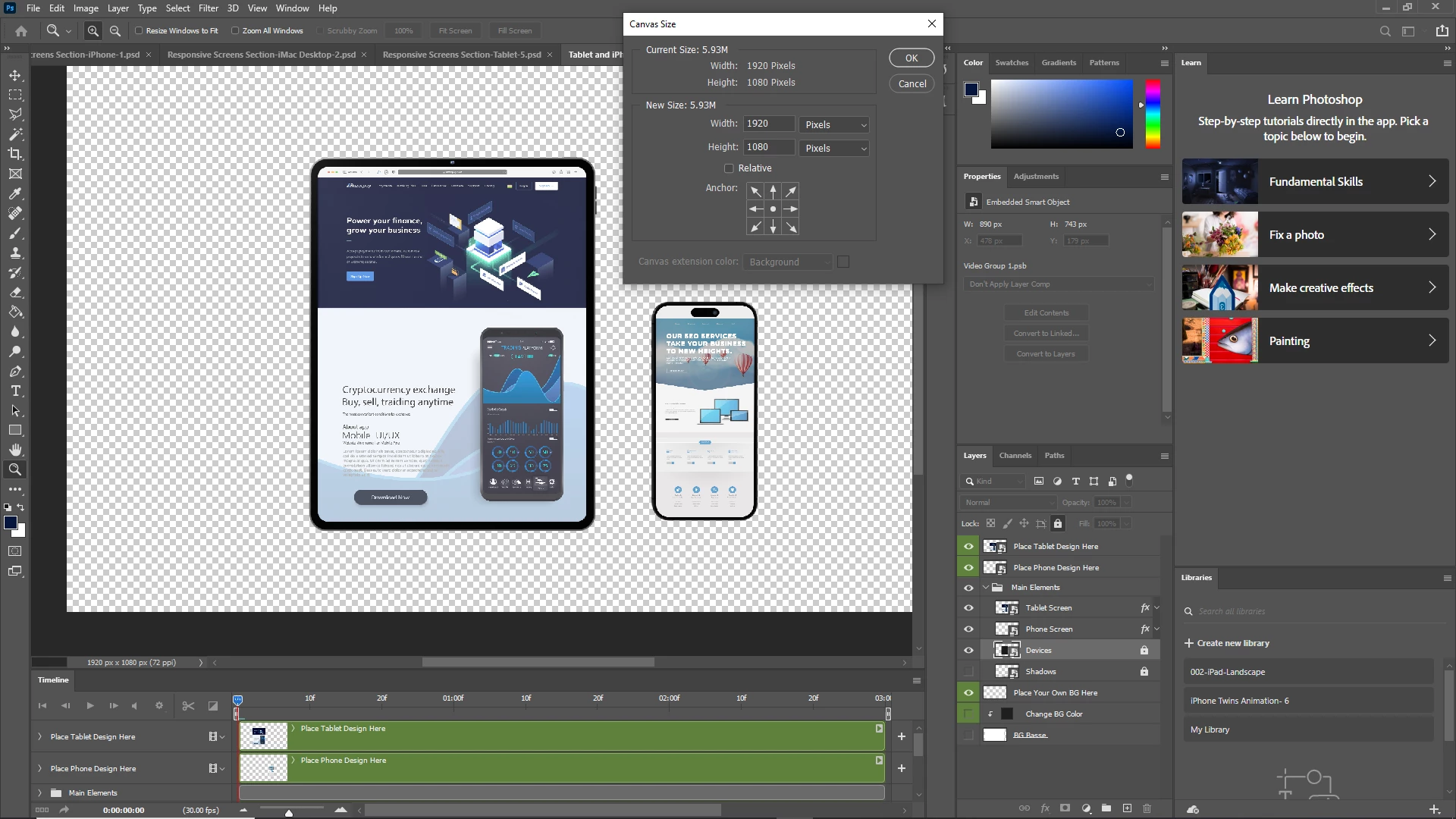

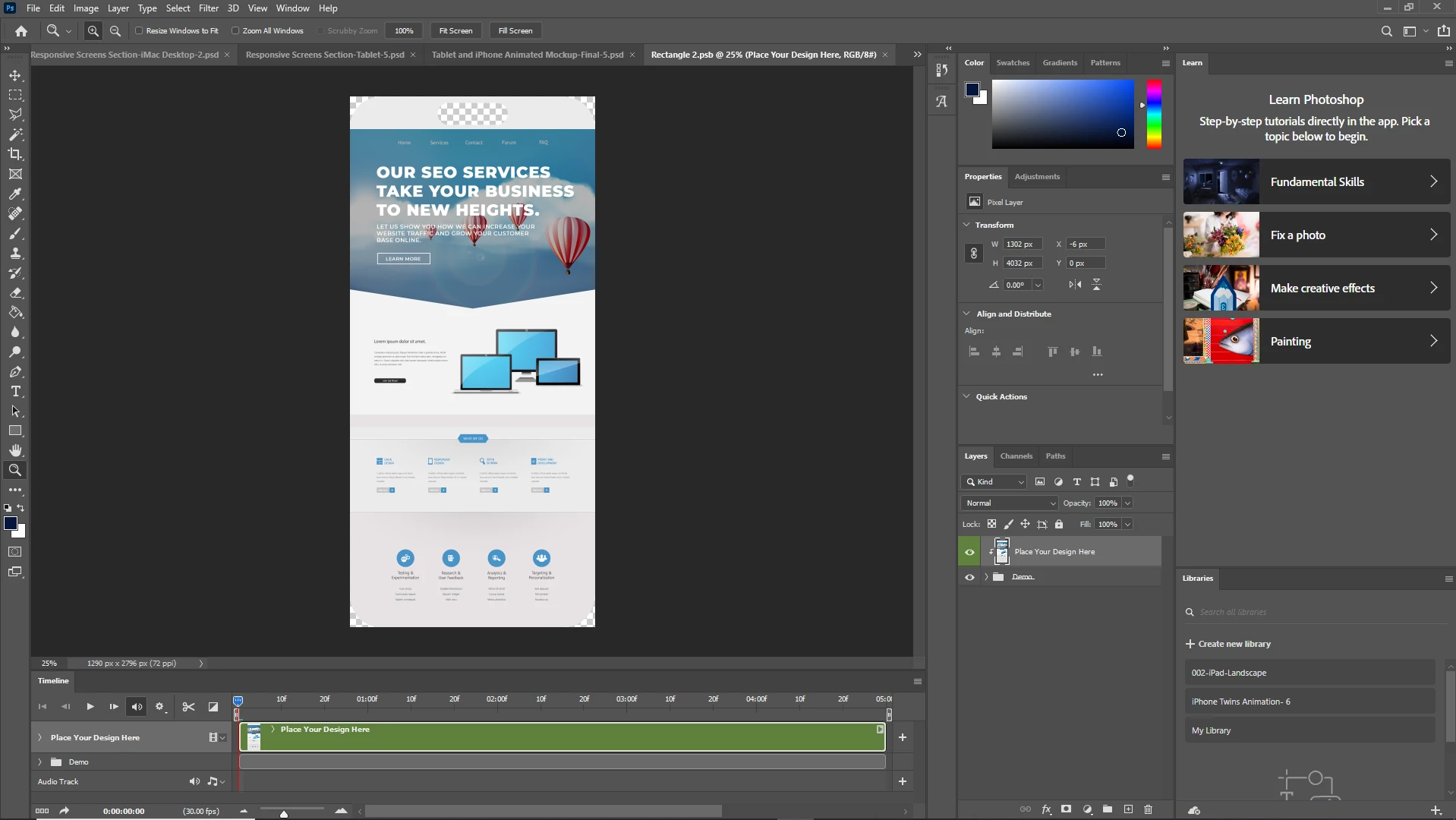

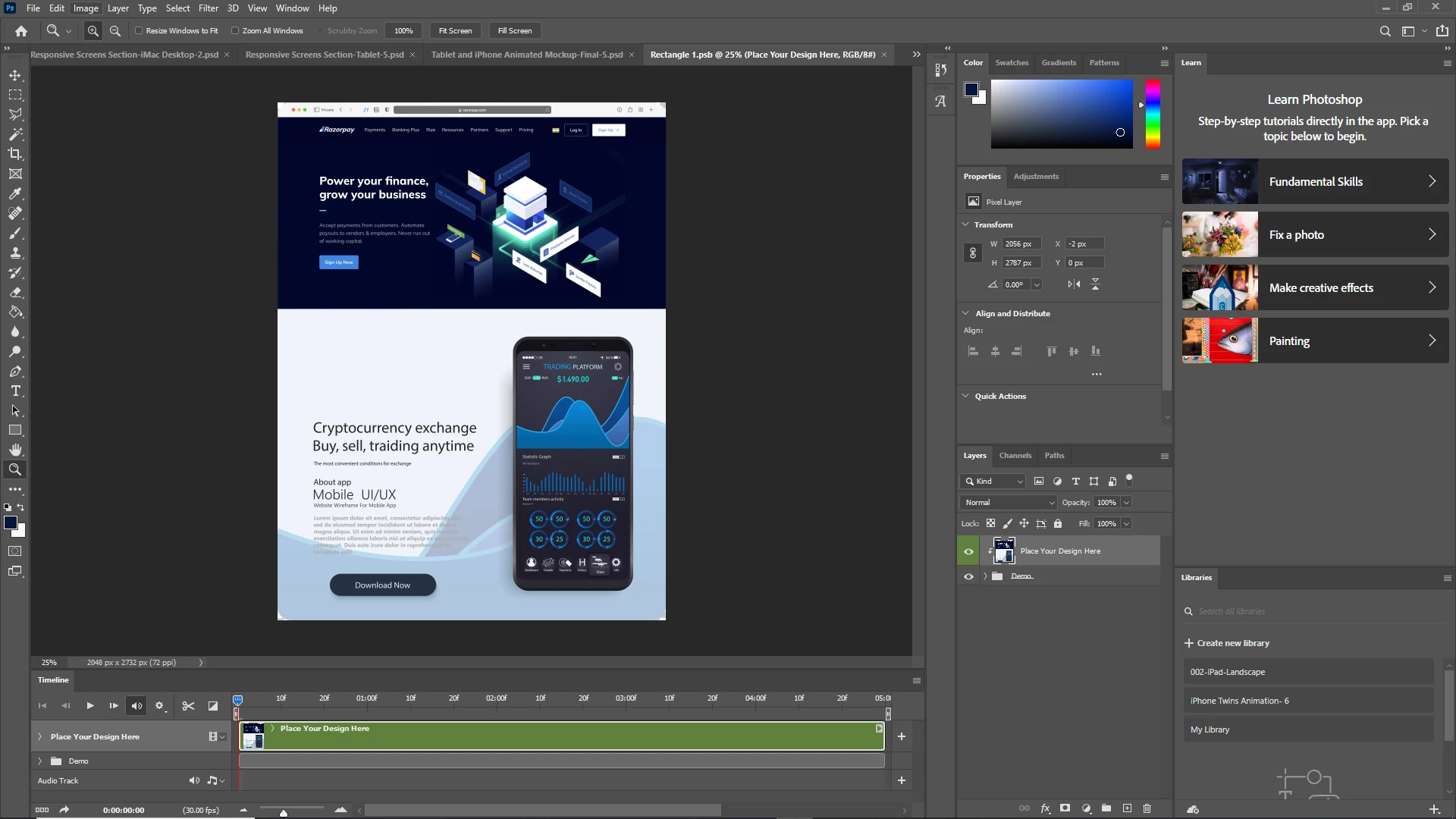

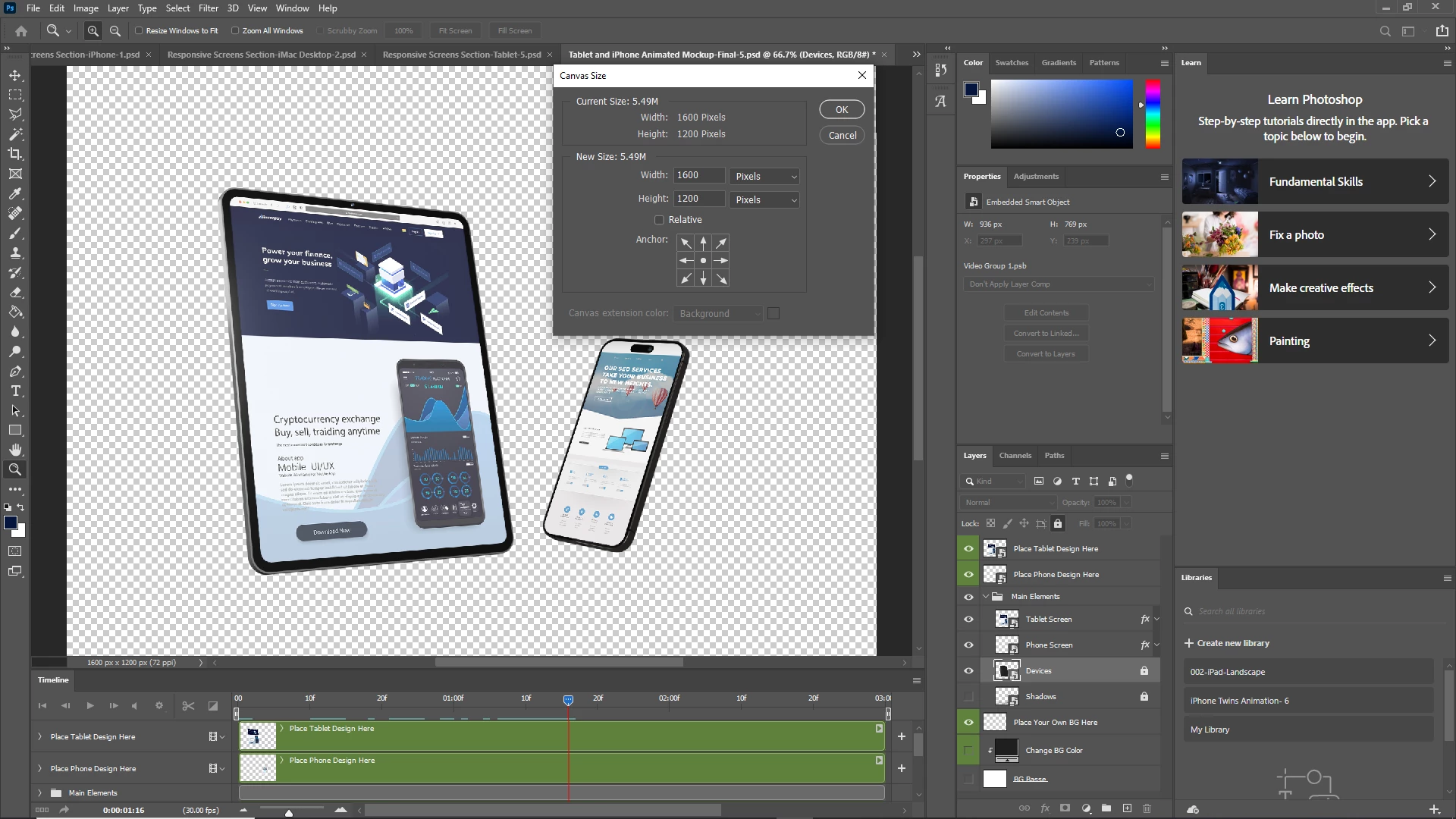

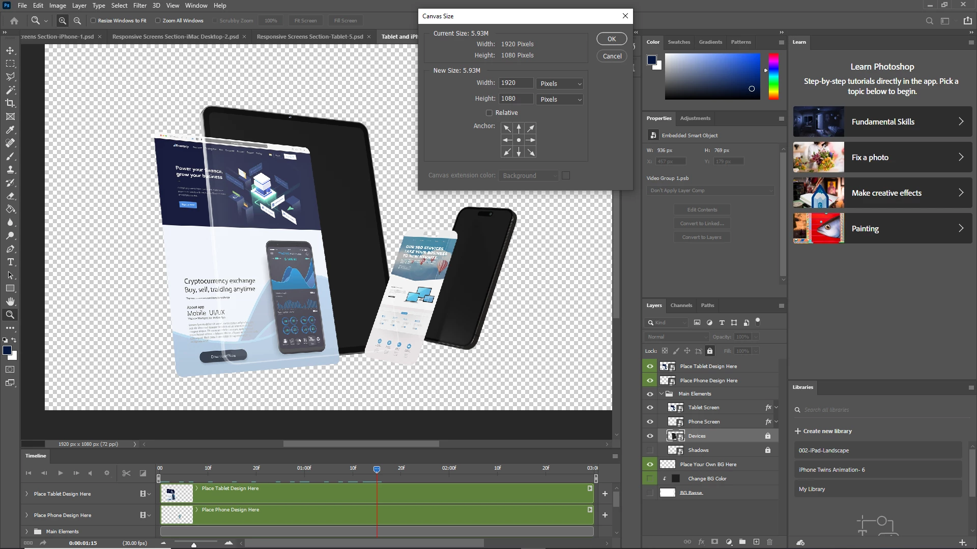

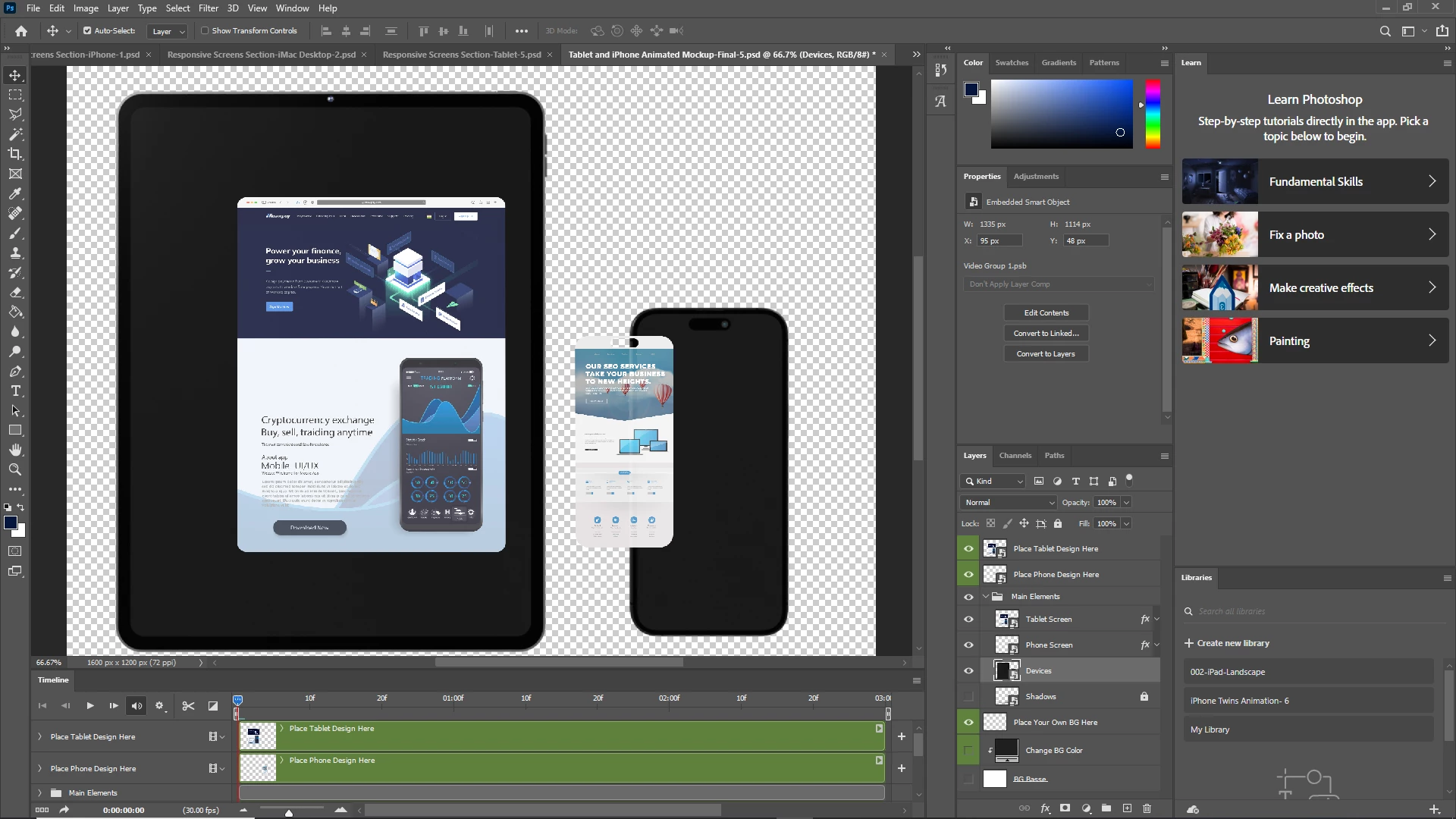

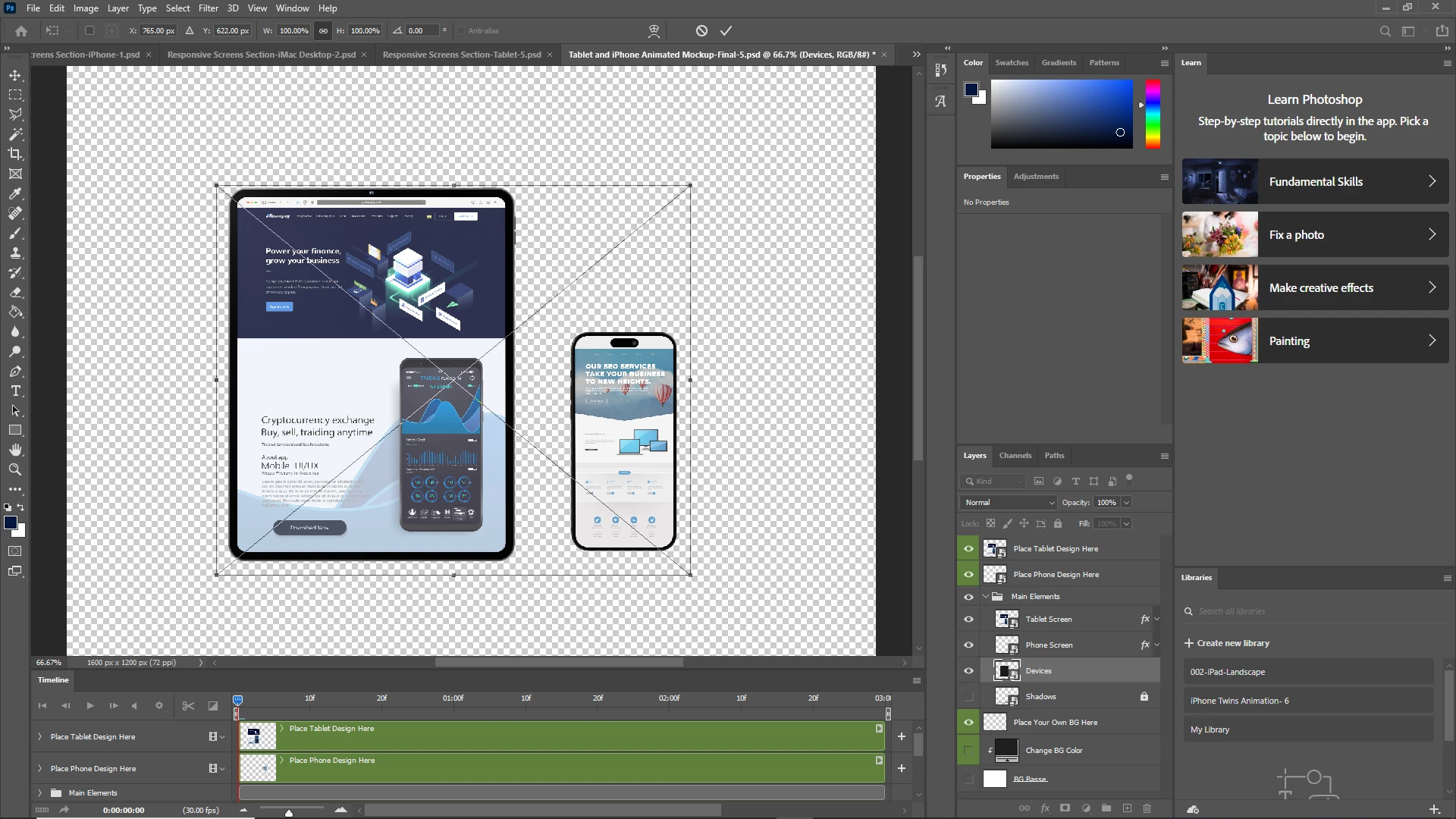

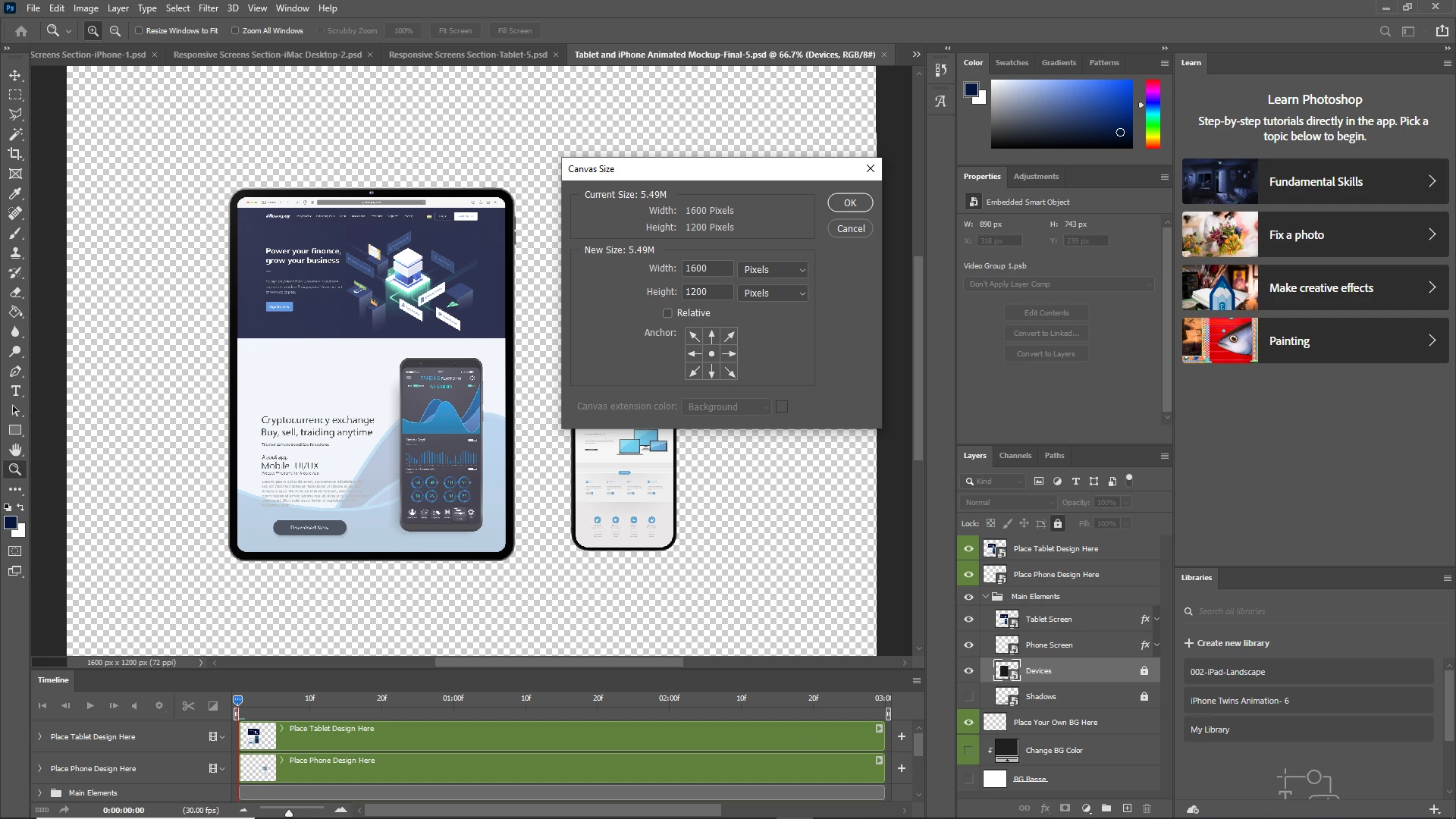

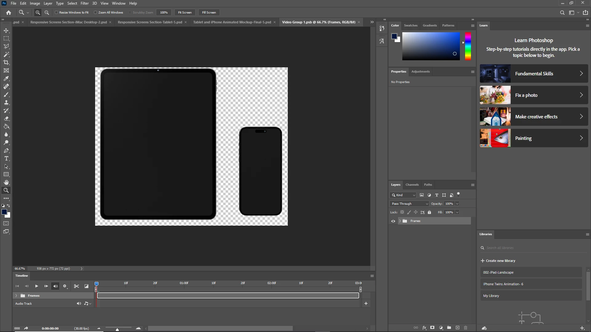

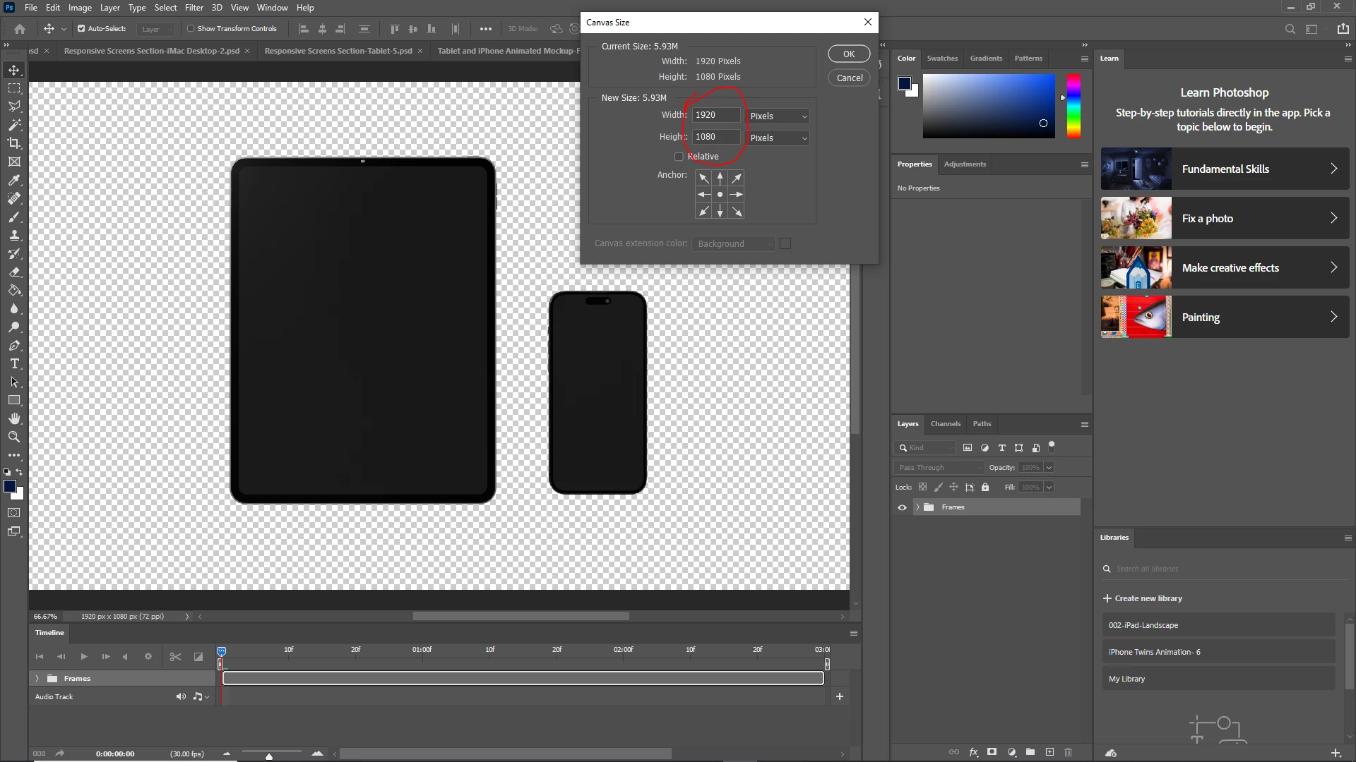

How do I increase the canvas size and the smart object size of an animated iPhone mockup?
Hello. I downloaded this animated mockup PSD of an Apple tablet and iPhone shown here. Both the tablet and the iPhone are animated so that they both rotate towards each other and then back to facing front again.  The PSD canvas size is 1600h x 1200v and I need to increase the canzas size to 1920h x 1080v AND scale up the tablet and iPhone so that they are both larger. They are both smart objects and I don't really have any experience using smart objects in Photoshop. The problem is, when I increase the canvas size, my custom webpage that I created and pasted on both the tablet and the iPhone screen is off kilter and appears halfway off of each device's screen! ALSO, if I scale each device to 150%, my custom webpage on each device's screen is also off kilter! Can someone please tell me how to increase the canvas size AND how to increase the size of the tablet and iPhone AND how to have my custom webpage that displays on the screen of each device also be the correct size so that the animation looks correct when each device rotates?

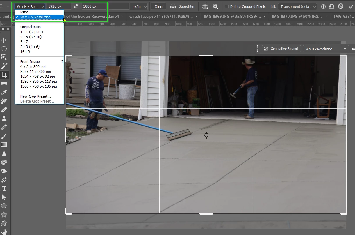

I actually prefer the Crop tool to set Canvas size.  If you want toadd canvas manually, hit Crop and simply drag a corner handle.  Hold down Alt and drag to expand from the center.
What would make the crop tool especially useful in your case is that it has presets for the aspect ratio, so you could set it to 16:9 or you could use the W(width) x H(Height) x Resolution option.  That gives you a window like below.

Sorry. Here are the screenshots of my PSD embedded. Sorry for so many screenshots, but I want to show you everything so I can hopefully get a solution to my problem.

Think of a SO as being a layer or layers inside of a protective envelope. You can write on the envelope (or add filters to the SO) without disturbing the contents. Edits on a SO are non-destructive. For instance, scaling (what you want to do) is non-destructive on an SO. Working directly on the image is destructive.
Are you saying that your can't use Edit > Free Transform on the SOs? You should be able to.
To edit the SO directly:
  • Double-click the icon in the Layers panel to open the SO
  • It will open as a .psb
  • Make edits, such as Transform
  • Save and close the .psb to return to your Photoshop document (or template)
Important: work on a copy of the original file.
