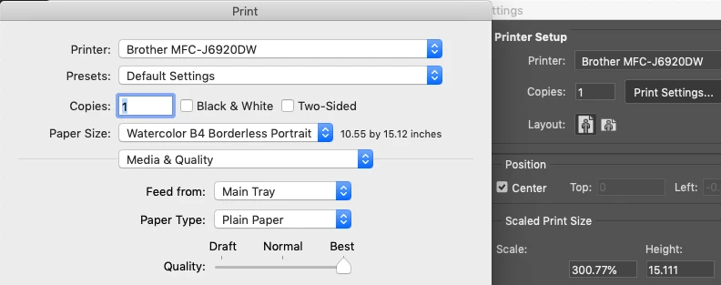

I give up! I can't figure out how to print a simple  5x7 image. I have a new printer and I'm trying to print a 5"x7" print on it but every time I go to the print screen dialog the paper size is set to 8.486" x 10.986", so I see my smaller 5"x7" print in the preview. But I want to print it on 5"x"7" paper. I have 5"x"7" paper and some 13"x"19" paper for later. So how do I set the paper size to be 5"x"7"?  The files's resolution is 300ppi, by the way. This seems like it should be simple but I can't find out how to do it.
I'm using Photoshop 2019 CC.
Also, I welcome any other printing tips anyone might have.

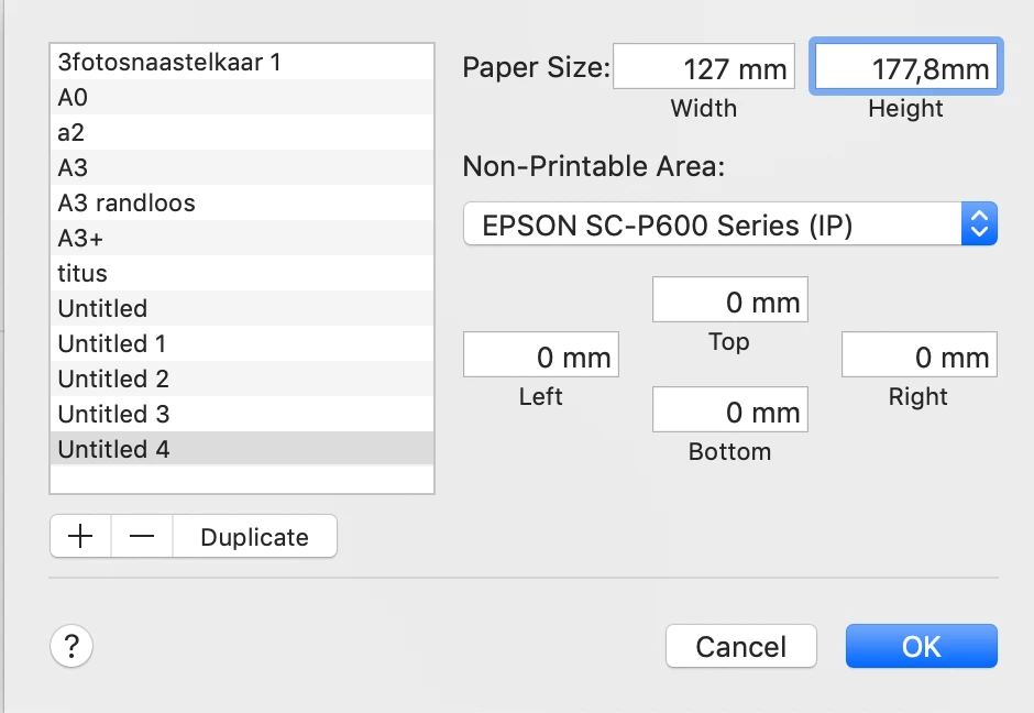

    The way I would do it:
    1. Go to the photoshop print menu.
    2. Go to the print settings and give in the size of the paper (it is with paper size, where to find depends on the kind of printer you use)
      If 5x7 inch is not a standard paper size you can go to custom at the bottom and give in the correct sizes by hand.
    3. When the right paper is set you can read it above the preview of the image *5x7" = 12,7 by 17,78 cm
    Custom set the sizes.

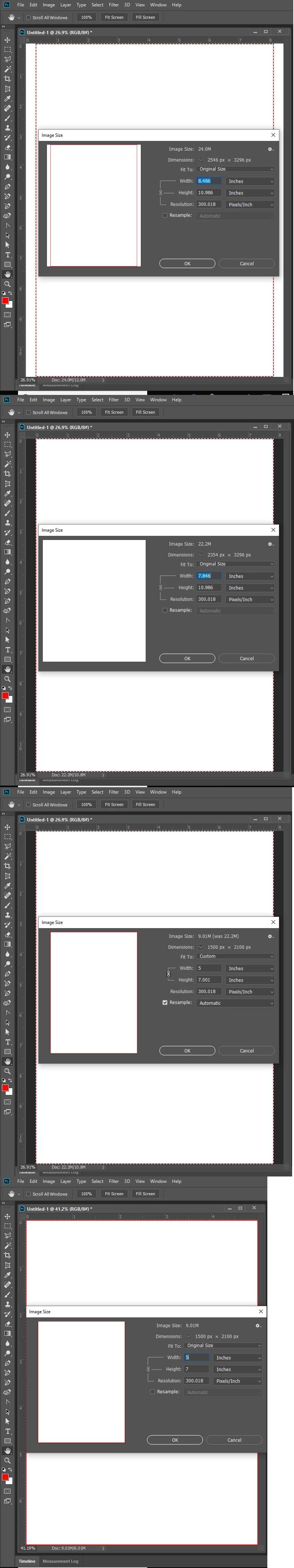

    Your  8.486" x 10.986" image has a wider aspect ratio then 5:7.  So you woul]d need to Crop your  images to a 5:7 apect ratio then resize the crop to print a 5" x 7" image print.
