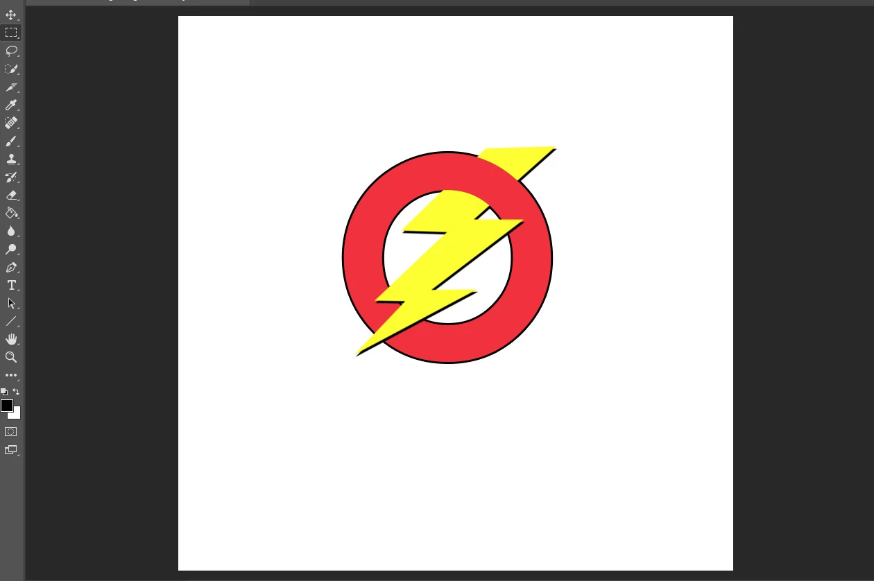

Jun 1, 2018 10:01 PM UTC
Awesome. That works now, but if the letter has a 3 pixel black stroke, it erases that also along with the bolt in the upper part of the letter O. How can I solve that problem? Here is a pic: [update] Nevermind, I just expanded the selection by going to Select > Modify > Expand and expanding it by 3 pixels. Now it's fine, although it still leaves a hairline of a white space between the drop shadow of the bolt and the black stroke. In any case, thanks for your help.

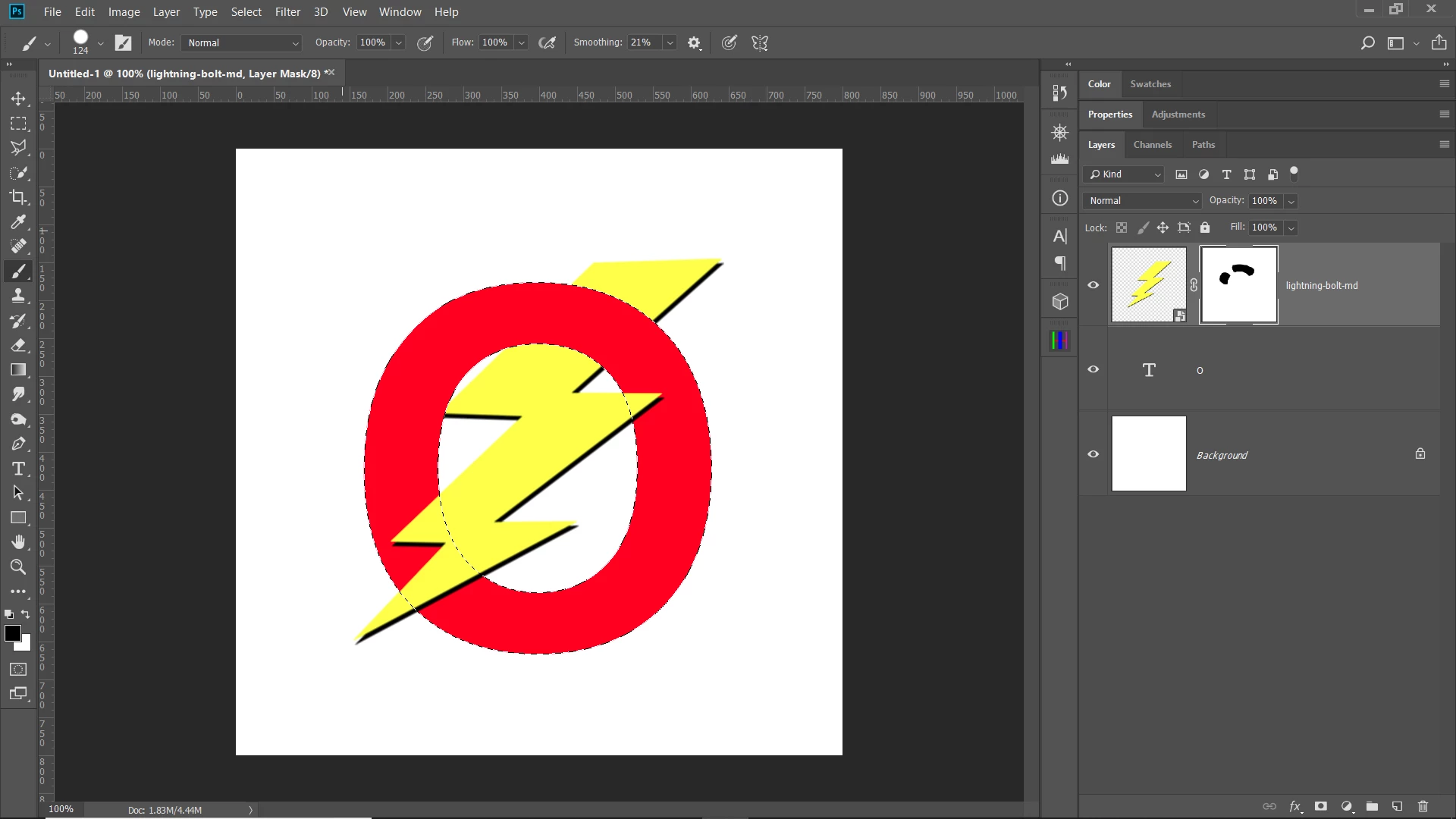

May 31, 2018 2:14 PM UTC
Put your bolt above your letter "O". Add a layer mask to the bolt layer. Ctrl/cmd-click on the "O" layer thumbnail to make a selection.
Using a black brush, paint on the bolt layer mask to hide the areas you want hidden.
Jun 1, 2018 3:11 AM UTC
I'm really confused. I put the bolt above the letter, but how do I create the layer mask? under the Layer > Layer Masks >  Hide All and Reveal All are the only options available and the other options are grayed out.  I selected reveal all, but I'm stuck on the step where you say to ctrl click on the letter layer to make a selection? I tried that, but nothing happens. No selection lines show up around the letter. What am I doing wrong? Thanks.
