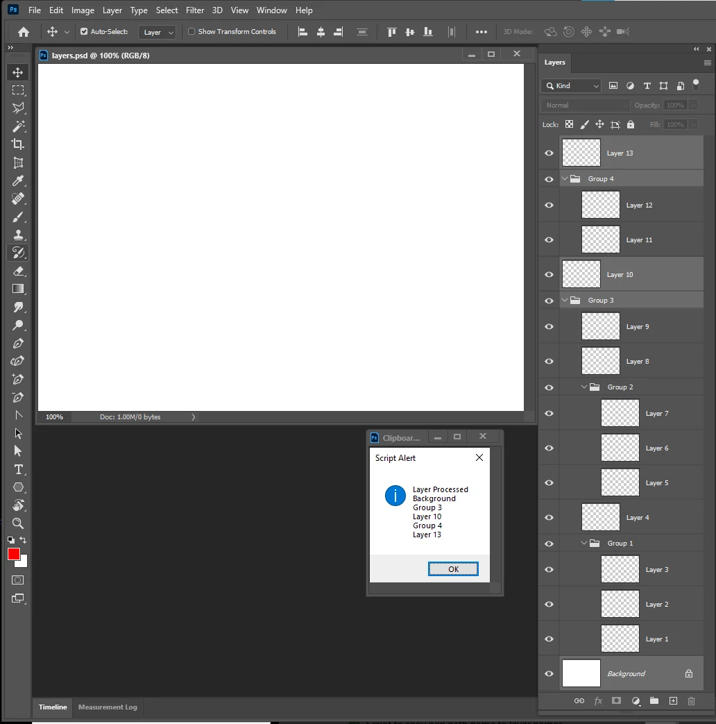

July 11, 2020
I may be right but I do not know scripting I just hack at it Often I steal others code and whack away at it make it submit to my will. I can not even type. I need a starting point.
Fairly Tail time.
Once upon a time I had some interest in Photoshop Layer stack and layers in the stack and layer kinds. So I took out my wip and whacked some code but at last  I do not remember what I did or how I did it my memory is not what it use to be. What remains are two script that seem to look at Photoshop's Layer Stack  in Layer stack order and spite out some information about the stack. LayersStack.jsx and  LayrsStackLayers.jsx  they look something like this.
Wait wait something is coming back to me  I seem to remember that Action Manager had some array of  its layer Kinds and DOM had it array of its Layer kinds.  Like Action Manager has a ]]Shape layer Kinds  but DOM has no Layer Kind Shape but sill manages to have more Layer Kinds than Action Manager go figure.
// 2019, use it at your own risk;

July 11, 2020
if any open document has a layer groups your script will not process all the layers.  You Script  is only processing top level Layers and Layer groups no layer in a group will be precessed.  You  need to use recursion to process layers in layer groups.
#target photoshop
for (var i = 0; i < app.documents.length; i++) {
	var targetDocument = app.documents[i];
	var layerCount = targetDocument.layers.length;
	var LayerProcessOrder="Layer Processed\n";
	for (var j = layerCount - 1; j >= 0; j--) {
		var targetLayer = targetDocument.layers[j];
		LayerProcessOrder = LayerProcessOrder + targetLayer.name + "\n";
		var layerName = new String(targetLayer.name);
		if (layerName.indexOf(targetLayer.name) == 0) {
			targetDocument.layers[j].name = j
	alert(LayerProcessOrder);
JJMack
July 11, 2020
Yes JJMack you are right, i just edited what the OP had already done, if needed this can be implemented as well. I would wait for the OP's comment before adding in a new snippet of code, being lazy here what if he does not need it 😛
-Manan
-Manan
July 11, 2020
That is beautiful. Thank you for your help. I've read your notes and am digesting it. Much appreciated.
