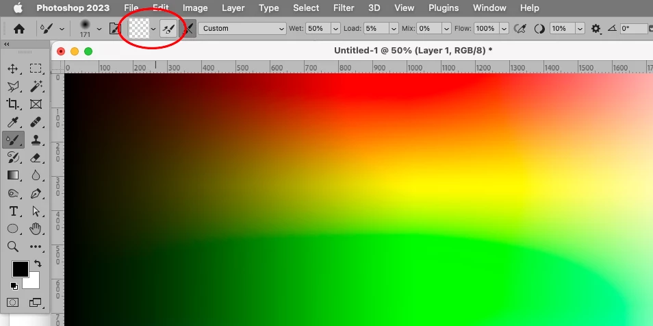

In the little drop down arrow to the right of the swatch that shows the color you are mixing, there is an option to "clean brush." Selecting this will allow you to mix with transparency, or in other words "paint with transparent as the color."

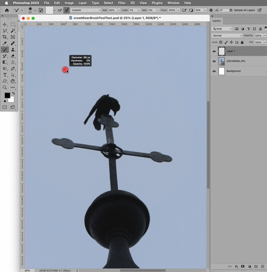

Did you mean this?

I just stumbled onto something that I think will fix this. Before I was simply selecting new layer, as in shift key, command key, and the letter "N," (Please keep in mind it's been sometime since I've done any digital painting as for the past few years I've been focused on my photography.) This morning, when I went to add my next layer so I could take a scren shot, I went "Layer" in the menu bar. When I selected "New," I noticed something I'd not seen before. An arrow appears. So I followed the arrow, and discovered there is an option called, "Layer from Background." I figured what the heck. Let's give it a try and see what happens. This option has no keyboard command, but boy oh boy did I have an aha! moment. That's the missing step! Now I'm able to use the Mixer Brush tool to blend the colors on my image. Problem solved!
