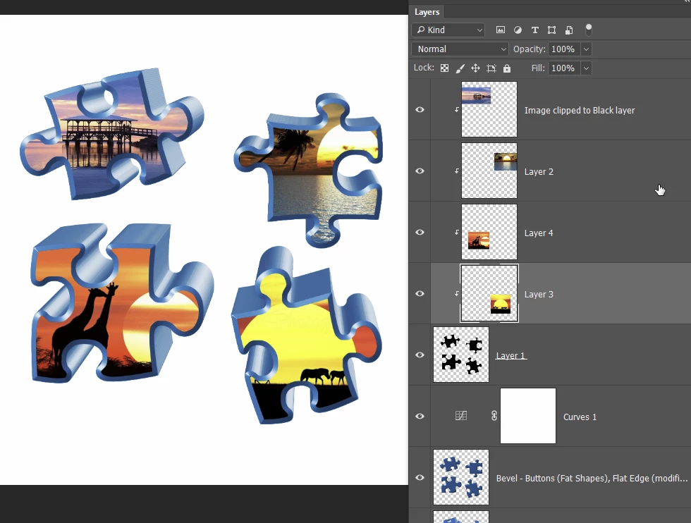

    You can see that I used a curves layer to brighten the bevel here, because it was easier than going back into Alien Skin.
    [EDIT]  You could use the above steps on a single layer containing all four jigsaw shapes to save time.  I'll have to try it to see how that effects the perspective of the extrusion though.
    Yep. Works fine.  In fact it is the way to go because the perspective is right for all four pieces.
    A minor complication is that the black layer has all pieces on the same layer, but you could either select and copy to separate layers, or leave as it is and clip all the images to the same layer, and control with Free Transform.

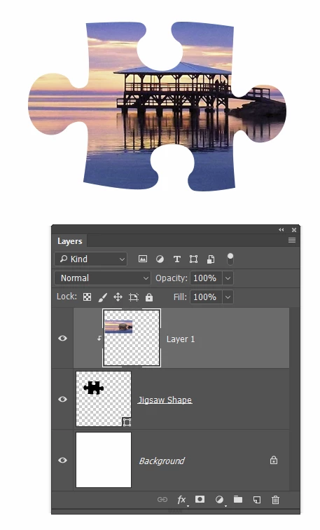

    What is the image size?  Or is your screen shot all you have?
    You are going to need to select the image area for jigsaw piece with the Pen tool, and use each clipping path to make a new layer which you can fill with a solid colour — something neutral like 50% grey.
    Then clip the new images to those layers.
    Or it might be easier to start again.  There are four jigsaw shapes in the default custom shapes supplied with Photoshop.
    Perhaps make a 3D object from the shapes.  If you left the front face a solid black it would be easy to select, and from that selection you could either make new layers to clip your images layers to, or make layer masks for them.
