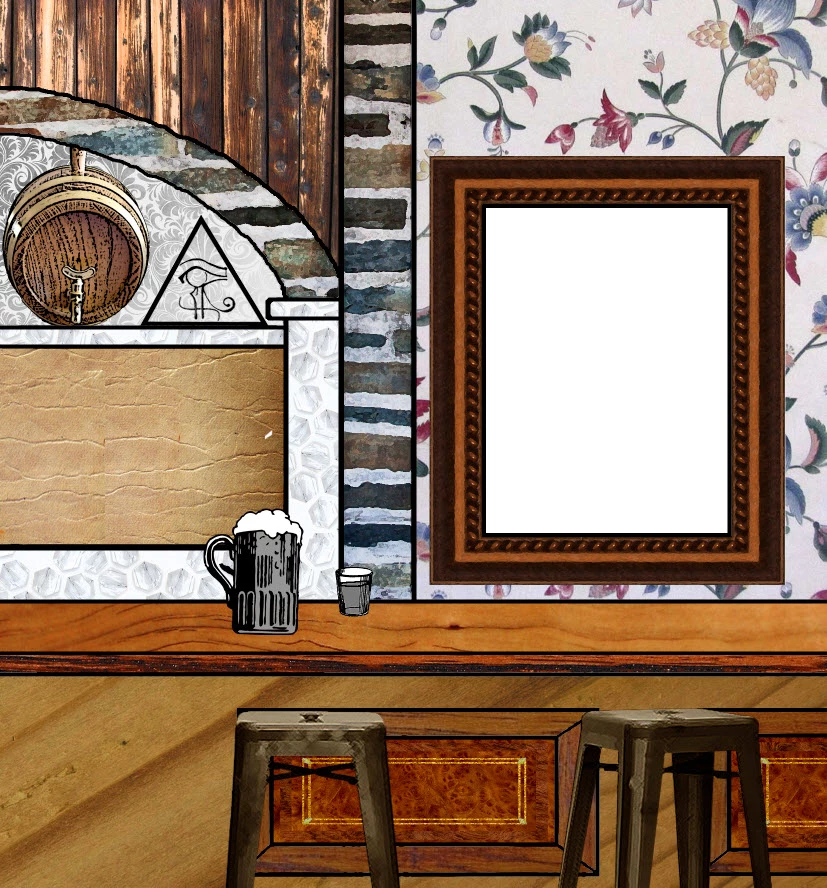

Jimbo,
Since this is a Beginners Forum, I admire your desire to take on this project and the effort you have made. However, it would be hurtful to provide an honest criticism of the image, from its jam-packed and confusing composition to  conflicting vantage points, unreal size relationships, lack of properly cast shadows, multiple unrelated textures, and random unrealistic objects, for starters. It seems to be a first attempt at Illustrator, rather than Photoshop. It would be unfair to offer this criticism without offering constructive advice. It is this: Analyze photographs of similar scenes. Make some of your own. Be aware of the contribution made by artful lighting. Consider the elements mentioned here and in other posts. One more thing: get rid of that "everything sharp" kick. Then begin again. From scratch. Good luck.

Hi All,
Thanks so much for the quick and detailed responses!
Please see below for a snapshot of the scene in question... This is a bar scene. The space above the pint is the beer taps area. In front of that is the bar itself, and in front of that are the bar stools.

February 22, 2018
If each of those elements are on different layers than things are pretty easy: take the item you want folks to focus on and leave it alone. Then in the other layers you can EITHER put in a slight Gaussian blur at different amounts (depending on how much further it is away from the primary item) or, Better Yet: go to Filter -> Blur -> Lens Blur.
The primary thing is that the further from your main subject (which should not be blurred), the more blur you set for each layer.
What you're doing here is creating the look called Bokeh, the Japanese term used for a soft, out-of-focus appearance. In the camera you do this with very very low f-stops (e.g., 1.8 or so). High f-stops (16+) will have close and distance objects all in focus.
