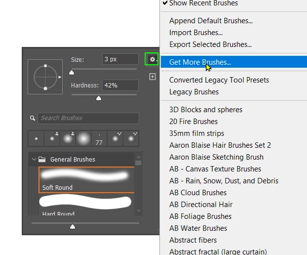

    Do you want to emulate oil painting?  If so, look for ‘impasto’ brushes.  I think Kyle Webster might have some that you can find by clicking on Get More Brushes from the brushes panel.
    This set is highly rated, but apparently difficult to find.  If you want it PM me your email and I’ll send it to you. Note they are a Tool Preset file rather .abr brush presets file, but I’ll send instructions.
    jonoiiiAuthor
    May 12, 2026 12:09 PM UTC
    Hi ​@Trevor.Dennis. Thank you very much for your reply! I will send you a DM about these brushes.
    To answer your question and be more specific — should I enable the transfer setting to control both opacity and flow with pen pressure, or disable the transfer setting all together and manually control opacity and flow with their respective sliders? From what I have seen online, this philosophy for painting digitally is independent of the actual brush “tip” or “shape” itself. I hope that makes sense and thank you very much for your time, it’s greatly appreciated.
