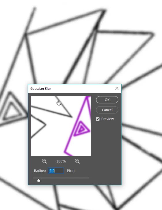

    lizabethy10432394   Your screen shot in post #4 has the look of either Threshold, or Levels/Curves pushed to the point all the anti aliasing is removed.  That's why I used a slight blur before applying Levels.
    I think I might have messed up, as I did not mention that this only works when the line is on a white background, and I think you said the lines were on a transparent background.  My bad.
    So top down, all zoomed to 300%
    One of your original lines.
    Gaussian blur (1 pixel)

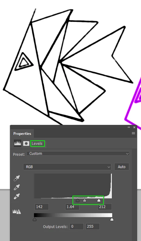

    Levels — note the position of the sliders.  They have to be spot on for best results.  Go too tight and the anti aliasing is gone again.  This is actually how Unsharp Mask works.

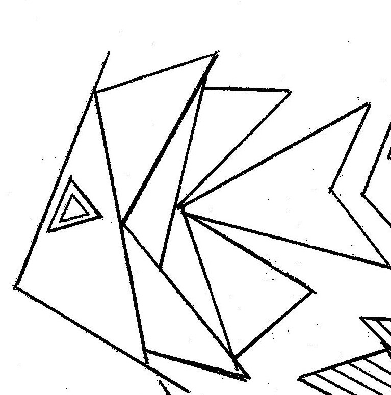

    Here is the original scan
    JJMack
    January 4, 2019

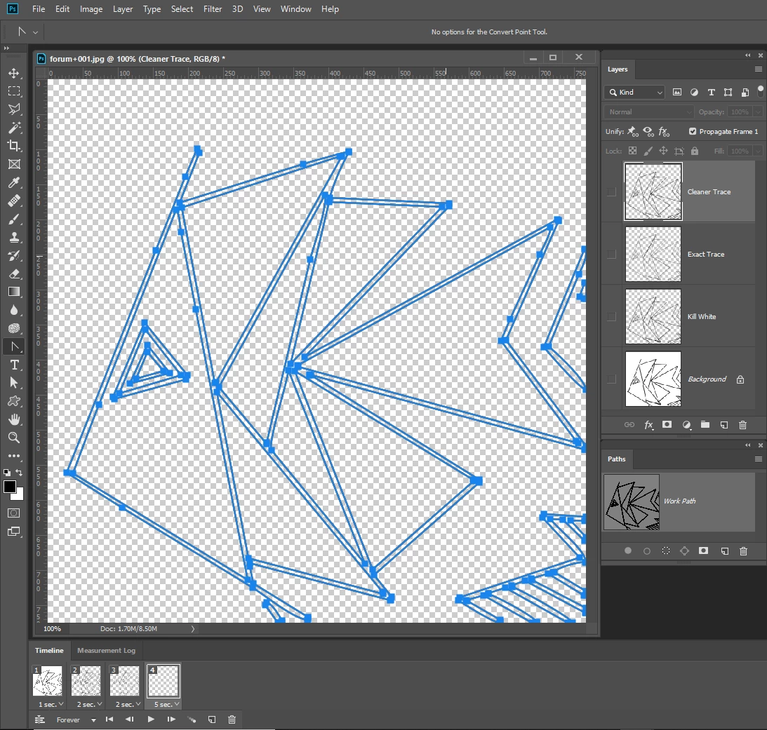

    Because the lines are straight bit not clean.  With  you basically have three choices.   Kill the white background.  Use a Brush on a new empty layer and use click and shift click to trace lines exactly like the drawing or use a Brush on a new empty layer and use click and shift click to trace lines wider and cleaner that the drawing.  Photoshop does not have and auto trace like AI. With some cleanup I would think AI auto trace would do a good job perhaps vector it.  And you may be able to edit the vector graphics.  I do not install AI or know how to use it.  In Photoshop you could select the back and have Photoshop create paths for the selection which you could edit. But be a lot of work.
