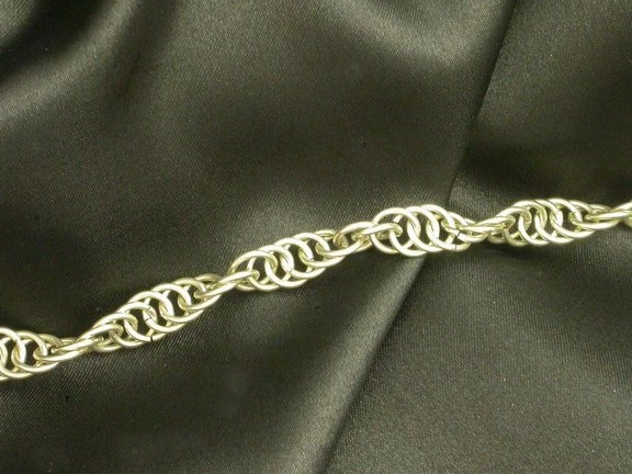

I created this chain by making a custom brushstroke. I want it to appear twisted like the chain in the image below. I cannot for the life of me figure out how to do this. Can anyone help?

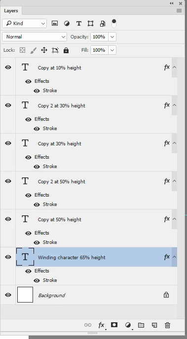

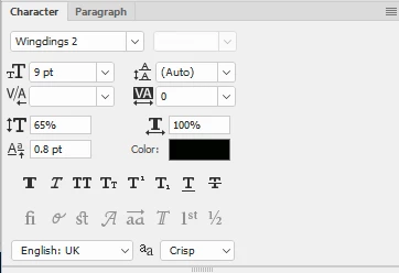

    A chain made out of Wingding circle text characters, stroked to a path with spaces in between,
    Then duplicated. For each duplicate the height and offset was adjusted in the characters panel and then moved along the path. Finally the layers stroked with 1 pixel stroke, in layer styles just to thicken them.
