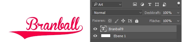

how to add a tail on the end of a text in photoshop?
    Correct answer
    Apr 17, 2016 2:26 PM UTC
    I used the font required and pressed the number 9 to add the tail on at the end but when I click off of the image the tail disappears
    I tested the font (from dafont.com) in the actual Photoshop on a Windows 7/32 Bit computer.
    It's all ok.
    Fenja
