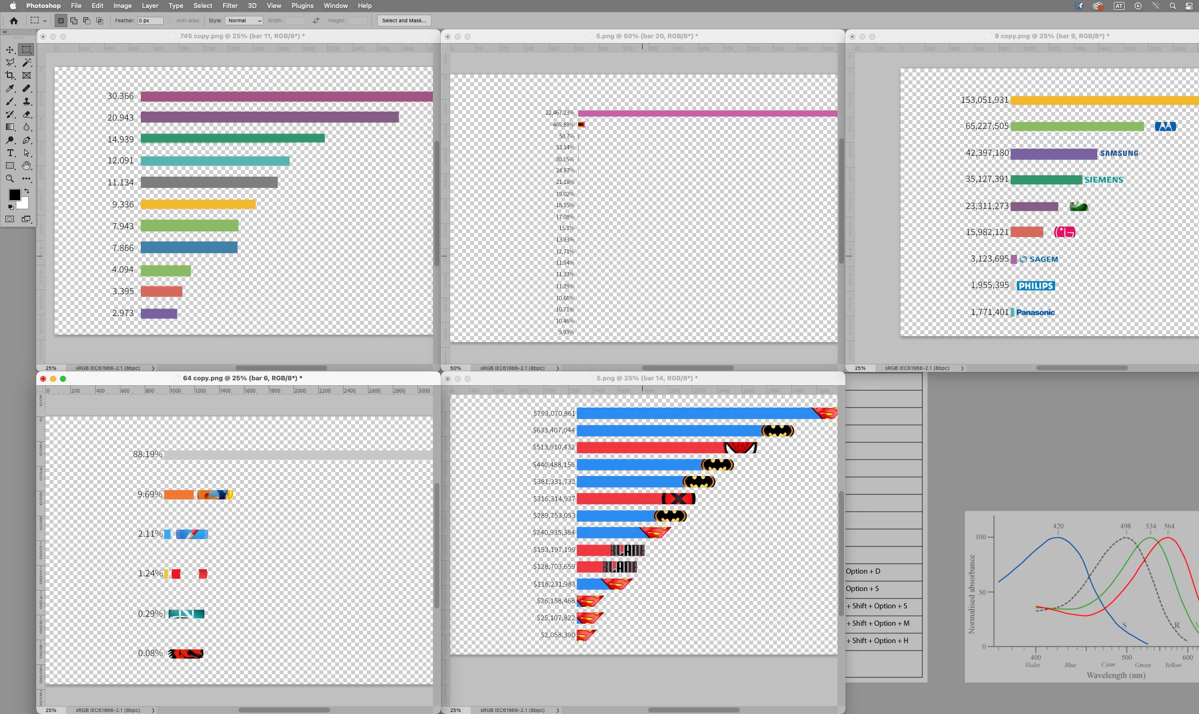

I receive about 1000 chart images daily that following images are two sample of my images:
Now i want to align values of charts using flip horizontal and use photoshop action or script to apply on 1000 daily images like following:
The left side of the chart bars does not need any changes and photoshop action can divide the images into two parts (left side of chart bars - other sides of chart bars)
next step of action after dividing images, the values on the right side of the chart bars should be selected with Color Range (dark color)
Now i have problem after above step. I must expand selection of values (that i selected by color range) to only left side and selections must extend to the edge of the left border of the layer.
After extending the selections to the leftmost point of the layer, i can convert each selection to specific layer and every layer can filp horizontal.
Finally with above steps photoshop action can align all of my images values.
Does anyone have any ideas to solve my problem?

Correct answer c.pfaffenbichler

ok - i will create a new conversation for it. tnq very much
This should perform at least somewhat faster if you want to give it a try:
// moveNumbersLeftOfBarGraphs
// separate elements in specific graphics, put the bars right and align the numbers on the left;
// ideally bars and logos should be colorful to make numbers better identifyable;
// 2023, use it at your own risk;

5 replies
c.pfaffenbichler
June 11, 2023
edited 2023-06-12
var time1 = Number(timeString());
moveNumbersLeftOfBarGraphs ();
var time2 = Number(timeString());
alert("\nthe script took: "+((time2-time1)/1000)+" seconds\nstart "+time1+"\nend "+time2+"\n\n");
////// move numbers to left of bar graphs //////
function moveNumbersLeftOfBarGraphs () {
if (app.documents.length > 0) {
// the number of pixels in percent;
var theScale = 400;
var originalRulerUnits = app.preferences.rulerUnits;
app.preferences.rulerUnits = Units.PIXELS;
app.togglePalettes();
var myDocument = app.activeDocument;
if (myDocument.mode != "DocumentMode.RGB") {myDocument.convertProfile ("sRGB IEC61966-2.1", Intent.RELATIVECOLORIMETRIC, true, true)};
var theLayer = myDocument.activeLayer;
// resize image;
myDocument.resizeImage (undefined, undefined, 72, ResampleMethod.NONE);
myDocument.resizeImage (new UnitValue (theScale, "%"), new UnitValue (theScale, "%"), undefined, ResampleMethod.NEARESTNEIGHBOR);
// create path;
loadChannelAsSelection("red", true, false);
loadChannelAsSelection("grain", true, true);
loadChannelAsSelection("blue", true, true);
myDocument.quickMaskMode = true;
applyThreshold(90);
myDocument.quickMaskMode = false;
var theHorStart = myDocument.selection.bounds[0];
var thePathIndex = makeWorkPath2 (1);
var thePath = collectPathInfoFromDesc2023 (myDocument, thePathIndex[0]);
deselect ();
//deletePath(thePathIndex[0]);
myDocument.pathItems[0].selected = false;
createBackgroundAndSelectiveColorAdjustmentLayerAndThresholdAdjustmentLayer();
var lineStartExtremes = getSubPathItemExtremes(thePath[0]);
//var theHorStart = lineStartExtremes[0];
var theRectanglesPath = [[thePath[0]]];
var theNumbersPath = [[]];
// process subpathitems;
for (var m = 1; m < thePath.length; m++) {
var theExtremes = getSubPathItemExtremes(thePath[m]);
// check color;
polygonalLassoToolFromPathArray([thePath[m]], false, false);
var theHisto = histogram ();
// add subpathitem if within the vertical dimensions;
if (theExtremes[1] >= lineStartExtremes[1] && theExtremes[3] <= lineStartExtremes[3]) {
// if right of suspected bar;
if (theExtremes[0] > lineStartExtremes[2]) {
// add neutrals to number;
if (theHisto[0][255] > theHisto[1]*0.5) {
theNumbersPath[theNumbersPath.length-1].push(thePath[m])
// add colorful to bar;
} else {
theRectanglesPath[theRectanglesPath.length - 1].push(thePath[m]);
lineStartExtremes[2] = Math.max(lineStartExtremes[2], theExtremes[2])
} else {
lineStartExtremes[2] = Math.max(lineStartExtremes[2], theExtremes[2])//?
// if further down;
} else {
// new rectangle;
if (theExtremes[1] > lineStartExtremes[3] && theExtremes[3] > lineStartExtremes[3]) {
if (theExtremes[0] <= theHorStart + 8 && theExtremes[0] >= theHorStart - 😎 {
theRectanglesPath.push([thePath[m]]);
theNumbersPath.push([])
lineStartExtremes = theExtremes;
else {
theNumbersPath.push([thePath[m]])
} else {
//    lineStartExtremes = theExtremes;
} else {
myDocument.layers[0].remove();
myDocument.layers[1].remove();
deselect ();
// create the layers;
var theRectangles = new Array;
var theNumbers = new Array;
// create layers for the rectangles;
for (var n = 0; n < theRectanglesPath.length; n++) {
polygonalLassoToolFromPathArray(theRectanglesPath[n], false, true);
expandSelection[4];
layerViaCopy ("bar "+(n+1));
deselect ();
theRectangles.push(getLayerIdAndBounds ());
myDocument.activeLayer = theLayer;
// create layers for the numbers;
for (var o = 0; o < theNumbersPath.length; o++) {
polygonalLassoToolFromPathArray(theNumbersPath[o], false, true);
expandSelection[4];
layerViaCopy ("number "+(o+1));
deselect ();
theNumbers.push(getLayerIdAndBounds ());
theLayer.visible = false;
// move layers;
var theHorZero = theRectangles[0][2][0];
var theDist = theNumbers[0][2][0] - theRectangles[0][2][2];
var theWidths = theNumbers.sort(sortArrayByIndexedItem);
var theLongestNumber = theWidths[theWidths.length-1][3];
// move layers;
for (var b = 0; b < theNumbers.length; b++) {
moveLayer(theNumbers[b][1], theHorZero-theNumbers[b][2][0]+theLongestNumber-theNumbers[b][3], 0)
for (var c = 0; c < theRectangles.length; c++) {
moveLayer(theRectangles[c][1], theLongestNumber+theDist, 0)
// reset;
myDocument.resizeImage (new UnitValue (10000/theScale, "%"), new UnitValue (10000/theScale, "%"), undefined, ResampleMethod.NEARESTNEIGHBOR);
app.preferences.rulerUnits = originalRulerUnits;

June 11, 2023
quote
By @c.pfaffenbichler
what is this error? i tried to run your latest reply script on some samples but i get this error
c.pfaffenbichler
June 12, 2023
If at this point it is still not obvious to you that you need to provide affected file/s for testing this seems pointless.
I have not tested on all the images you sent but the Script worked for at least one file from the five folders you sent.
c.pfaffenbichler
June 2, 2023
Maybe we should try to avoid getting bogged down in irrelevancies again.
Please provide
• a representative sample of the original images and
• the corresponding results you have produced and which meet your needs – aside from the numbers being on the right instead of on the left of the bar
June 2, 2023
quote
Please provide
I put three action files (ATN) with images specific to the action file for you. I hope you understand my method completely.
note that do not run the action files as batch, because many images are executed, and there is no close in the end of action files (i only show my method to select right side)
https://drive.google.com/file/d/1AhAUvGB9xiweyXyfBEkfarV-fc4i5hGF
c.pfaffenbichler
June 2, 2023
The Actions are of no interest to me.
If they get you the results you need (aside from the flipping of bar graph and number) that’s just fine.
Please provide
• the corresponding results you have produced and which meet your needs – aside from the flipping
May 26, 2023
I tried attached action (atn file) to select right white bars but i don't know how to select only white bars and values without logos and colored bars. does anyone have any ideas to complete this process?
My ATN file is : https://drive.google.com/file/d/15EH-UjG-uS5Ze_q0YNoO7tPA3cxOsZZE
May 24, 2023
@c.pfaffenbichler
@Stephen Marsh
You have already provided ideas to this conversation in a similar conversation. Please help if possible.
c.pfaffenbichler
June 1, 2023
It seems unfortunate that you apparently have to rectify issues that people upstream from you refuse to rectify.
Are those images from the original post the actual images you received or did you damage them further?
Unless you made considerable Scripting-progress since the previous thread/s I doubt that you will be able to automate this.
June 2, 2023
quote
Does manipulating the photos or not have an effect on finding a solution to this problem?
A few months ago, we made a lot of efforts in the previous thread/s and it did not reach a result, but I had no choice but to raise this problem again.
I put a solution that we did not discuss in the previous thread/s in the form of a ATN file in the last reply of this thread and I need consensus to complete it. If you have an idea to complete this solution, let me know. It may be the only solution to this problem.
May 24, 2023
Does anyone have any ideas?
