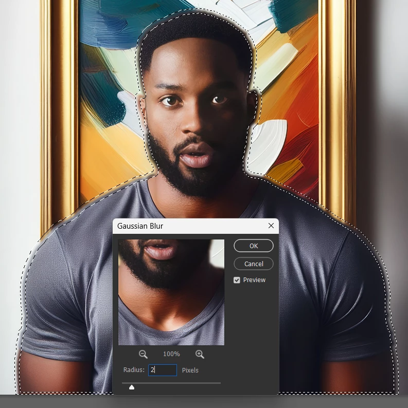

We can select just the area we want to blur in a layer, so this is maybe a different way of coming at it.
I used the Object Selection tool using its 'People' function to select the man.
I made a temporary layer and filled that selection with black just as a way to save the selection.
I selected the main layer and hit the Q key to turn on Quick Mask.
Ctrl clicked the temporary layer to load the selection and used Edit > Stroke which gave me the situation below.
Turn off Quick Mask which leaves the thin band selected, and use Gaussian blur
I should probably have removed that area across the bottom of the image before blurring, but you get the idea.
You would also very likely not want the edge of the blurred area to be sharp like that, so use Shift F6 to feather the selection before applying the blur

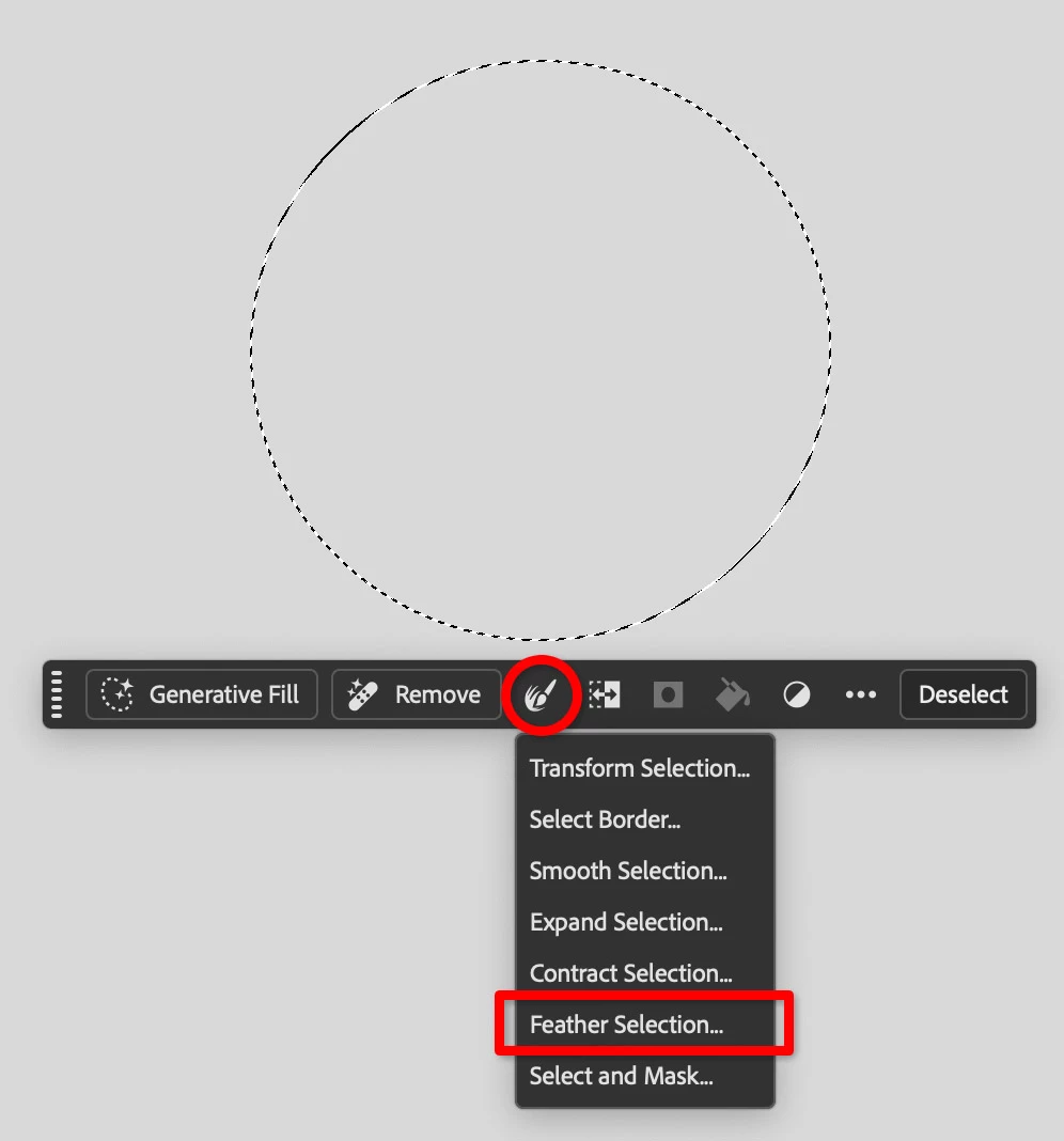

@JimmyPage11  *The Feather command can be found in at least three places, when a selection is active:
  • The menu command Select > Modify > Feather
  • Context menu (right-click, or if you haven’t configured right-click on your Mac then it’s Control-click). This is how ExUSA tried it.
  • Contextual task bar under the icon marked in the picture below
