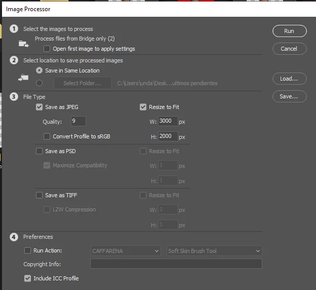

I can't believe ten years after I have the same problem.
I'm using Photoshop 24.0.0
This is what my "image processor" box looks like:

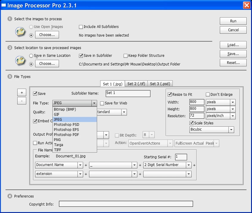

You can also download the Image Processor Pro plug-in script from Russell Brown's web site for CS6 once installed you will find it under menu File>Automate>Image Processor Pro... It can sane many more file types the the standard Image Processor script.  Tou cal also save as many image files as you need saved for an image you not limited to and set number and you can save more the one of any file type supported. I see PNG I do not see PNG-24
