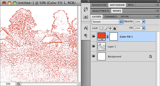

ok, i just changed it to screen in the pull down, but still all i have is a big red screen.  my line art doesnt show up in any color though both layers are active (eye icon on)
It's probably because you have the art on a separate layer with no background. If all the art is on one layer, you can get away with a color overlay layer style/layer effect. Or just clip the solid color layer to your art by option clicking between the two layers.

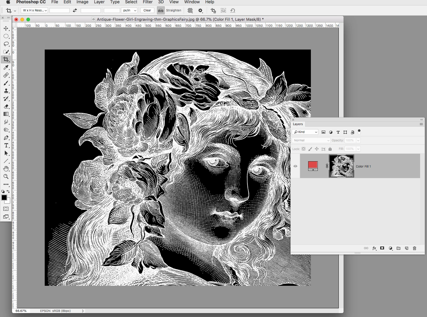

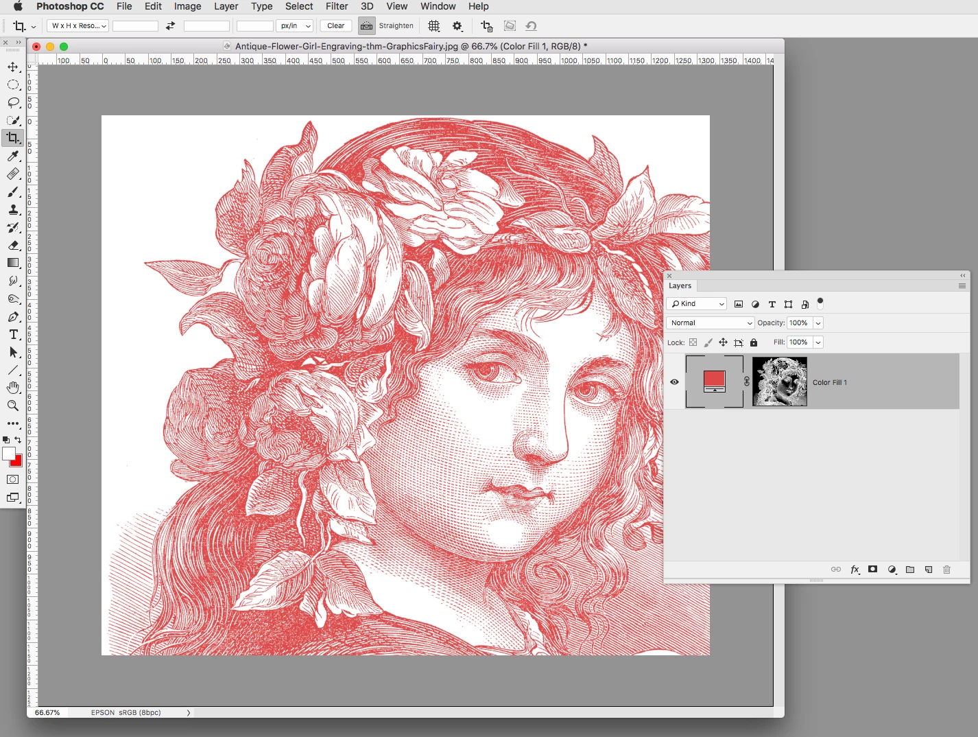

Solid Color Adjustment layers can have a mask, so a simple way to do this is paste the B&W line art into the layer's mask channel as a negative:
Then the precise color of the line art can be edited from the Solid Color layer's Color Picker

so what is layer one?  and how did you get it to the form where the redfill
applies to it but not to rest of image?
May 18, 2010
Layer one is your lines. I set the color fill layer blend mode to screen, which make everything below it that is black, turn into red.
