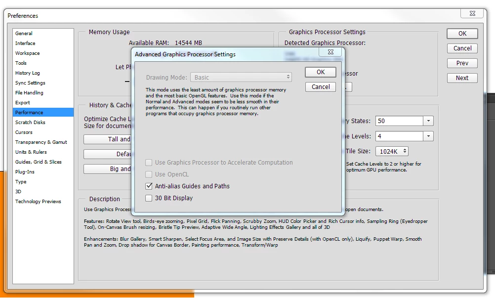

I'm experiencing the same issue and trying to change the drawing mode, however its greyed out (See screenshot). Does anyone know how I can get round this?
Aug 5, 2015 1:21 PM UTC
Same here - could it be that we are using low spec PC's so the graphics card wont let us change from Basic?
