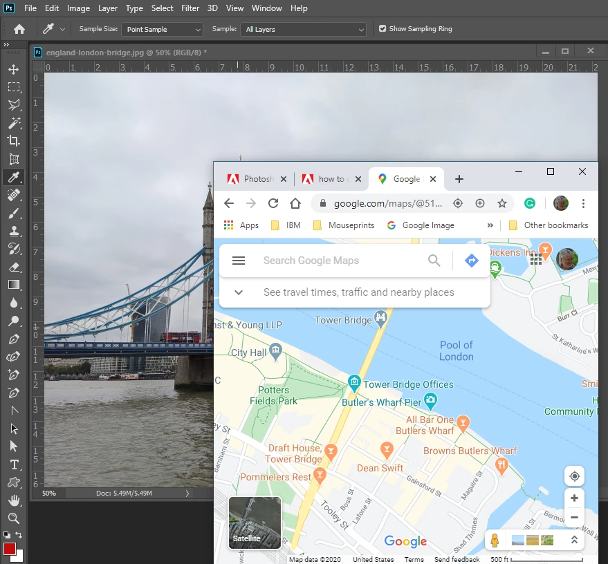

I can not state I know how.  Years ago I found Photoshop script that seems to do what you want. However it may be using the Camera EXIF meta data which may not be the bridge data you are referring to. I hardly ever use the bridge.  I forget what the script originally supported.  I may have used a sledge hammer on the script to get it to do what I wanted it to do.  I knew almost nothing about JavaScript and Photoshop Scripting back then. I know just a little more these days.   I can not say I use the script.  But I just downloaded a image of the London Bridge and opened it in Photoshop and ran the script.  A browser window opened with Google Map position  on  the London bridge in Europe not the one in our desert. So it seems like  the code may do what you want.
// Open Map from GPS Location.jsx
// Version 1.0
// Shaun Ivory (shaun@ivory.org)
// Feel free to modify this script.  If you do anything interesting with it,
// please let me know.
// JJMack I just used my sledge hammer on Shaun's Photoshop script
// I sucked in his include file and removed his include statement
// then I commented out his dialog and just Goolge Map the GPS location

            break;
        case "google":
            strUrl = CreateGoogleMapsUrl(strLatitude, strLongitude);
            break;
        case "virtualearth":
        default:
            strUrl = CreateVirtualEarthUrl(strLatitude, strLongitude);
            break;
        // Create the URL file and launch it
        var fileUrlShortcut = new File(c_strTemporaryUrlFile);
        fileUrlShortcut.open('w');
        fileUrlShortcut.writeln("[InternetShortcut]")
        fileUrlShortcut.writeln("URL=" + strUrl);
        fileUrlShortcut.execute();
    // Set the button characteristics
    dlgMain.cancelElement = dlgMain.btnClose;
    dlgMain.defaultElement = dlgMain.btnOpenSite;
    dlgMain.center();
    return dlgMain.show();
function GoogleMap(strLatitude, strLongitude)
		try{
		var URL = new File(Folder.temp + "/GoogleMapIt.html");
		URL.open("w");
		URL.writeln('<html><HEAD><meta HTTP-EQUIV="REFRESH" content="0; ' + strUrl + ' "></HEAD></HTML>');
		URL.writeln("<!DOCTYPE html>");
		URL.writeln("<html><head>");
		URL.writeln('<meta name="viewport" content="initial-scale=1.0, user-scalable=no">');
		URL.writeln('<meta charset="utf-8">');
		URL.writeln("<title>Simple markers</title>");
		URL.writeln("<style>html, body, #map-canvas {height: 100%;margin: 0px;padding: 0px}</style>");
		URL.writeln('<script src="https://maps.googleapis.com/maps/api/js?v=3.exp&sensor=false"></script>');
		URL.writeln("<script>function initialize() {");
		URL.writeln("var myLatlng = new google.maps.LatLng(" + strLatitude +"," +  strLongitude + ",true);");
		URL.writeln("var mapOptions = {zoom: 15,center: myLatlng,mapTypeId: google.maps.MapTypeId.ROADMAP}");
		URL.writeln("var map = new google.maps.Map(document.getElementById('map-canvas'), mapOptions);");
		URL.writeln("var marker = new google.maps.Marker({position: myLatlng,map: map,title: 'My Picture Name'});}");
		URL.writeln("google.maps.event.addDomListener(window, 'load', initialize);");
		URL.writeln('</script></head><body><div id="map-canvas"></div></body></html>');
		URL.close();
		URL.execute();   // The temp file is created but this fails to open the users default browser using Photoshop CC prior Photoshop versions work
	}catch(e){
		alert("Error, Can Not Open.");
function OpenMapUrl()
    // Get the latitude
    var strDecimalLatitude = GetDecimalLatitudeOrLongitude(c_ExifGpsLatitude, c_ExifGpsLatitudeRef);
    if (strDecimalLatitude.length)
        // Get the longitude
        var strDecimalLongitude = GetDecimalLatitudeOrLongitude(c_ExifGpsLongitude, c_ExifGpsLongitudeRef);
        if (strDecimalLongitude.length)
            //ShowMyDialog(strDecimalLatitude, strDecimalLongitude);
			GoogleMap(strDecimalLatitude, strDecimalLongitude);
function Main()
    if (app.documents.length > 0)
        OpenMapUrl();
    else
        alert("You don't have an image opened.  Please open an image before running this script.");
Main();
