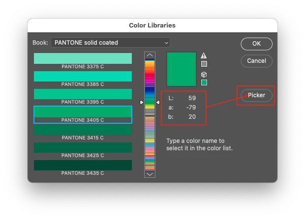

The spot colour is based on a Lab model colour book:
Conversions use colour management (Edit > Colour Settings), in this case your working CMYK profile, rendering intent etc.

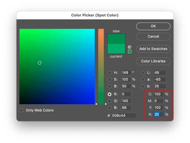

Press the "Picker" button to change from the default Lab colour build and type in your required CMYK values:

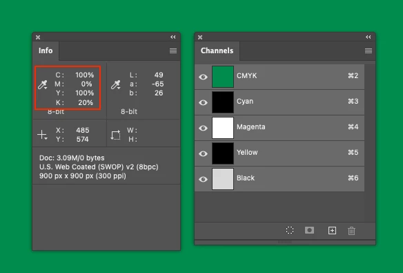

Then when you merge your spot channel to CMYK in Photoshop you will get the overridden value:

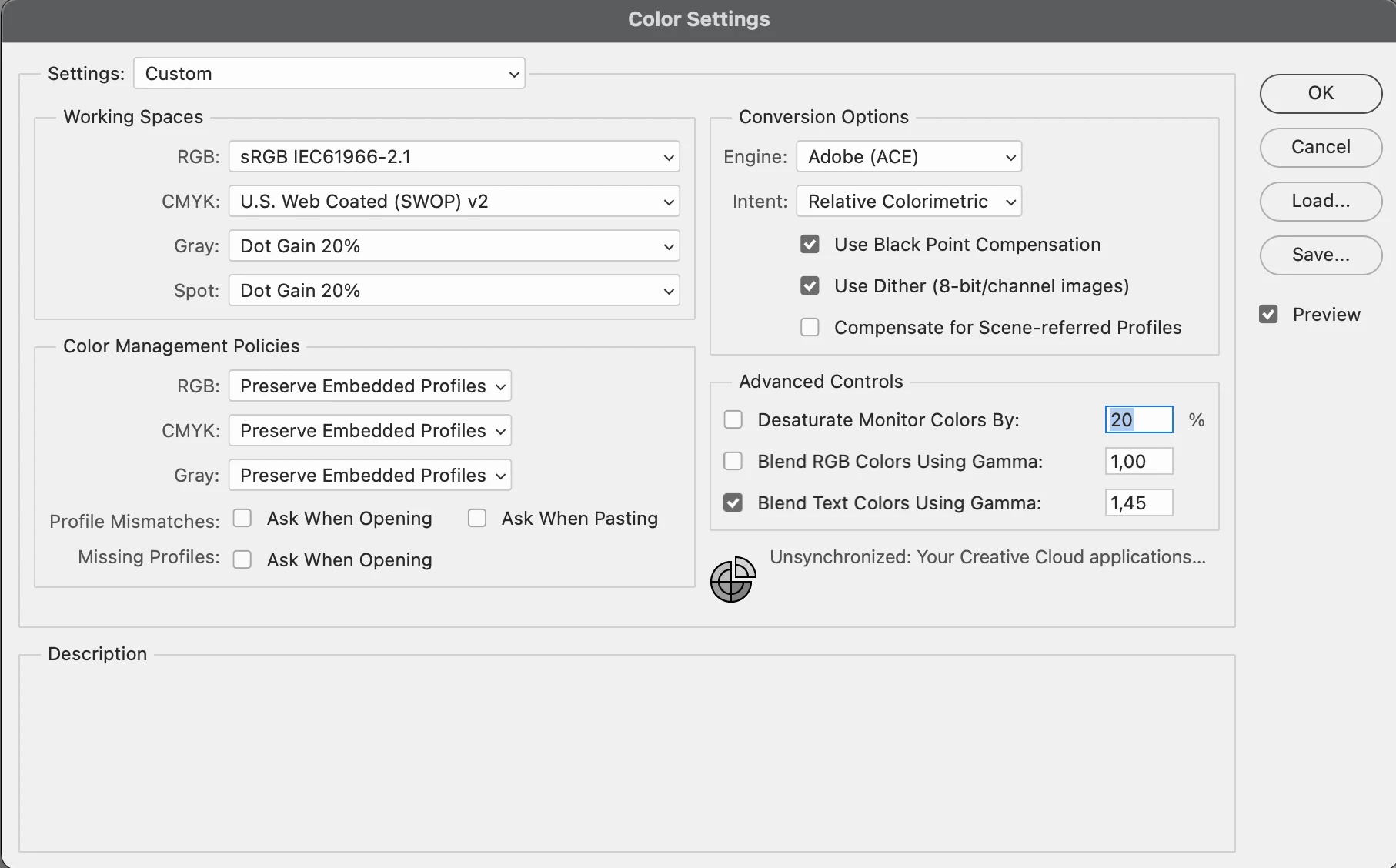

Hello, sorry, but I didn't understand ANYTHING that I should do in the Edit > Colour Settings menu
I have it like this -

Based on your picture, the way a color is converted to CMYK is based on the profile U.S. Web Coated (SWOP) v2, the one selected under Working Space, CMYK.
If you aren’t happy with the CMYK values resulting from a conversion, you probably need to select a different CMYK profile. Ideally, you should select a CMYK profile representing the exact printing conditions that your job is targeting (the press, paper, and ink setup that will be used by the printing company to print your job).
For example, different CMYK profiles will apply different total ink limits or different black generation, and those will affect how color values are distributed across the CMYK ink channels.
