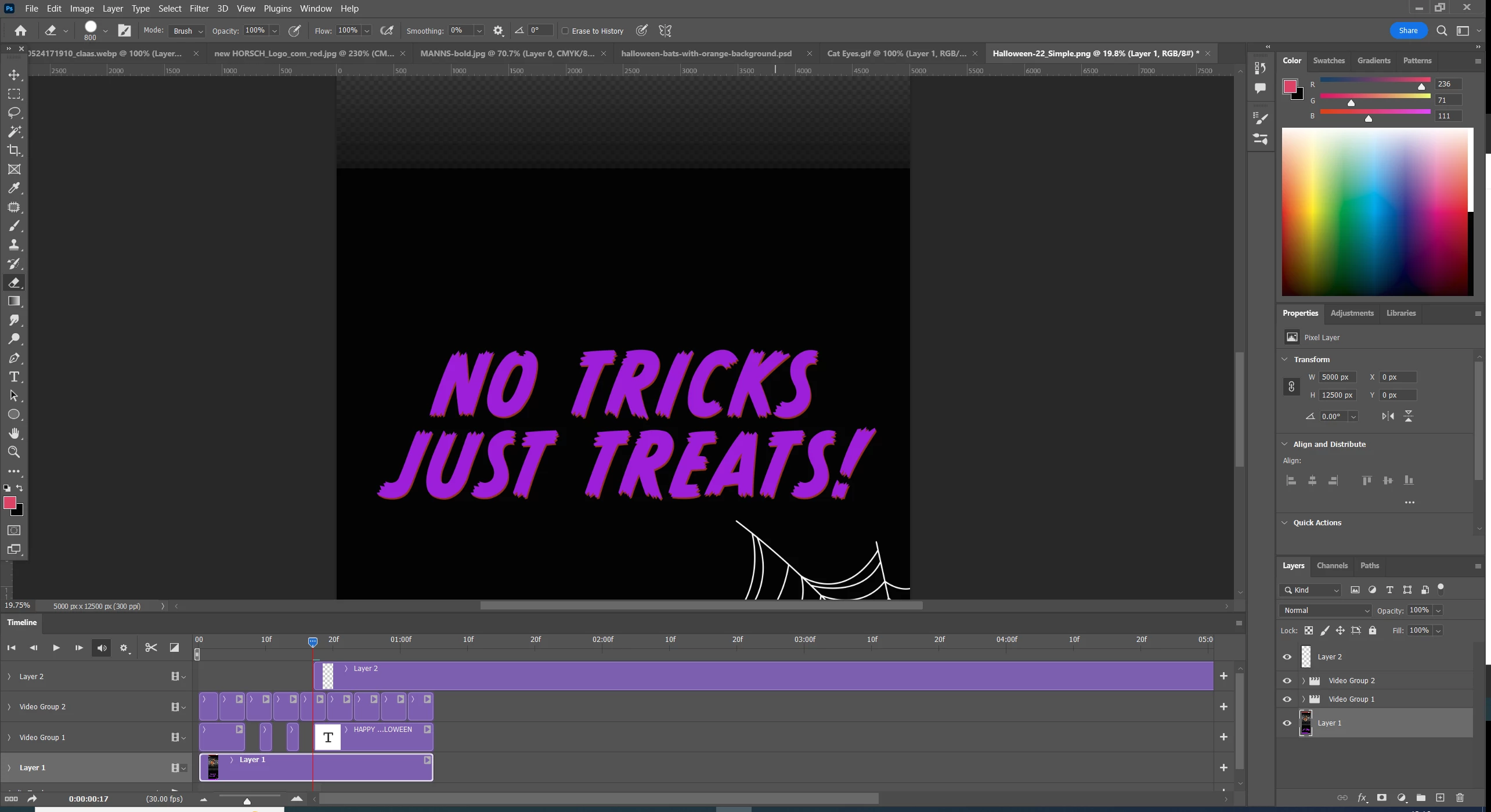

Bumping this (2022)
Have copied all timeline files from another file (67 frames).
As the attached shows, I'm not able to paste but I have copied, any ideas?
Thanks

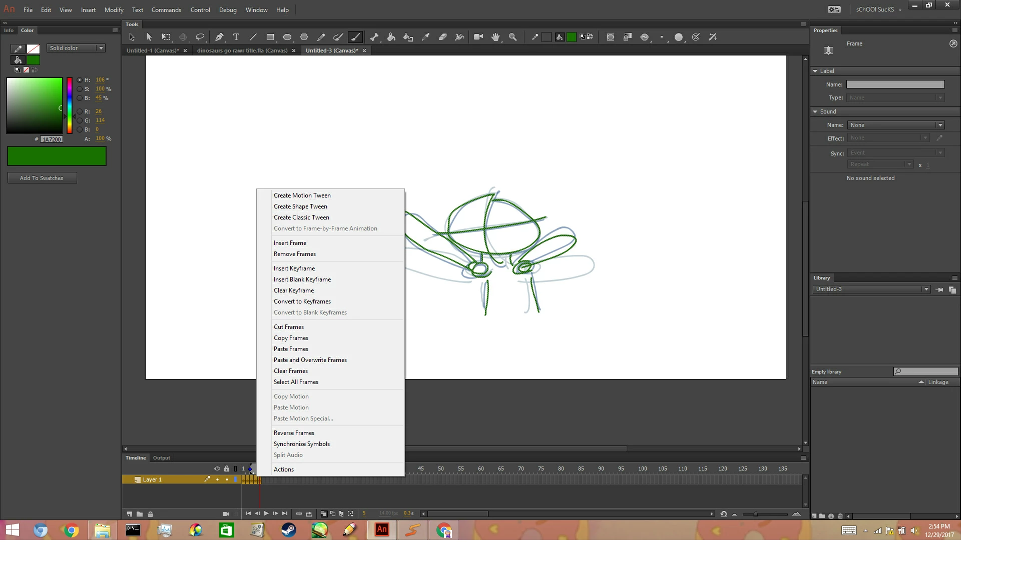

December 29, 2017
HI! I had the same question, until i figured it out myself in 5 minutes, so, first u yeah u click the frame, then right click beside the yellow thing or else it won't work, then it says copy frames, then u press copy frames, then go to wherever u wanna put the frame, then right click, then it will show the thingy again, then click paste frames. Soooo WALA!!!

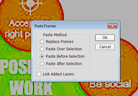

Hi tobiasr51551356
Could you please try the below steps:
1. Select all the Frames you would like to paste at some other location and the select Copy Frames.
2. Select the Frame where you would like to add the other frames (can add a frame Before or after the frame) and select Paste Frame from the drop down list.
3. Select the appropriate method .
Please let us know if it helps.
