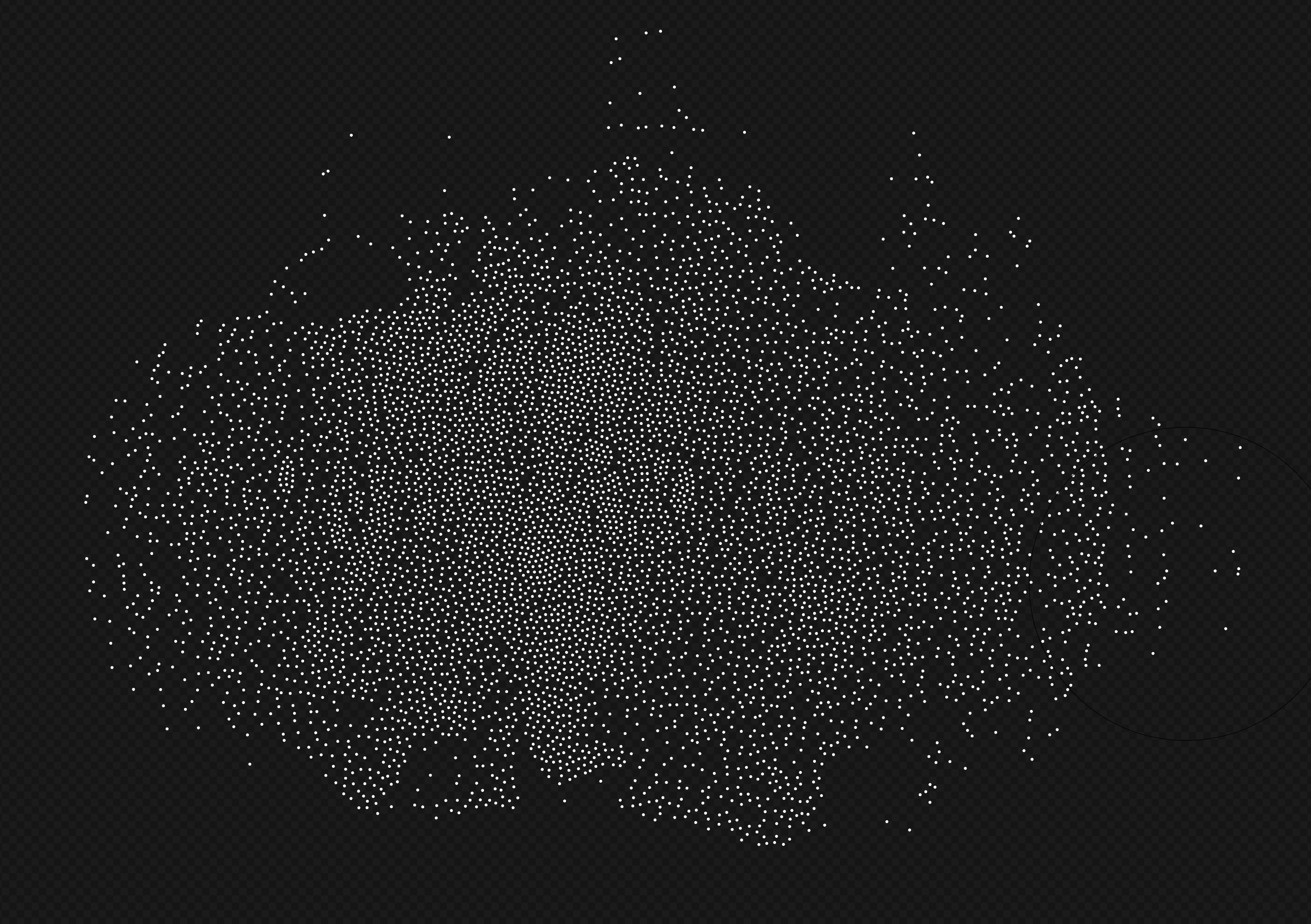

I can do this in Illustrator with the Symbol Sprayer tool up to a certain point (see attached image), but then the program slows to a crawl. I need something I can do on a much larger scale.

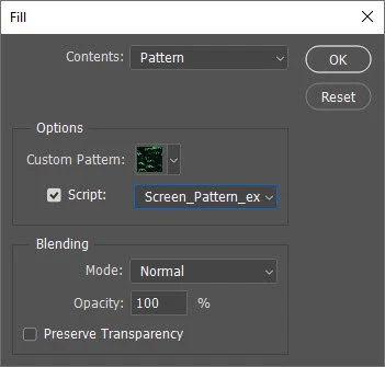

You could try the free Comic Kit plugin on Adobe Exchange (https://exchange.adobe.com/apps/cc/13159).
After you install it, do the following
1. Choose Edit > Fill
2. Choose Content: Pattern
3. Check the check box next to Script: under Options
4. Choose Screen_Pattern_ex from the script dropdown menu
5. Click OK
Then in the Screen Pattern dialog, select the following:
  1.  In the Basic tab, set Pattern Gradation to Radial
  2. Increase the Randomize Patterns amount as desired
  3. Modify the other settings as desired
  4. Click OK
You may need to test various settings to make the dots not overlap.
