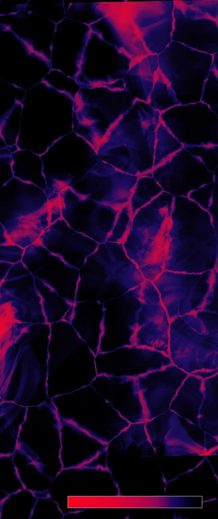

Hi All,
I would like to create a smilar random color strand pattern effect as in the attached image. Any helpful hints or directions are most welcome (the fine color strand effect is the part Im stuck on).
Thanks, sending positive karma

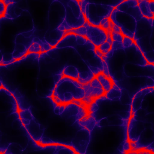

For example, I assigned a gradient map with colours based on the above image to one of the electricity examples:
But the original probably combines multiple textures (a distorted tile/voronoi noise and a smoke texture) with manual masking and cloning of those whisps of smoke.

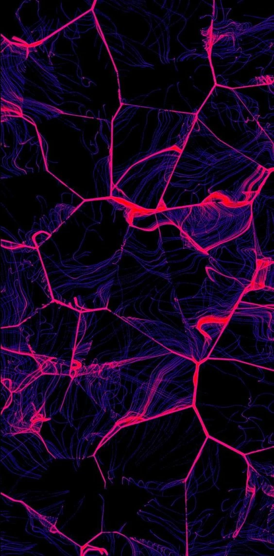

Here I generated three different textures in layers using Filter Forge: two smoke/whisp textures ("Whisp" and "Smoke and Vapours" and "Crackle Snippet"). I adjusted the settings to my liking, and then used basic masking and layer duplication/transformation to create the following result:
This comes closer to the original. To generate straighter lines would require a different procedural noise/texture. And duplicating the smoke whisps would take longer to make it look nicer. I only played around for a few minutes here to present a starting point for you.
PS instead of Filter Forge you could search the net for similar looking textures.
