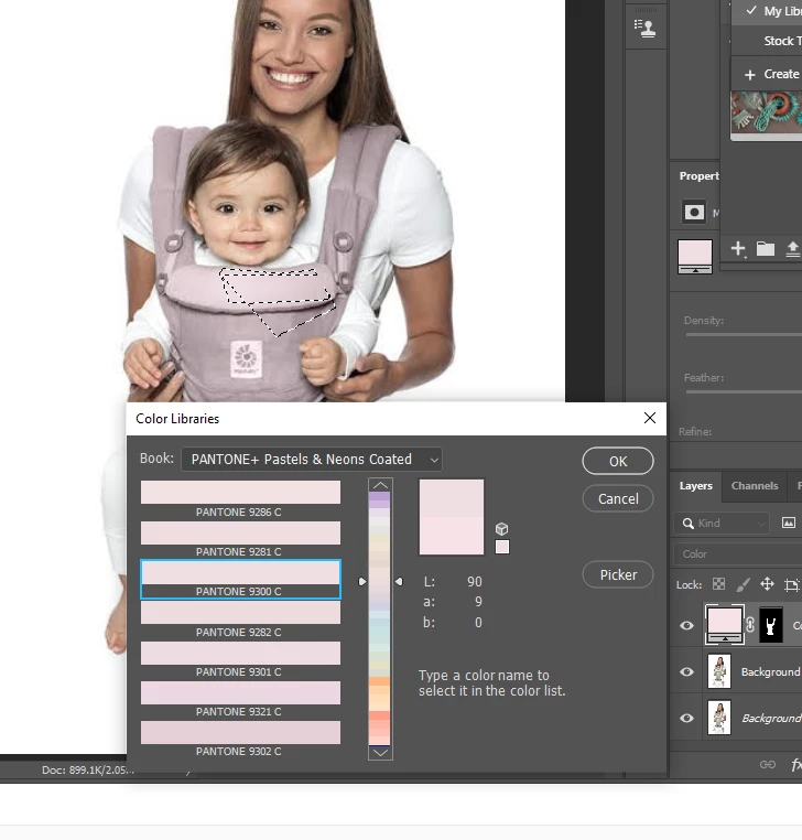

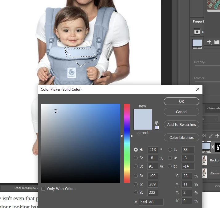

I have below attempted to pick a pastel colour from the library but the end result is not the same shade at all. The picker is light cornflower blue but the end result on harness looks darker and harsher.
The saturation is low at 18%.
If i put it much lower it becomes grey. It i put it just few percentage lower it just heads towards grey but not towards looking like the colour in the picker.
Im not sure if its something I am doing wrong?

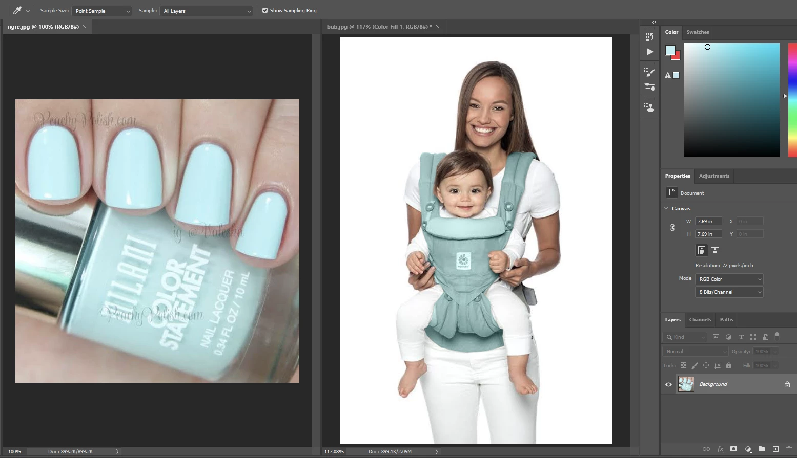

Below is an example of the results I am getting. I used the dropper tool to sample from the pale blue nail polish.
I then made a solid colour layer and put the colour on the baby harness.
As you can see, the shade is nothing like the nail polish shade and looks harsh. When i adjust the hue and saturation etc it just ends up other shades of harsh different colours:(
I am getting these results for most projects i am trying. This one isn't even that pastel but i am producing bad results. Trying with pastel colours end up just as bad with the colour looking harsh and wrong....

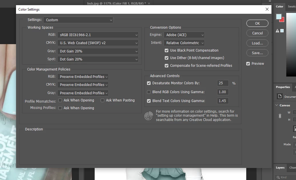

Attached is also a screenshot of my photoshop olour settings.

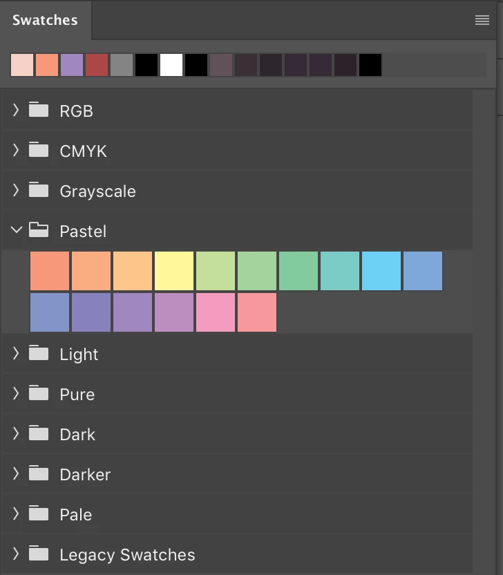

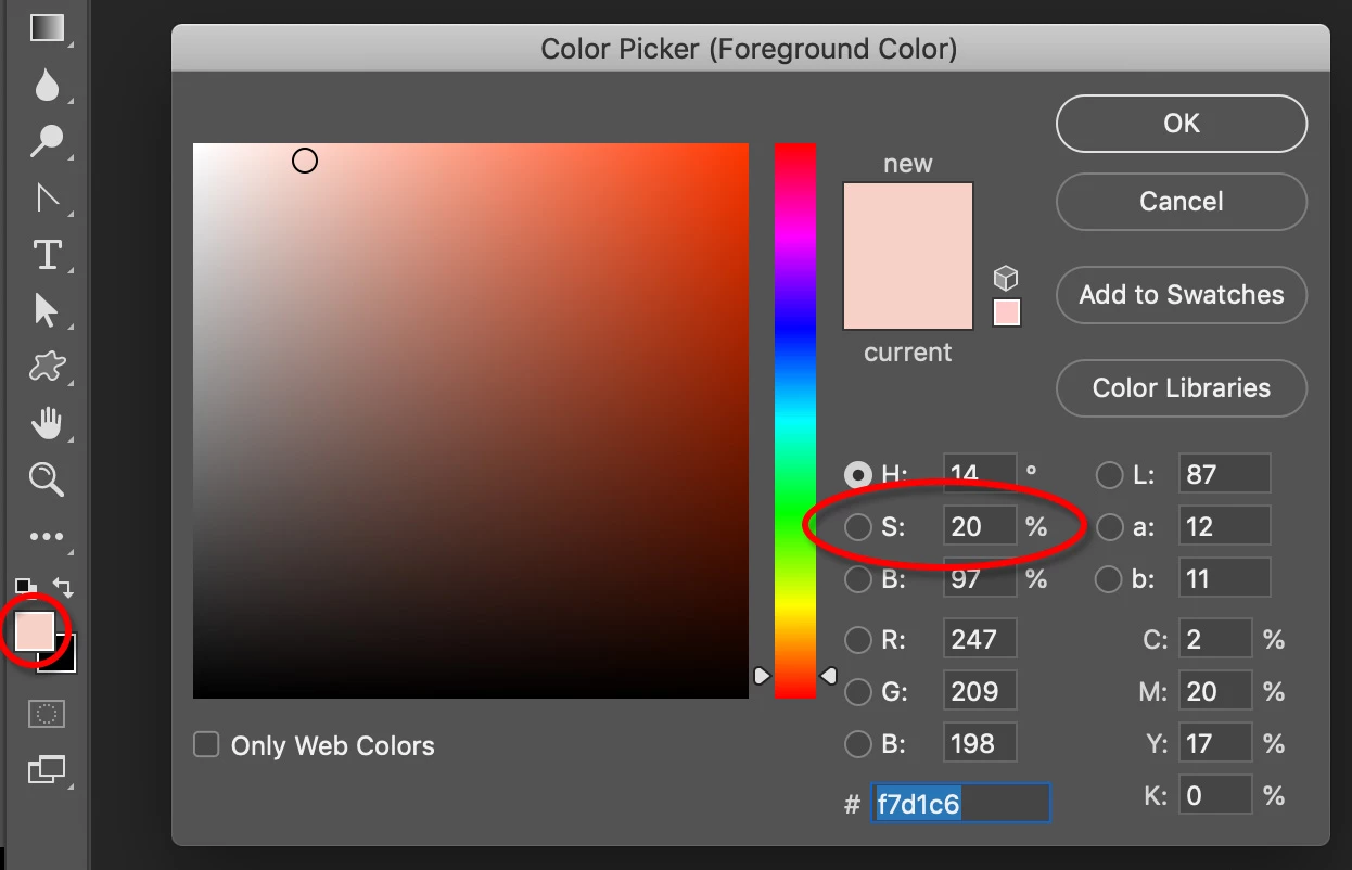

Here's a couple of things that may help in creating pastel colours.
Within the Swatches panel is a Pastel section that can be opened up.
When you open up a colour within the Color Picker keep an eye on the Saturation value. You can manually adjust this number and generally keep it low.
Jan 19, 2020 1:04 PM UTC
THanks Michael.
My colour library looks different - is this the same thing as the swatches panel that you are referring to?
Michael Bullo
Jan 19, 2020 1:10 PM UTC
Photoshop contains an actual Swatches panel that can be found under the Window menu. This panel recently got a dramatic upgrade in terms of both content and appearance. My screen grab was from Photoshop 2020. What version of Photoshop are you using?

On no account mess with your monitor settings to get things to look better. Because it means your monitor is out of step with all the other monitors, and will convince you your colours are right, when they are not...
