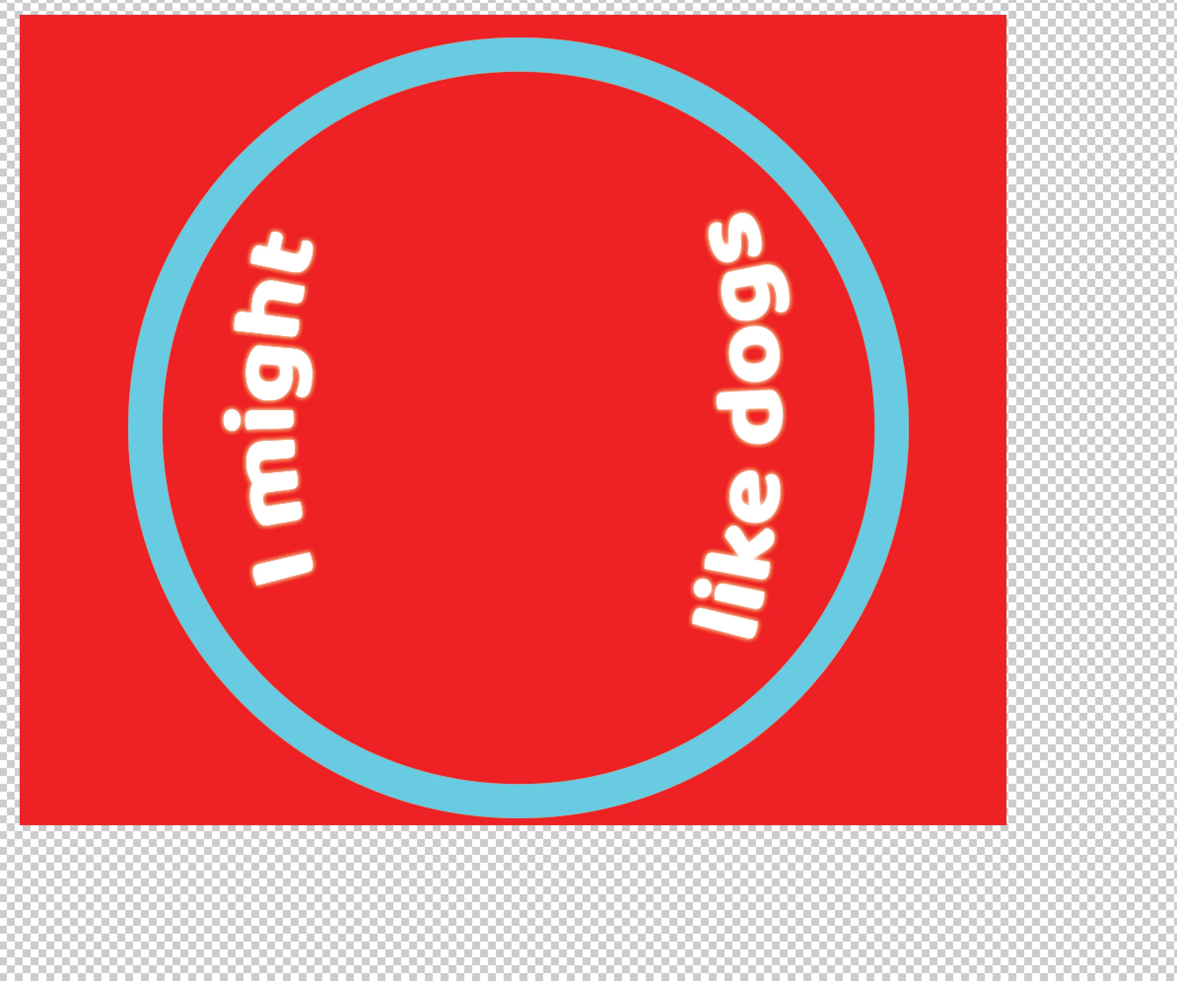

I have spent hours on Google trying to figure out a simple way to do this:
I want to remove the "I Might" and the "like dogs" from the red layer so that they are holes, as it were. Not white text (rasterized) but just an empty hole in the red layer.
How?
(there are 3 layers, 1 for each text and the red box)

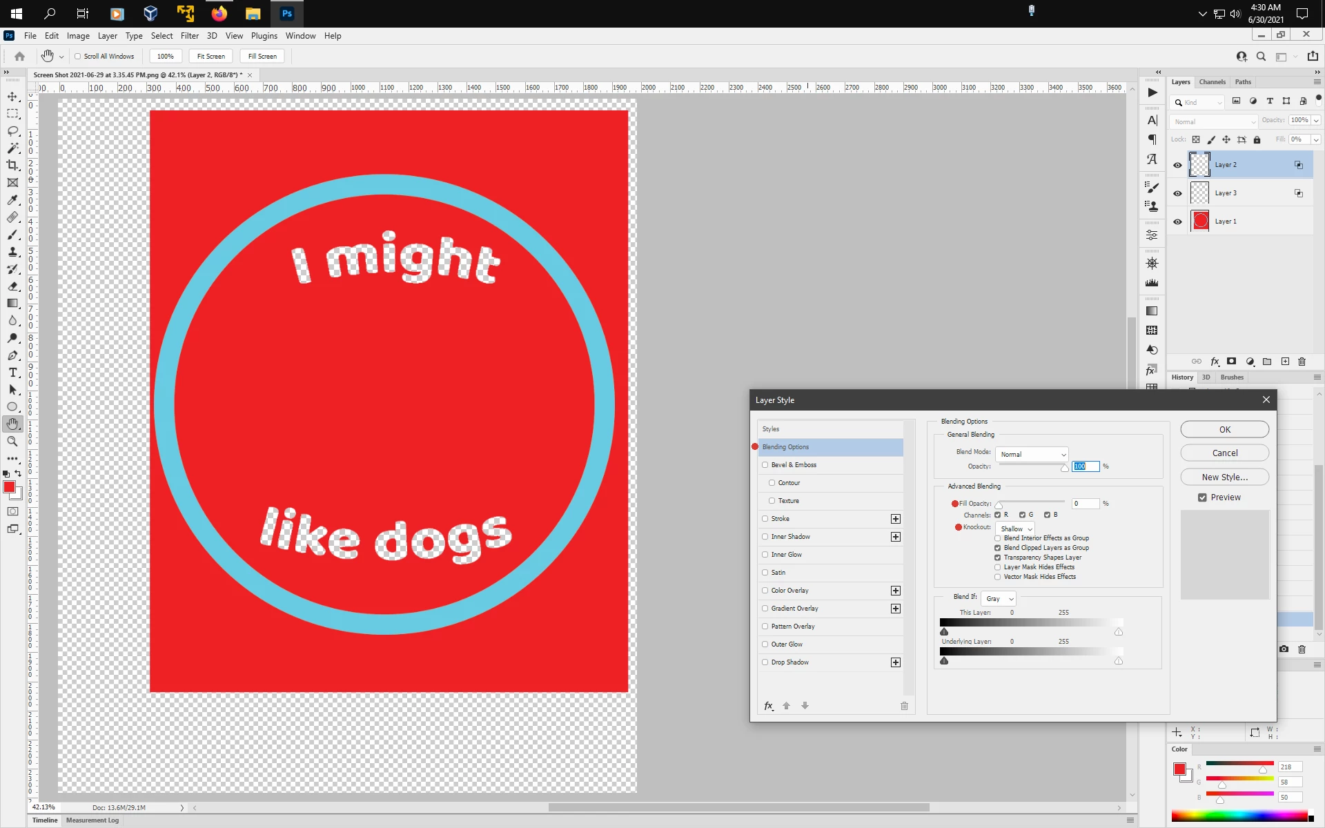

Jeff Arola
June 30, 2021
You could also use knockouts for your text layers.
On each text layer go to Layer>Layer Style>Blending Options and set the Knockout to Shallow and set the Fill Opcaity to 0 (zero).
December 22, 2023
This worked!! Thank you SO much. I have spent hours trying to figure out how to cut it out .
