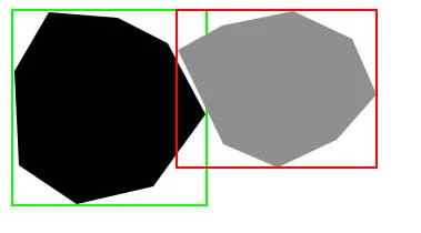

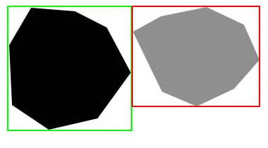

Following a co-worker's expression of "Show me, don't tell me", I've created 2 examples of the issue at hand.  Below are 2 images of the correct and incorrect result of what I'm trying to do based on bounds-based placement (incorrect) and transparent pixel detection placement (correct).  In the examples, the red and green boxes are there to represent the objects' bounds.
Desired outcome:
Bounds based outcome (incorrect for this project):
Note: The mock-up uses solid colors and hard-shapes, but the actual items being used are more detailed inside the shape with generally softer corners (by softer, I mean more rounded).
Anyway, due to interruptions at work I'm still setting up to try the methods suggested by csuebele and EnsilZah.  I'll let you know how those pan out, though I'm still open to other suggestions in the meantime.
Edit: figured I better clarify.  The overlap detection was requested due to their odd shapes, the actual placement is being handled by some code I've been working on; which can account for most, but not all object shapes.  For those that fall into the extra category, the overlap detection will tell me if I need to have the script nudge one layer away from the other a little bit.
