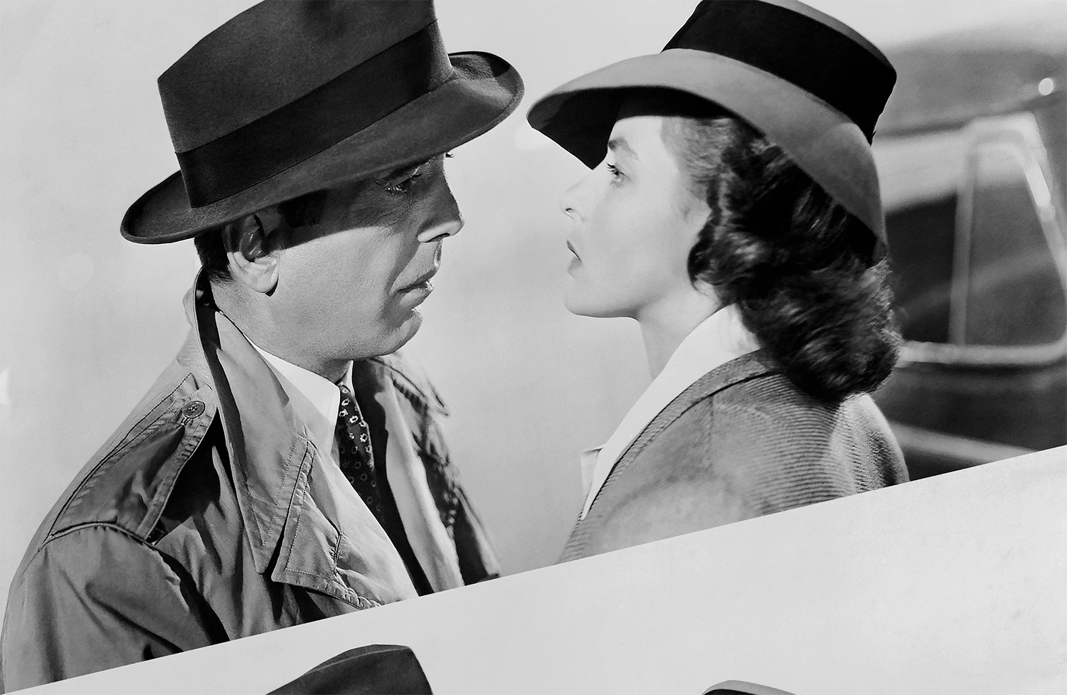

When I want to Transfrom/Distort a corner of a rectangle, the content of the rectangle doensn't stay in the same place. I mean, let's say as an example that I've a point right in the center, when I squeeze the lower right corner towards the upper right, the point MOVES towards the right side of the rectangle!! This makes some adjustments I need to do impossible to achieve. If I use Warp, I can't really mantain straight lines in the image because everything, well, warps… Carefully moving handles I could theoretically achieve the transformation I need but it's very hard and very prone to approximations that I can't tolerate and very slow to achieve and repeat. What I need is a way to compress a corner towards another corner without shifting the content of the rectangle towards the side of the corner I'm moving. All mantaining straight lines in the perpendicular sides and progressively compress them towards the corner where I'm moving the other one. It's hard, please follow the description and you'll understand.
Need help, I'm quite stuck!!
I've attached a very short little movie that shows exactly the unwanted behaviour. Look at the heads, they MOVE towards the right, this is what I don't want. I need to compress the right side without shifiting the content inside the rectangle towards the right side.

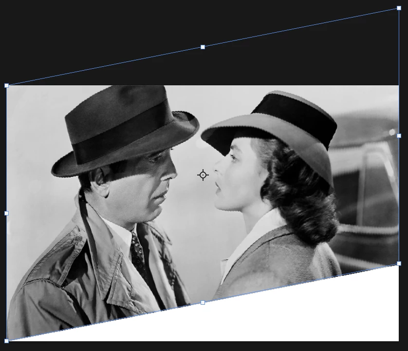

I thought this was working for a moment, but it is not compressing the right edge, just shifting it up.
Its the same result as Free Transform, but the out of bounds pixels wrap around from the bottom.

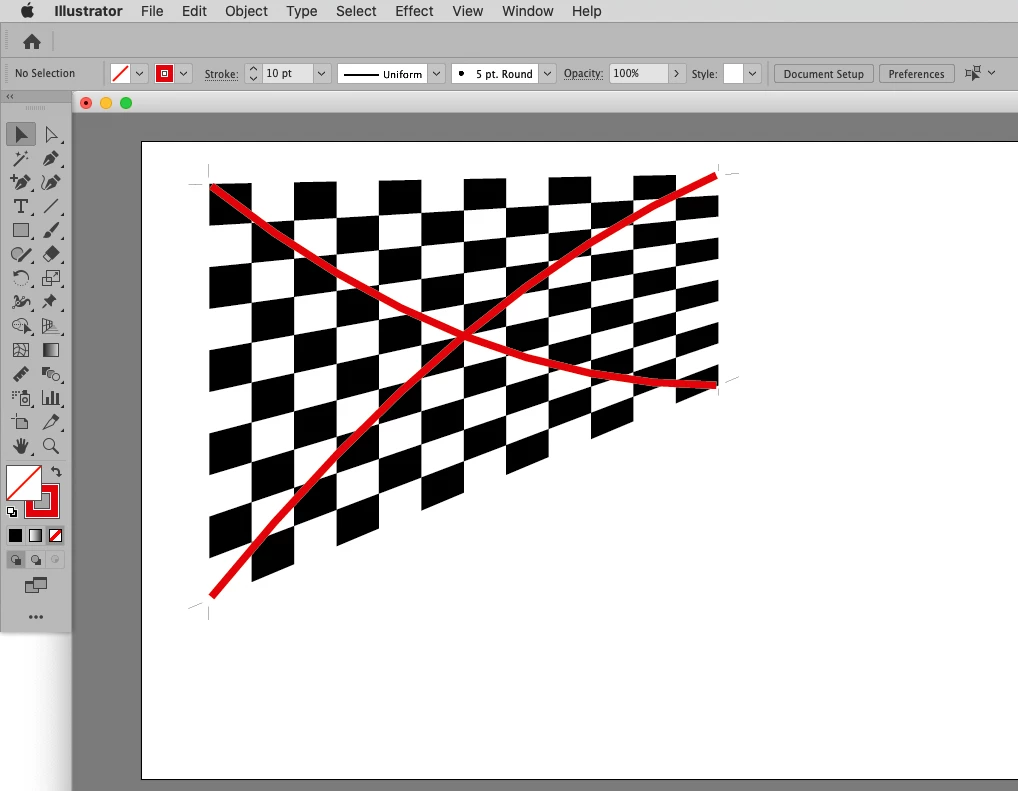

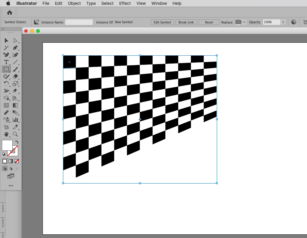

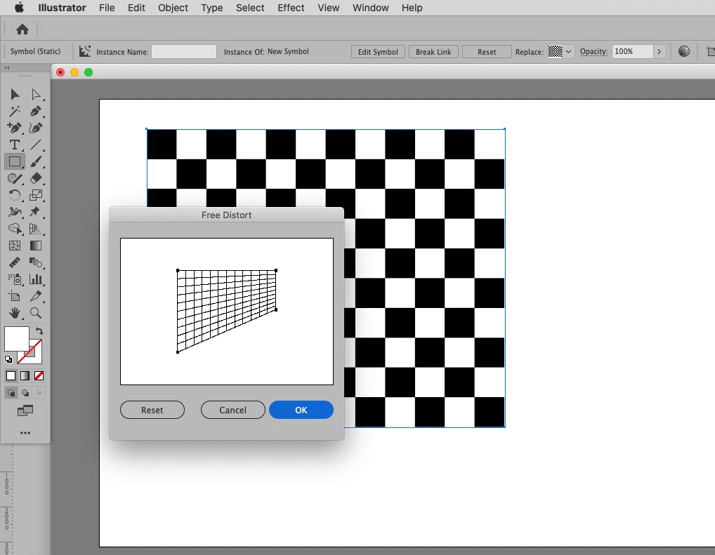

Illustrator’s Free Distort (edited) also seems to work the way you are referring to.
But just to make sure: You are aware that this bends the diagonals?
