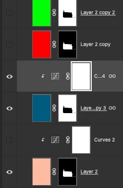

I'm sure there (should be) is a very simple solution here! Working on a project where I fill an entire layer, as you can see by the screengrab. Instead of having a million layers, I am changing the colors as I go.
I need to ID colors, hex #'s, that I select to fill these layers to write them down. How do I go about that?
Thanks!

Rather than filling a normal layer, use a solid colour fill layer. That way, you can just double click the fill layer in the layers panel which will open the colour picker so you can read the values.
In the meantime though, you can Alt click (option click on Mac) on the visibility icon (eye symbol) and it will show that layer in isolation which you can read with the eyedropper. Alt click again will turn the other layers back on.
Remember though, RGB values (or Hex codes which are just RGB values in base 16) are only relevant when stated with reference to a colour space. The same values will show different colours in different colour spaces (e.g. sRGB, Adobe RGB, ProPhoto etc)
Dave

I seem to recall a script to convert raster layers to solid fill layers of the same fill colour... I'll have a look in my archives.
I couldn't find the script, I think that I was confusing another script for a shape layer to a fill layer...
Anyway, it turns out that this is pretty easy to do with a conditional action to gracefully handle masked or unmasked source layers, so all is good!
https://www.dropbox.com/scl/fi/ol50tm0q5fr76qozm4u6z/Raster-Layer-to-Solid-Fill.atn?rlkey=9e53by5dxzmnfgmtgm2nayzt8&st=oyef0lui&dl=0

October 2, 2024
I will add, that as I change colors from each layer, the most recent layer's color is the one that shows up in the fill color palette. So I am unable to go back to another/different layer to see what the hex # is.
