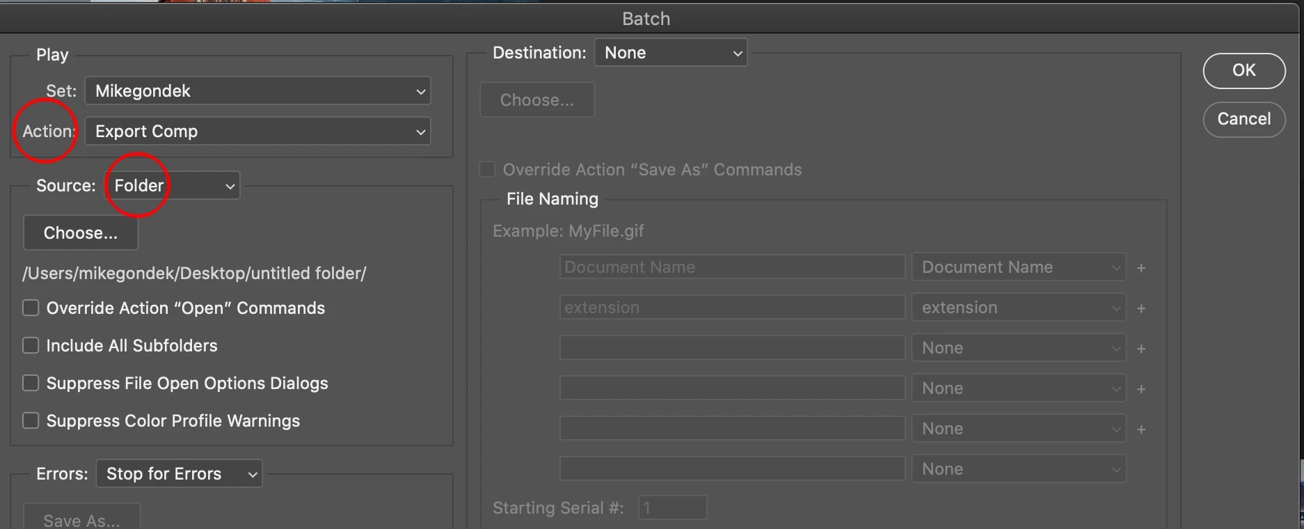

Mike_Gondek10189183
May 13, 2021
I successfully did using batch on 2 files. And an action with insert menu item. You may have to hit enter 70x.
Stephen Marsh
May 13, 2021
@Mike_Gondek10189183
That is similar to what I tested. I had to hit the OK button once per run of the modified script (twice if you count the alert finish message, which should be easy enough to disable in the comps script).
If the script can be called from within another script, that would be more workable.
Does anybody know if it is possible to call the Layer Comps to Files script from another script, bypassing the GUI? It can be done for the Load Layers into Stack, I'm just not sure on how to change the syntax...
