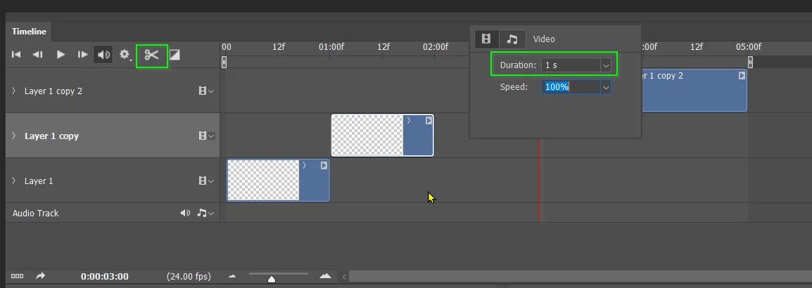

I'm sorry @desktop.surgeon . We didn't do a stand out job for you earlier.
OK, this is an empty video layer/clip five seconds long.
Set the Play Head to the start of the section you want to change, and hit the scissor icon.
Move to the end and cut again.
Right click the section you want to change and adjust its Duration
AFAIK, Photoshop does not have a Ripple Delete feature to trim the empty part of the timline, so you'll need to select everything after the shortened clip and reposition manually.

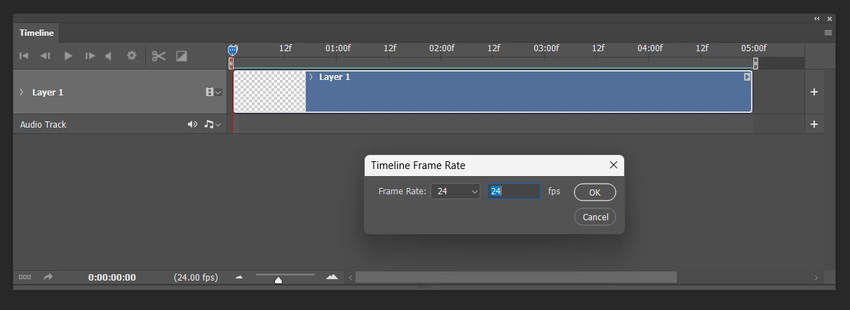

Jun 13, 2025 11:20 PM UTC
I have always found video editing confusing. While researching in attempts to help you, I found that duration is the first-to-last frame length, the length of the video clip.  Frame Rate is dependent on the type of output -- NTSC, 29.93 fps.
"When you create a new document, the default timeline duration is 10 seconds. The frame rate depends on the chosen document preset. For non-video presets (like International Paper), the default rate is 30 fps. For video presets, the rate is 25 fps for PAL and 29.97 for NTSC."
ref: Video and animation overview
Near the bottom of that webpage are the instructions --
1. From the Animation panel menu, choose Document Settings.
2. Enter or choose values for Duration and Frame Rate.
From the Timeline panel, try setting Timeline Frame Rate to Custom. Ps let me set it to 1,000 fps!
