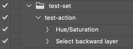

1) Take note of the adjustment layer settings and delete it.
2) Record a two-step action that changes the selected layer directly using hue/saturation or whatever you have done via the adjustment layer. The second step of this action will be to "Select backward layer", this step is recorded using the  opt/alt [  keys (hold down the option or alt key while pressing the opening left square bracket key). Stop recording the action, you'll have something like this:
Attention: It is expected that the selected layers are contiguous for the action to work as intended and that the selected layers are layers that can be edited with an adjustment.
3) Copy the following JavaScript code and use the instructions linked below to save and run the JavaScript script. You will need to know exactly how many layers there are to change and enter that number into the script prompt:

Without creating a script for your specific personal workflow, I will suggest the following:
