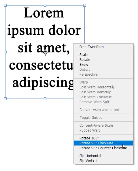

I am not sure if I am missing something here, but I am guessing you know you can right click and use the Rotate 90° options?

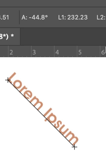

Also if you've already committed your text to a rotation without using a Smart Object, you can estimate the rotation value using the measurement tool and then rotating the opposite value back to 0.
