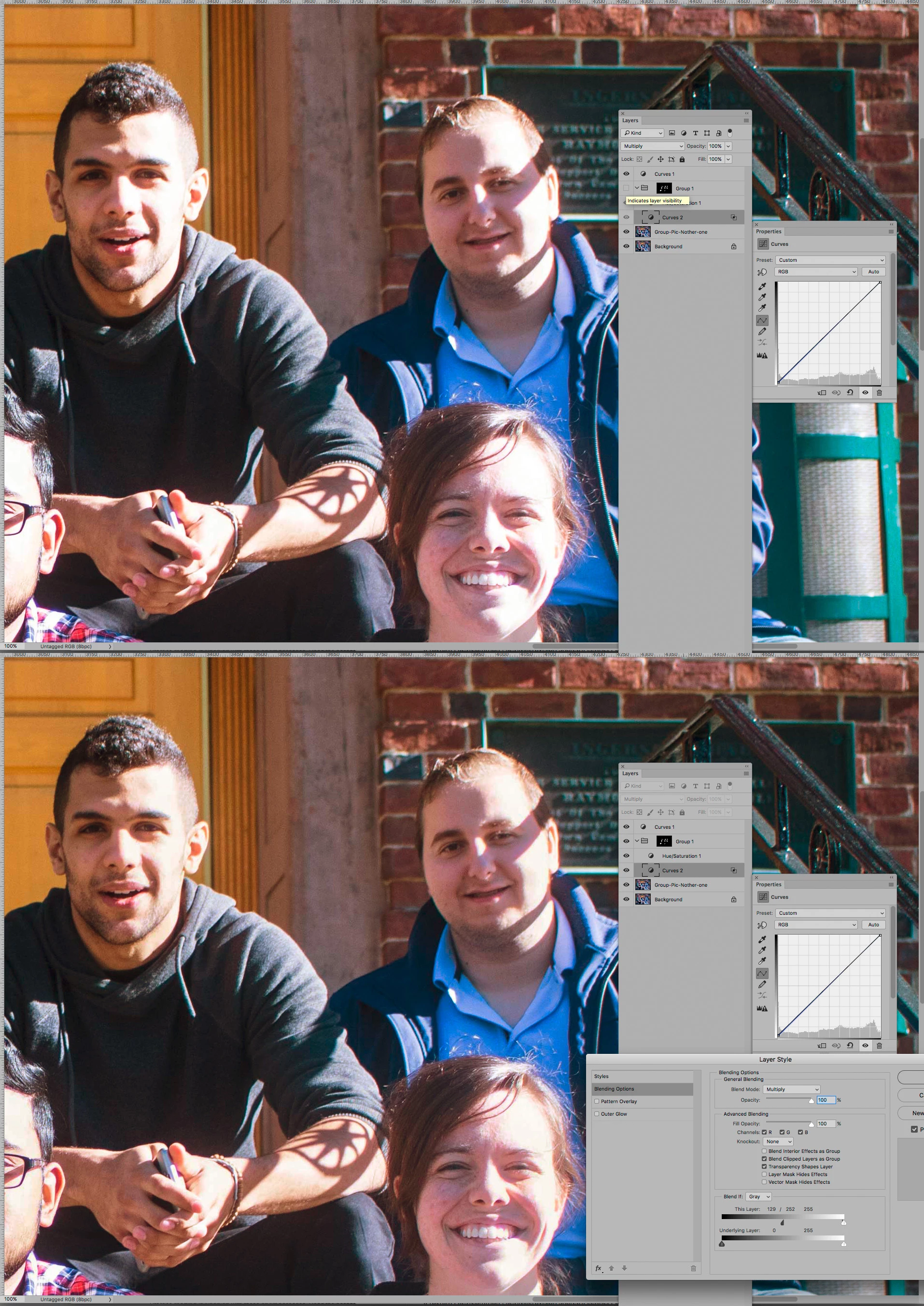

c.pfaffenbichler
June 21, 2017
1. Add a duplicate layer
2. Use Curves and its middle eyedropper (chose the vertical gray cement column on the far right) to correct the overall blue cast.
Using a Curves Adjustment Layer instead would seem prudent.
7. Change the Mode to Lab
8. Adjust local and total contrast via the Curves L channel of the transparent layer and then the Background Layer without affecting the color..
9. Return to RGB
I strongly discourage converting images, in particular 8bit images, repeatedly to different Colour Modes.
c.pfaffenbichler
June 20, 2017
Good day!
Do you have the Raw images?
Because there is precious little to work with in this jpg.
An Adjustment Layer set to Blend Mode Multiply and some Blend if settings might help a little.

c.pfaffenbichler
June 22, 2017
I do have the raw images,
Then you should try fixing the issue in Adobe Camera Raw as much as possible with global settings and then with the Adjustment Brush for example where necessary.
By opening the RAW files as Smart Objects you can combine maintained RAW editing capability with Photoshop Adjustments and some edits.
