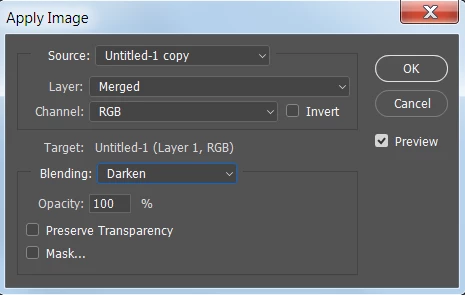

Go back to the original image. Image > Apply Image. Apply copy 1 using Darken mode.

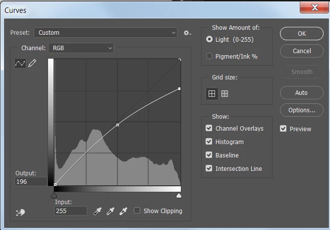

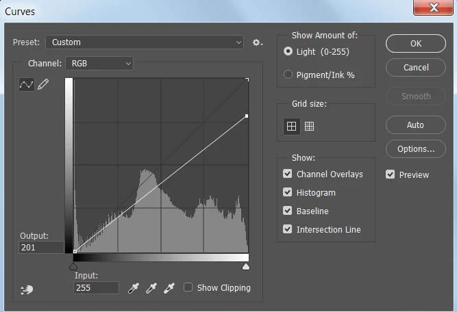

Now go to copy 2, and use a Curve to darken the highlights.

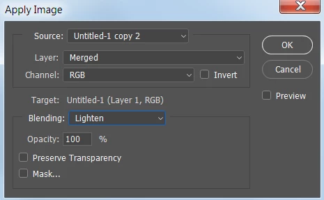

Go back to the original image. Image > Apply Image. Apply copy 2 in Lighten mode.

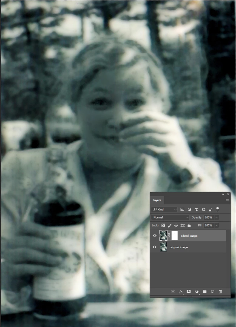

With the original on the bottom layer and the edited version on top, you could add a layer mask and hide areas like the eyes to bring back some sharpness.

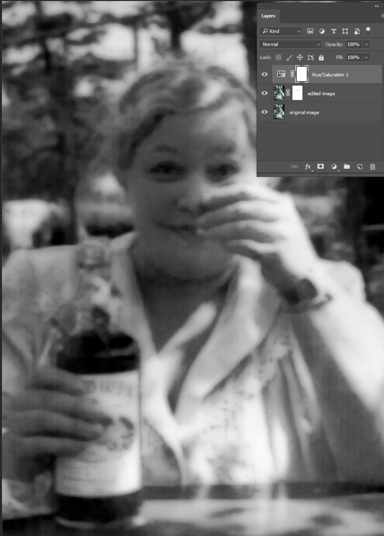

You would end up with something like this:
Desaturating the image would help.
