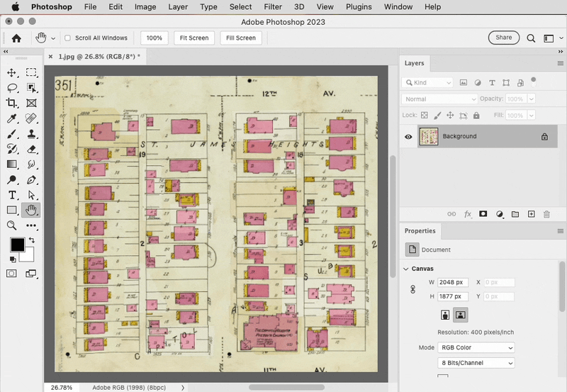

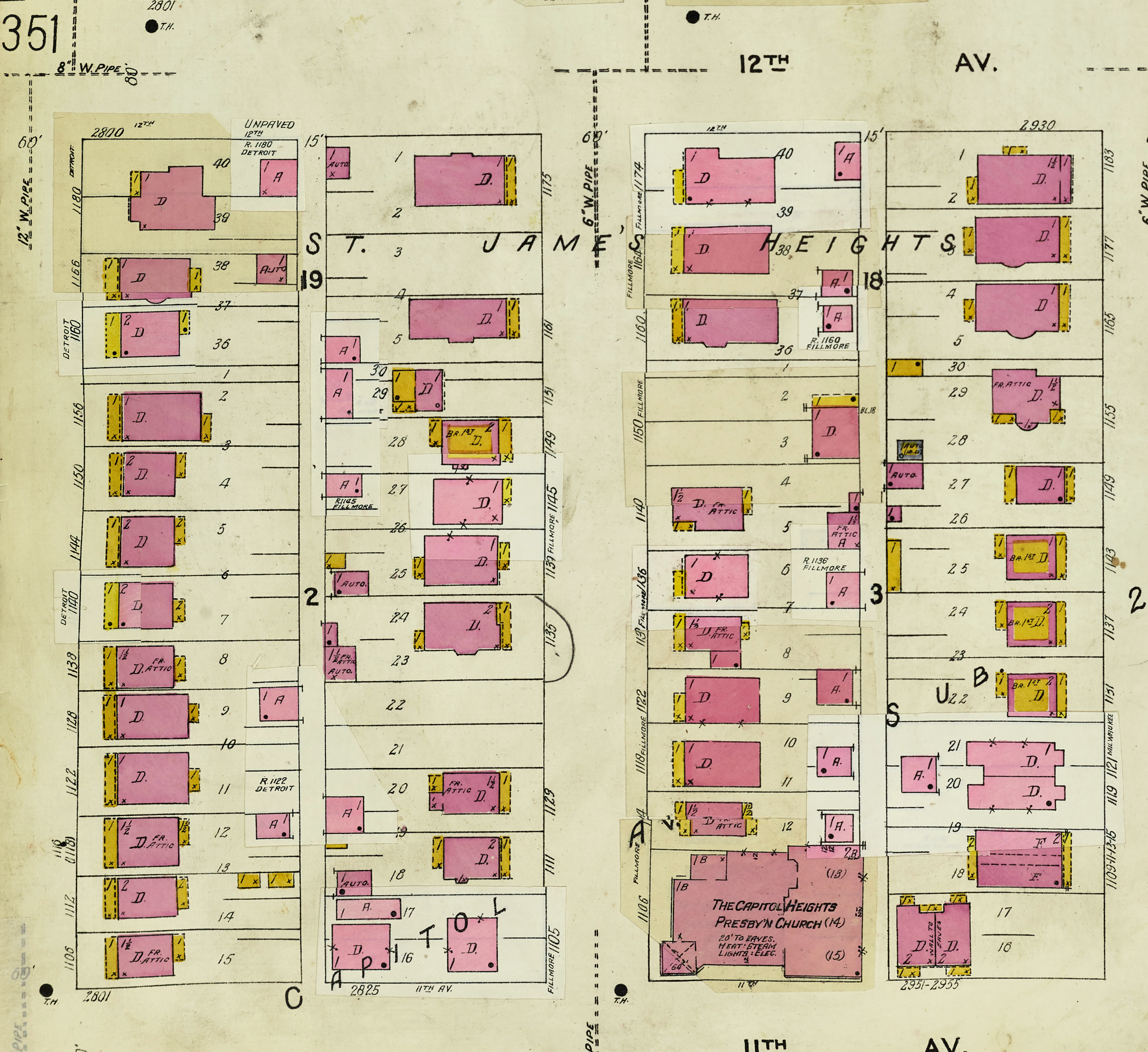

I need to remove yellow color from a photo because it's too saturated. How should I do?

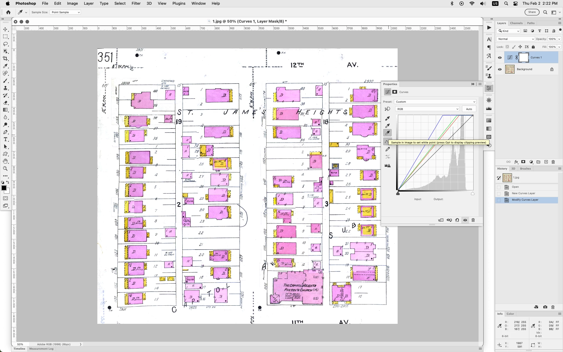

    Something else you try is to use a Curves or Levels Adjustment Layer and use the White Point eyedropper to click on the darkest yellow color.
    February 2, 2023

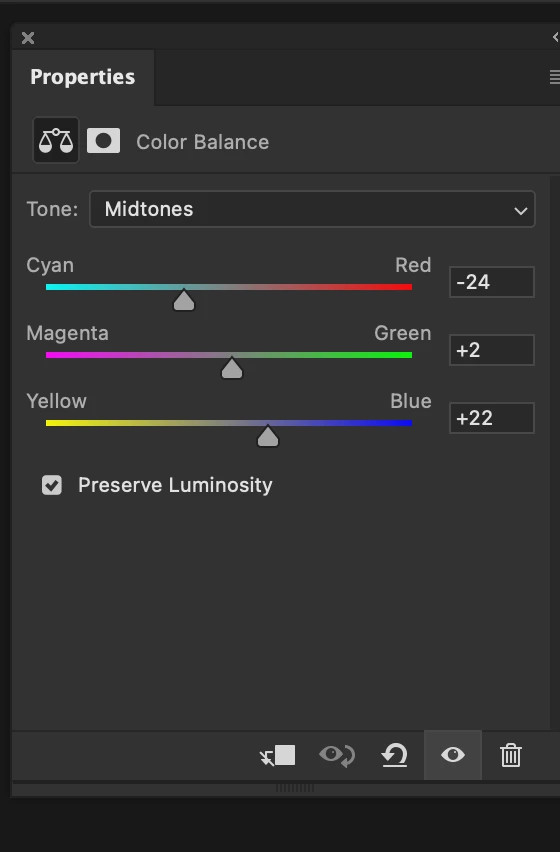

    A colour balance Adjustment Layer increasing the blues usualy works:

    I didn't scan it . . . it was done by the Denver Public Library. They did a previous scan for me and also printed it and it was great. Unfortunately, they stop their printing services,
    February 2, 2023
    My photo of the page was much less yellow.
