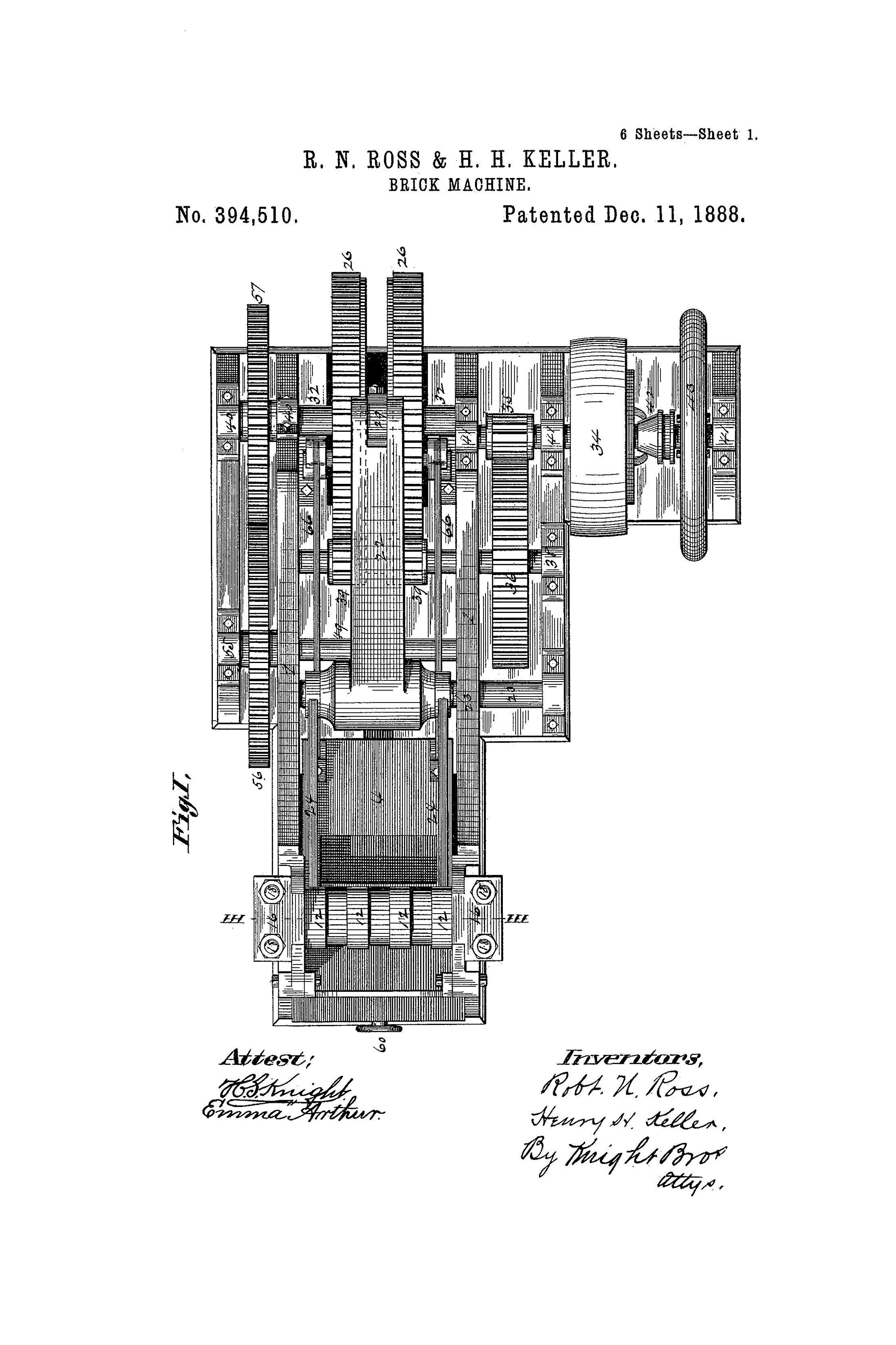

I have some black and white photos where the subject is all black and the background is all white. I would like to replace the white background with some other images I have of the same size. As an example, I would like to replace the white background of this image with this chalk background.

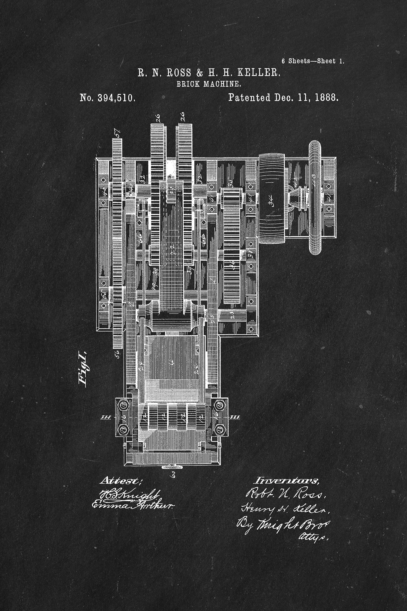

This is how it is supposed to look:
Unfortunately, the person who made this last image can no longer do so for the rest.
I have tried using   Select > Color Range   to make a layer mask only out of the white color which somewhat works, but it turns quite grey and isn't as sharp.

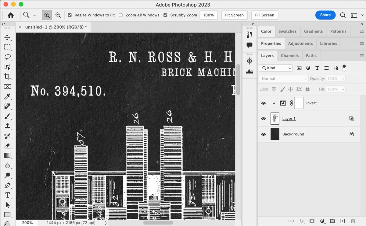

How close is this? It doesn’t use a mask, instead:
  • The drawing is inverted using a clipped Invert adjustment layer so that it becomes white on black.
  • Because the drawing background is more or less a small range of tones, the drawing layer is double-clicked to open the Layer Style dialog box, then the BlendIf control is set to drop out the background tonal range, revealing the chalk layer.
I’m not saying this might be the best way, but it was a quick way.
