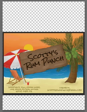

I'm doing a bottle label for a friend who wants to start selling his homemade rum punch. We agreed on a basic design and when I asked him for the dimensions, he said he wanted 3 x 4 inches. The original design that we agreed on was lengthwise (or rather, 3 inches height, 4 inches width). As I was working on it, I was sending him progress photos.
However now I'm nearly done and I sent it to him, he said that he had actually wanted it to be a tall rectangle standing up, instead of lying down on the side. He wants it to be 4 inches height by 3 inches. However he never mentioned this during the drawing process, and we had initially agreed on the other format, which I then proceeded to follow. This is the image that I did.
So basically, he wants the design to now be 4 inches in height, with 3 inches width. Is there any way that i can resize the image without losing a lot of the work I did? I know that at the top and bottom there will be some white space, so I don't mind colouring back in those areas, but I'm more worried about the items on the beach, like the tree, umbrella and chair.
I figure if anything I'll have to put the chair next to the tree, and i'll lose half the beach. The plank of wood with the name is on a separate layer (I've put everything on separate layers) so I'm not worried about resizing that.
Thanks in advance.

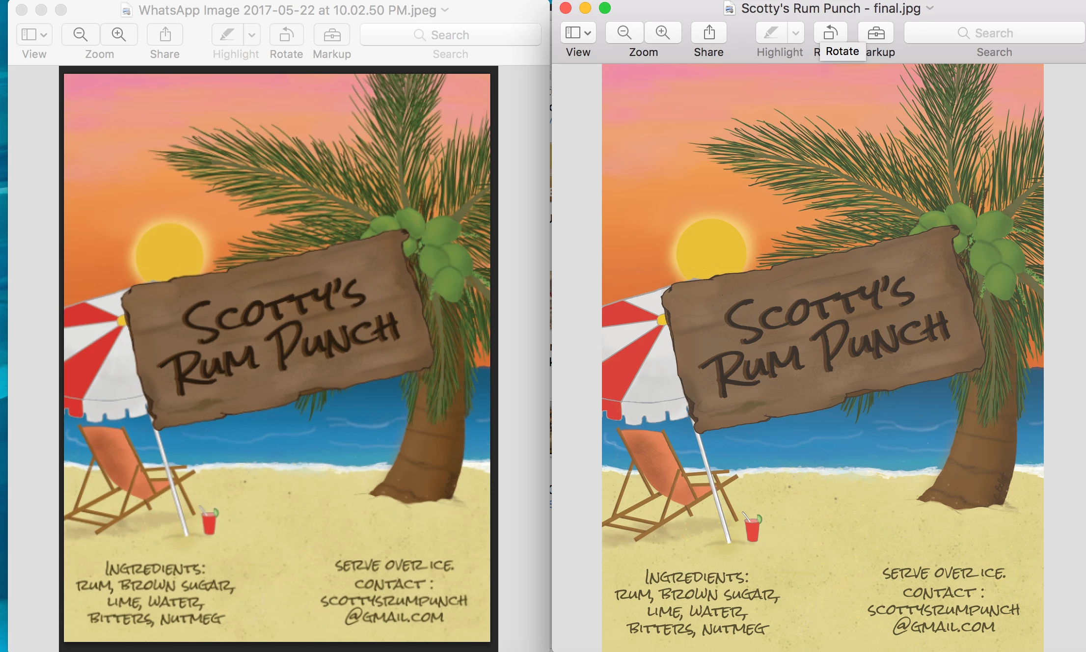

I was able to resize and finish the label, and my friend is happy with it, however when I went to save it to send to him, that's where the problem started. The print shop told him to use an image with 300 DPI, PNG format and in CMYK mode as it will be printed and made into stickers. So naturally I followed these guildelines However Photoshop isn't letting me save it as a PNG format (I googled this and found out it's because it's in CMYK mode..forgive me, I'm still learning ) but I was able to save it as a TIFF and a JPEG file. When i went to send it to him, I saw that the colours are now kind of gray and not as bright as they are in the original file. I've put screenshots of the two as a comparison below. The left side is what the colours should be:
Could someone tell me what went wrong and more importantly how to fix it? I'm intermediate when it comes to Photoshop, but I'm still learning about the different modes. Thank you in advance!!

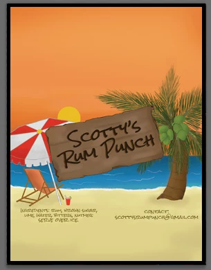

Content Aware Scale is the tool for this.  I did this without anything Protected, but you can select and save areas you don't want to be distorted.
Start with the crop tool set to ratio, and type in a 3 and a 4, and stretch the canvas to the required aspect ratio.
Then Select all, and use Edit > Content Aware Scale.

If you crop you will lose some content however there will be no distortion.  If you use content aware resize there will be distortion.  So try both methods and see which one you prefer for this image.
If every item is one its own layer you can change the canvas and transform each layer as needed. Scale and position for the composition you want.
