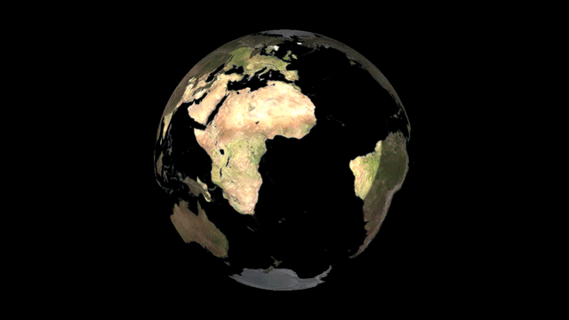

    Rotate 3d layers in a video timeline. http://www.mouseprints.net/old/dpr/Insidelight.mp4
    For a warking  animation, Create a Frame animation and a layer for each frame.  Try duping a layer and using puppet warp to move/change your characters body movement.,
