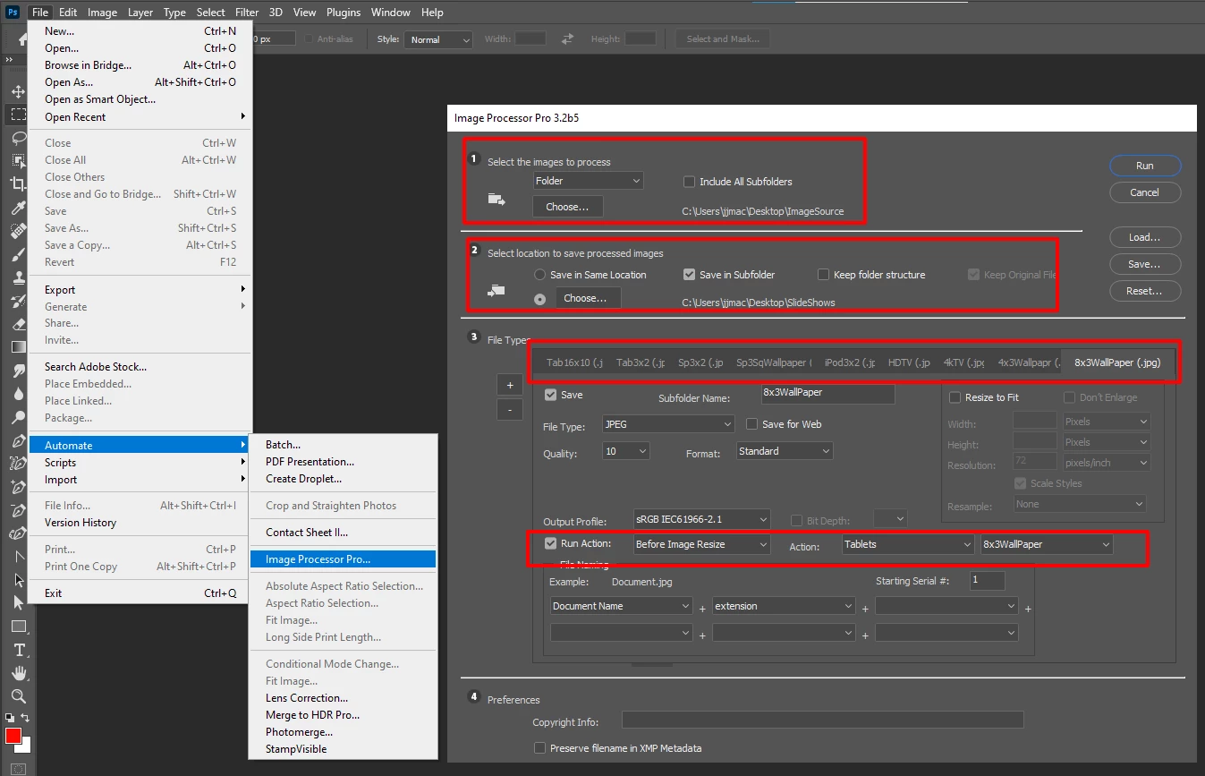

JJMack
October 27, 2021
Download and install Image Processor Pro... Plug-in Script.  It sounds like that is what you are after.
Up to 10 output files can be created for each image file processed an you can include a different action  to be used to help products each of  set of output files.
JJMack
