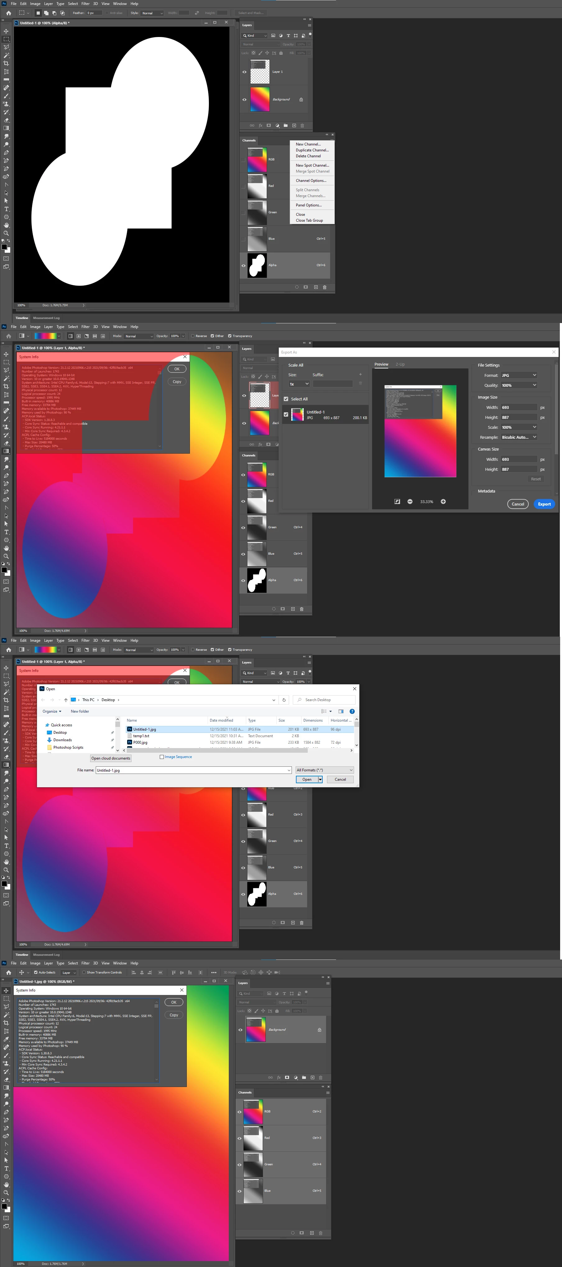

How to save an alpha channel as jpg?
For several years, I saved and used "alpha channel" as an "export" function.
It was useful because various colors of "channel" were merged and stored at once.
Since the recent update, 'Export' has no longer been able to retrieve 'Alpha Channel'.
Only 'layer' is retrieved from 'Export', so an empty screen is saved. Is there a solution?
I've tried reinstalling it to the previous version, but it's not solved.
Steve5D7CCorrect answer

TheDigitalDog
Dec 15, 2021 6:48 PM UTC
Totally doable. But some steps needed:
Make the Alpha channel, in the Layers palette, use the "Split Channles" command, save the Alpha that results from the others as you desire.
You may wish to duplicate the document first, then split and discard all the other channels, while keeping the original intact.
The other way would be to make a selection and use Save Selection, >New document, in the dialog, then save it.

PECourtejoie
Dec 21, 2021 9:46 AM UTC
@TheDigitalDog indeed, but nothing prevents you to export them using the new export as. I'm really puzzled by the request, and how @지숙22258186n5dk does export his alpha channels with the old Export As.
D Fosse
Dec 15, 2021 6:41 PM UTC
AFAIK direct Export of alpha channels has never been possible. Might make for a good feature request.
What I've always done is target the channel and copy/paste into a new document.
Pay attention to your grayscale profiles! A single channel is effectively an untagged grayscale file, represented in your working gray. For consistency and some degree of predictability, you should probably set your working gray to Gray Gamma 2.2, or at any rate a gray space that has the same tone response curve as your document RGB.
JJMack
Dec 15, 2021 3:42 PM UTC
How did you save a channels as an image file? I used Phoroshop 2020 here and could not find a way to export an Alpha channels as a jpeg or export a Document as a Jpeg and have the saves Jpeg have a an exported Alpha channel.

PECourtejoie
Dec 15, 2021 9:00 AM UTC
Hi, I would suggest to try Edit/Preferences/Export and select "use legacy export as"
PECourtejoie
Dec 15, 2021 3:34 PM UTC
Mmh, I just tried, and I do not see an option to export the Channels in Legacy either...
Could you elaborate on how you were doing it?
