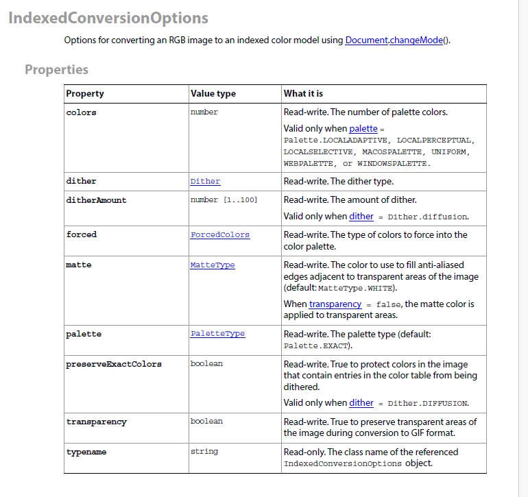

 The error right now is they want conversion options but I'm lost. Is there a way to say default?
Correct answer Lumigraphics
I've seen this I was just unsure how to format the relevant information and pass it through the method
Specify properties with a name:value pair in brackets as below.
srcDoc.changeMode(ChangeMode.INDEXEDCOLOR, {colors:256, palette:Palette.EXACT, transparency:false})
