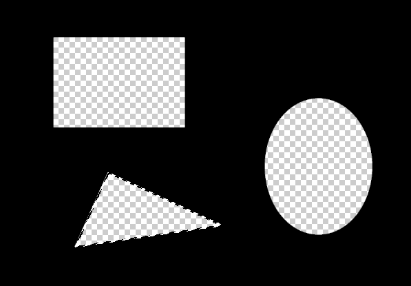

How to select transparency with a script?
I'm trying to write a script that will select a contiguous section of fully transparent canvas, but not all transparency. How can I do this?
If it helps, it's fine to assume that there are no pixels with partial transparency, so ignoring anti-aliasing or selection tolerance is okay. It's also okay to pick the contiguous section arbitrarily.

@gregd - How would the script know which of the three transparent areas should be selected? You mentioned arbitrary selection, so using a "random" operator?
As far as I know, multiple selections are just a single selection in scripting, at least in ExtendScript, I don't know about in UXP.
A selection can be converted to a path, with various degrees of accuracy. Unlike selections, paths are separate items that can be programmatically isolated from the overall collection.
So, I can envisage a script that loads all transparency as a selection, converts the selection to paths, which could then be used to individually isolate or select the pixels from the underlying area, based on the "approximate" path coordinates, but using the accuracy and fidelity of the pixels identified by the paths.
https://community.adobe.com/t5/photoshop-ecosystem-discussions/how-do-i-seperate-subjects-into-different-seperate-files-automatically/m-p/14449644#M782171
@gregd - This is what I was suggesting in my previous post:
Random Selection from Transparent Layer.jsx
Stephen Marsh
v1.0 - 31st August 2025: Initial release
https://community.adobe.com/t5/photoshop-ecosystem-discussions/how-to-select-transparency-with-a-script/td-p/15481286
Based in part on:
https://community.adobe.com/t5/photoshop-ecosystem-discussions/how-do-i-seperate-subjects-into-different-seperate-files-automatically/td-p/14449644

Stephen Marsh
Aug 29, 2025 1:32 AM UTC
quote
By @gregd
Is the area to be targeted always in the same X & Y pixel location that a scripted magic wand could be used?
gregd
gregdAuthor
Aug 29, 2025 3:46 AM UTC
No, I need to be able to search the document for the transparent areas.
Stephen Marsh
Aug 29, 2025 7:03 AM UTC
Search or just load all transparency? These are different things.
Presuming that the active layer contains transparency:
loadLayerTrans();
function loadLayerTrans() {
        var idset = stringIDToTypeID("set");
        var desc323 = new ActionDescriptor();
        var idnull = stringIDToTypeID("null");
        var ref75 = new ActionReference();
        var idchannel = stringIDToTypeID("channel");
        var idselection = stringIDToTypeID("selection");
        ref75.putProperty(idchannel, idselection);
        desc323.putReference(idnull, ref75);
        var idto = stringIDToTypeID("to");
        var ref76 = new ActionReference();
        var idtransparencyEnum = stringIDToTypeID("transparencyEnum");
        ref76.putEnumerated(idchannel, idchannel, idtransparencyEnum);
        desc323.putReference(idto, ref76);
        executeAction(idset, desc323, DialogModes.NO);
